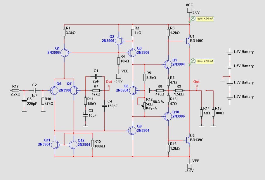

It works down to +/-2.0V.
Distortion is low and current consumption is only like 3-4mA depending on the status of the batteries.
Has been tested in simulation with 32ohm and 300ohm load.
I challenge everybody to try to design a real lowpower headphone amp for +/-2.0V.
Post your schematic here.

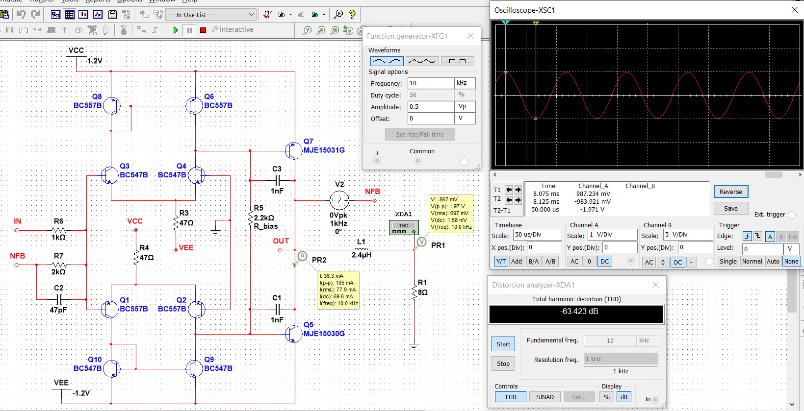

My old abandoned thread. The tricky part is to bias it in class B.
Output swing: +-1V
Output current: >500mA
I was amazed my 5 inches shelf speaker can play pretty loud with just 2 AA battery.
This kind of out put stage seems to work pretty well with full swing of power supplier. I am thinking about to up scale it to larger power.
PS: It is able to work in Class B, with extremely low distortion.

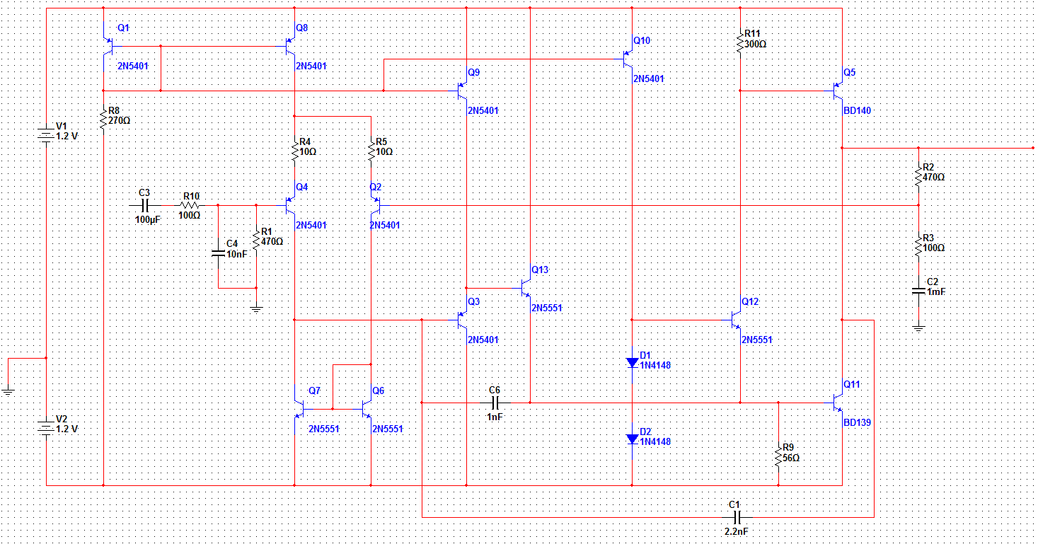

@lineup , thank you. However, I don't really the circuit. I built 4, and hooked them in btl for 2 channels just for the prove of concept.
Here is another design, not from me. It could work in very low voltage too.
The long tail from LTP can be swapped out with a trimmable current source for bias stability.

do we need the bd transistors at such low supply voltages?It works down to +/-2.0V.
