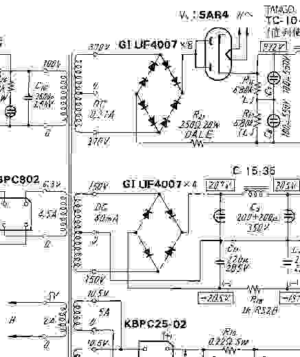

I propose* to insert a 5R4GBW diode in series after a bridge rectifier.
The line in which the diode is to be inserted is at a potential of +1200V approx (rectified from an 800Vac secondary winding). As you may know the cathode is directly heated by 5 volts ac/dc.
I will be using another 5V winding to supply the filament. This winding will then float at 1200Vdc. My concern is this; will the internal insulation of the transformer be able to cope? Does anyone have experience on the subject??
*FYI I want to use the warm-up time of the 5R4.. to act as a delay mechanism before HT is applied to the amplifying triode plates.
JB

Most 5V indirectly heated rectifiers have the cathode tied to one of the filament lines in, like the 5AR4, 5V4G, etc. so you can't have that situation. Also, most filament transformers are rated at 2000 VRMS insulation... even the Hammonds meet this spec. What current range are you requiring for the B+?
Regards, KM
I was just looking at the 5AR4 data-sheet online, and that is shown as strapped internally.
So it would appear that this is common practice.
But it does seem to violate safety, by bringing high dc voltages back into the transformer? Which was the basis of my concern when I started to wire things up to include the diode .
PS
I expect the 845s to draw about 120 ma each so total 240ma, max fused at 200ma per channel just in case I lose bias
Attached retry

It says +900VDC cathode to heater, +5KV on peaks. Using a separate heater transformer, bias the heater winding around +400VDC with 3.3 meg or so resistors. Or a voltage divider hooked to the 1.2KV B+, something like 1 meg to ground, 2.2 meg to B+, the mid point to the heater. This would also help drain off residual charge off the filter caps after you switch the power off. A safety feature. Use 1 watt resistors.

Again, typical Plate/Filament transformers (and single filament transformers) are rated at 2000VRMS (multiply by 2.8 for DC) so having the filament winding hanging at 1200- 1500VDC is fine.
I would be inclined to use either a 5AR4 or back to the original 5R4GY with a separate filament transformer. In the case of a 5R4GY, use a simple 555 timer driving a relay for the required delay for turn-on.

FYI The 555 timer was where I started.. The timer circuit looked a bit complex and flimsy to me, with relay contacts in the 1200V and 400v supply lines. My thought was to replace both with the diodes using the heater warm-up as the delay. Now it seems the warm-up delay won't be long enough.
So do you think I could put a 555 driven relay in the Diode filaments
path?? That way I keep well away from the high voltages.
The idea of a separate filament Trans. makes a lot of sense and I'll certainly do that together with the resistor bias ladder.
