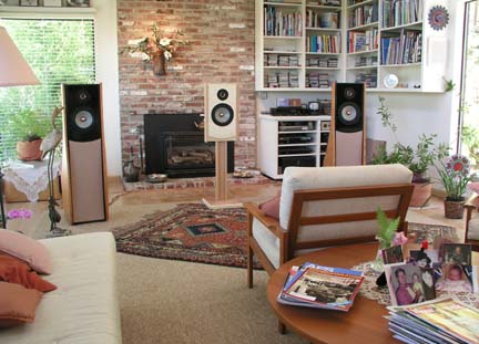

My center speaker prototype uses ORION midrange and tweeter channel electronics, except that the 120 Hz highpass filters and midrange delay circuits are bypassed. The DPR 1001 is set up for a "Small" center speaker. The cabinet dimensions follow the drawings in the ORION documentation, except that the dress panel is lengthened for cosmetic reasons. I decided not to build a fully finished unit before finding out whether I would keep a center speaker.
The question should be addressed as to how you plan to derive / synthesize the centre channel information. Note that the original date of the sketch included in the full article is 2004 - it's probably fair to say that the past decade or so worth of "value engineering" in the DSP capabilities of mainstream HT receivers has made type of system easier than ever to assemble. While of course a $500 7.1 (or more) multichannel receiver will have far more features & functions than a audio only system would require, there's a lot to be said for the convenience of a single component for the signal processing and power for all but the mono LEF/sub woofer channel.
Edit: I think it's also notable that he chose to use the same drivers for the centre as L&R mains - no doubt in the interest of maintaining what he describes as almost seamless blending of tonal balance. He did also of course state
At this point I am not convinced that a center speaker in my system is worth it, even if it is placed out of sight most of the time. Sitting in front of such speaker is visually highly distractive and its benefit for multi-channel sound is marginal, given the satisfying sound stage that is set up by the ORION.
