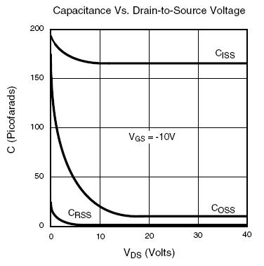

This design seems to have three basic options:
1. Use resistor for biasing.
2. Use CCS with meager 4.5V drop across it.
3. Use CCS with 20-30V negative rail.
Capacitance of the DN2540 seems to run about 12pF at 20V, while at 5V it is much higher, near 50pF. So it would seem better performance is had with the negative rail (I'm being a little lazy here: don't want to install one).
I guess I'm interested in the sonic improvements moving from option 1 to option 3. What would you do ?

Don't be afraid to cascode if you've got a negative rail. And don't do a diff amp unless you either have a negative rail or are willing to put in the extra RC coupling it will take to float the stage up a few dozen volts.

If the stage before it has differential output, you won't get a big benefit from the CCS. The negative rail is nice in that you can have grids at 0 volts and less capacitors, but the floating grids works well too like SY mentioned. Running at at 4-5 volts isn't recommended. Pic attached for others (I'm sure you saw or know this zigzagflux and SY😀 )

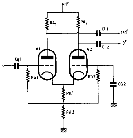

If you have a transformer input, the best bet is just to go with a resistor tail instead of the CCS, and each leg of the transformer goes to a grid, and CT to ground. A CCS is used to enforce AC balanced voltage across the plate loads (when the loads are equal) where there is unbalanced AC input on the grids. Your transformer will already balanced, so the ccs will probably be unnecessary.
The attached pic is an example of a long-tail schmidt splitter where the grids are floating. (Also unnecessary in your case now)
Website where pic came from: http://www.bonavolta.ch/hobby/en/audio/split.htm

Really ?!
I can't argue with the simplicity of a resistor, but doesn't the CCS aid in differences between triodes, CMRR, PSRR, and probably a few other things besides input balance?
Granted, I will have a shunt regulated 0D3 supply, so power supply ripple will be negligible, but something in my brain is not connecting with your statement.
