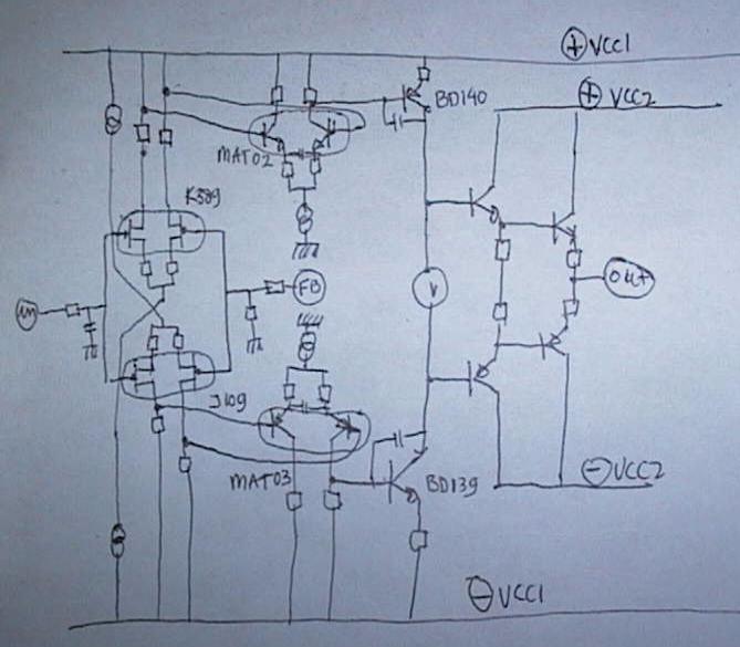

I got this schematic from an expensive power amp.
There are things I don't understand. It uses 2 differential, the K389 and J109 connecting to input and feed back, then it is re-differentiated by MAT02 and MAT03. The MAT's are not VAS, the VAS are BD139 and BD140.
What is the merit of doing differential-ing a differential? (K389+J109 to MAT02+MAT03) ?

It is just another stage of gain. It isn't really necessary, and will probably cause problems with stability.
It's anybody's guess...here are some possibilities:
1) Current drive to the BD139/140 is insufficient without an extra stage. The extra stage needn't be a diff pair but might as well be as it helps with 2)
2) JFETs are not very linear. The second diff pair produces a more linear differential current for the BD139/140.
3) JFET Vds rating is not high enough for the power rails. The second stage allows you to set a much lower drain voltage.
4) JFET power dissipation. Same point as 3) but regarding power.
5) To reduce common-mode distortion. If the pos and neg JFETs are not perfectly balanced in terms of sensitivity of drain current to Vdg or Vds change you could end up modulating the bias current through the output stage. This is because of pos and neg asymmetry of the devices.
I'm sure there are more.

Like John said there no point to adding another gain stage here.
Maybe, this would be ok it you were running a balanced configuration and needed very high command mode rejection. However, that can be accomplished with precision parts in the first stage.

some confusion in terminology here, "differential pair", "differential stage" refer to taking the algebraic difference of 2 inputs and providing a proportional output voltage/current
"differentiate" means to provide an output proportional to the rate of change of the input
the example circuit does both! the MAT pairs are "differentiating differential pairs" which have an output proportional to the rate of change of the difference of the two input signals
the caps across the MAT emitters provide a zero that results in a differentiated ouput over a range of frequency, depending on R,C and gm values this region of "differential"(=differentiating or derivative) gain could cancel the roll off of the integrating miller compensation of the following stage over some frequency range - some designers feel that the open loop gain should be constant over the audio frequency range so that the feedback factor is constant for all audio frequencies
a really interesting possibility is that it could be part of the high frequency compensation, implementing a "Bode Step" - not something i recall seeing in audio amplifier circuits
or the zero-pole pair could both be below the audio frequency range and simply part of some DC bias scheme

Quite possibly an example of the "Not invented here" syndrome. The design team just couldn't bear to use an approach that someone else had already developed. The rest of the amp looks very conventional and searching this forum you can find numerous versions of mirrored long-tailed pair input stages that do what needs to be done without gatting clever.
First, Happy New Year to everyone.
Sorry about the drawing, I should draw the connection to MAT02 is from the Drains of K389 below the resistors, not from upper resistors, that is wrong.
The Caps in the emitors of MAT's are only 1nF. All the degeneration resistors (in emitors and sources) are 100ohm.
The VCC1 is 45V, the VCC2 is 35V. The miller cap is 15pF, the current in first differential is 7mA, the second differential is 12mA, the VAS is 35mA (attached in heatsink).
I read that a differential pair do cancel distortion (like left+right K389). Is the same "Distortion Canceling Mechanism" also happened in "up and low" transistors, like left K389 to left J109?
If the "up and low" transistors also cancels distortion, wouldn't it be that the Complementary Differential (like K389 and J109 in this example) have 2 distortion cancelation mechanism, one is from the left and right diffeential transistors, and two, is from upper and lower differential?

Re Phase shifting: regardless of what may be written somewhere, I think all Lin topology amplifiers (which is probably 75+% of all built) have "phase shift". It is inherent to capacitors and virtually every other component in some dgreee, except resistors (even them too if inductive). The amount increases with frequency but is not normally noticable/measurable below 20k. This topic will lead you in to the mind-numbing discussion of open loop gain, compensation, negative feedback, Nyquist (in)stability and so on.
It's one of those things that just is. There is normally a prejudice against outright phase inversion unless you are deliberately trying to provode a non-inverting/inverting option.
Yes, see my comments 2) and 5) above. How well this is achieved depends upon the closeness of matching of the devices.If this is correct, would it be adding another complementary differential like the MATs are also adding this "Distortion Canceling Mechanism"?
Caused by electrical inertia. Imagine a yo-yo attached to a length of elastic and your finger. If you lift your finger up and down very slowly the yo-yo will follow it. The faster you move your finger the more the yo-yo falls behind in phase.From 20hz, the input and output are in phase. But as the frequency rises to 20khz, the output are beginning to shift from the input signal
ALL amplifiers exhibit this characteristic and it is normal and rare these days that the phase shift, and associated amplitude change, will be big enough to be audibly significant. It is a bit like a tone control effect. This sort of thing is sometimes called "linear distortion" to separate it from distortion that introduces new frequencies into the signal. The latter are the primary villains that you need to eradicate.
