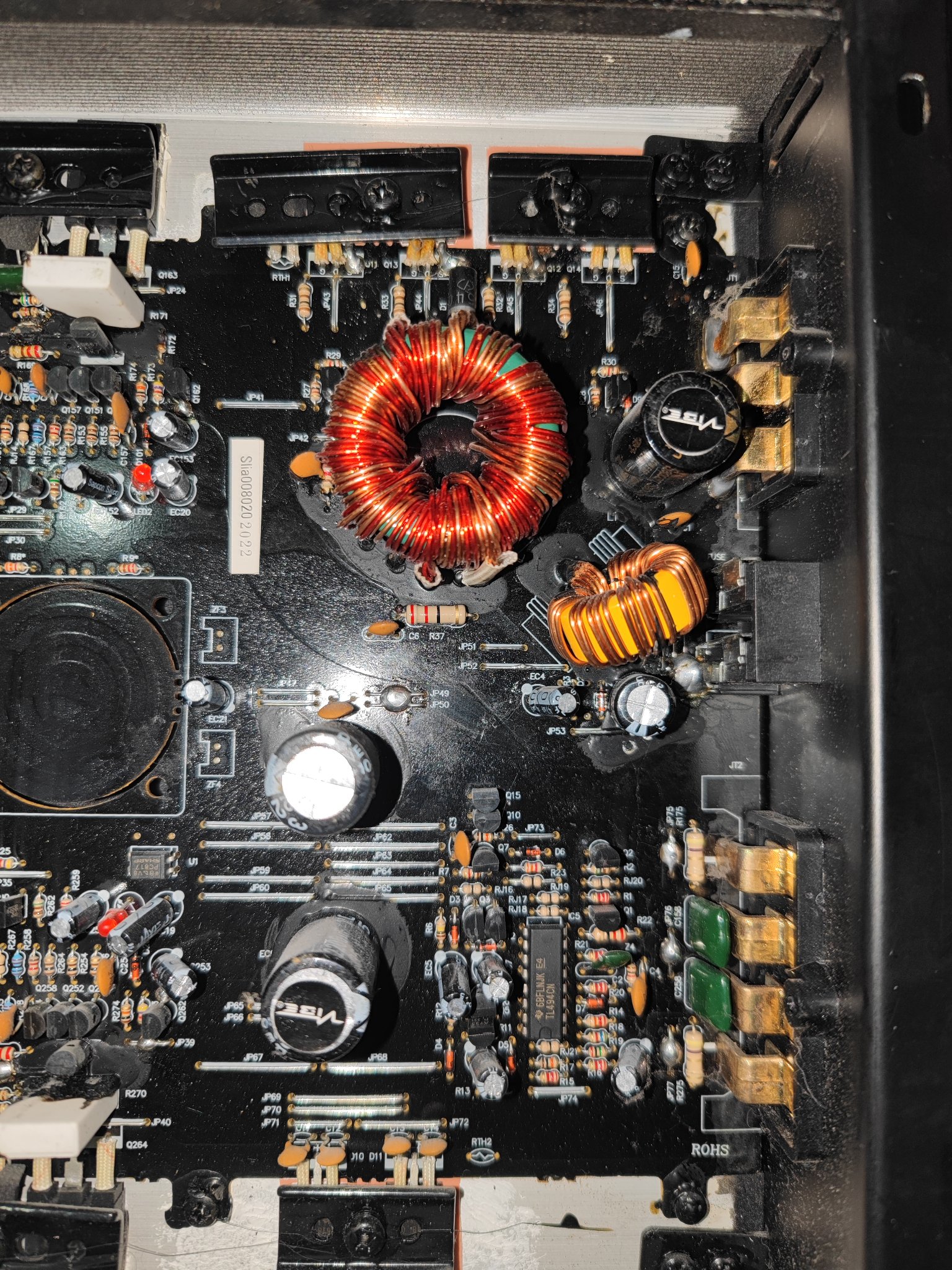

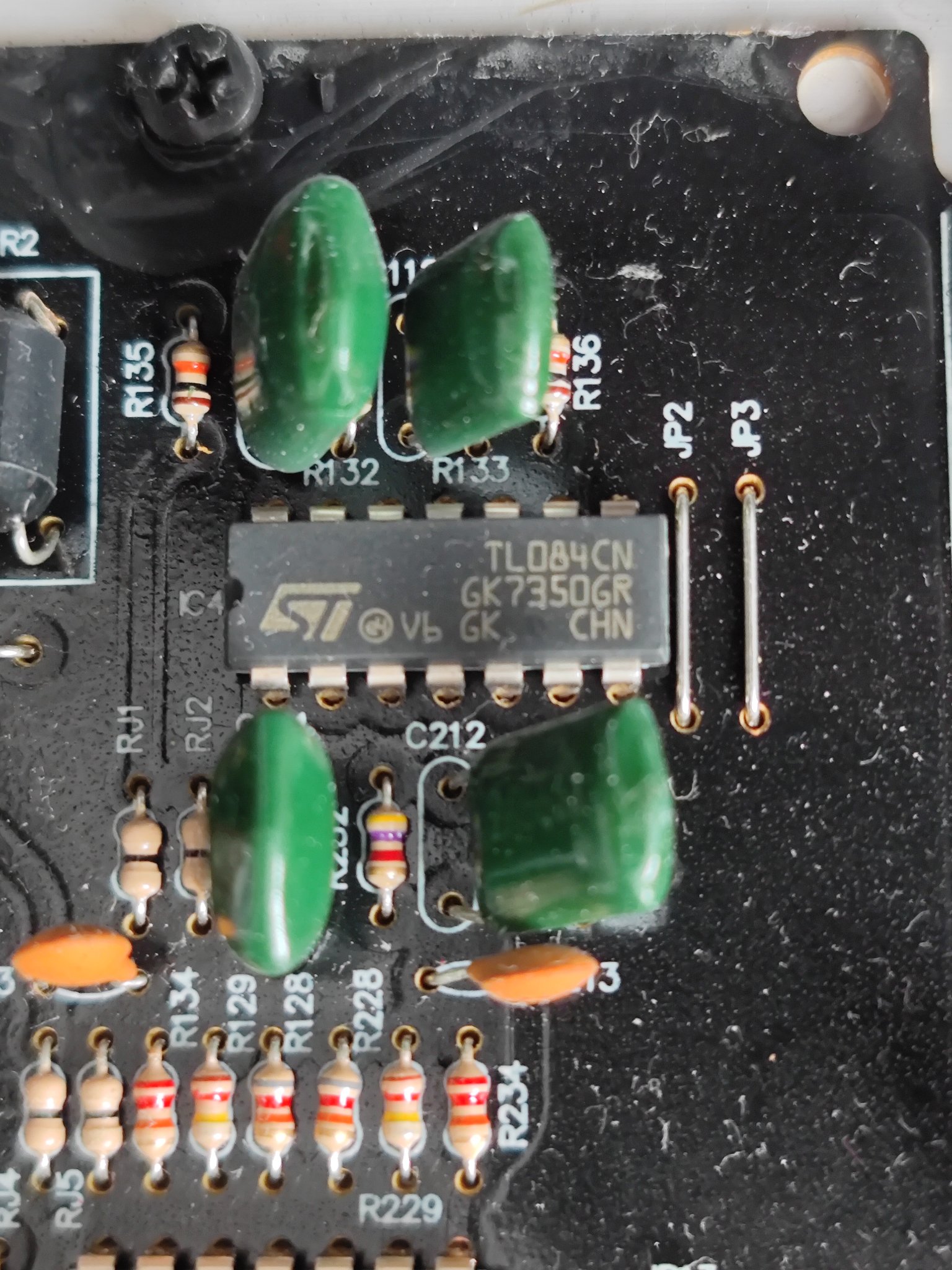

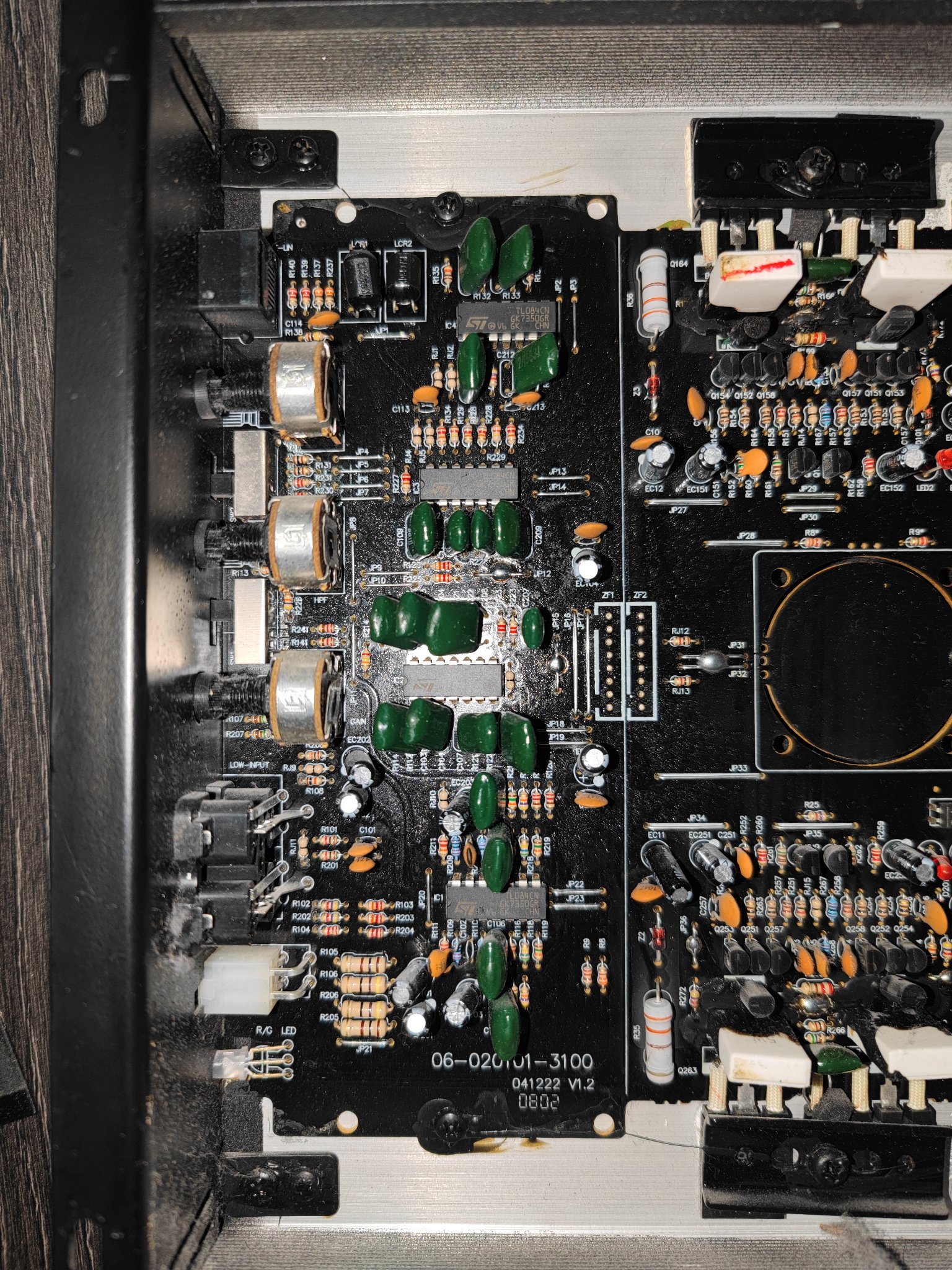

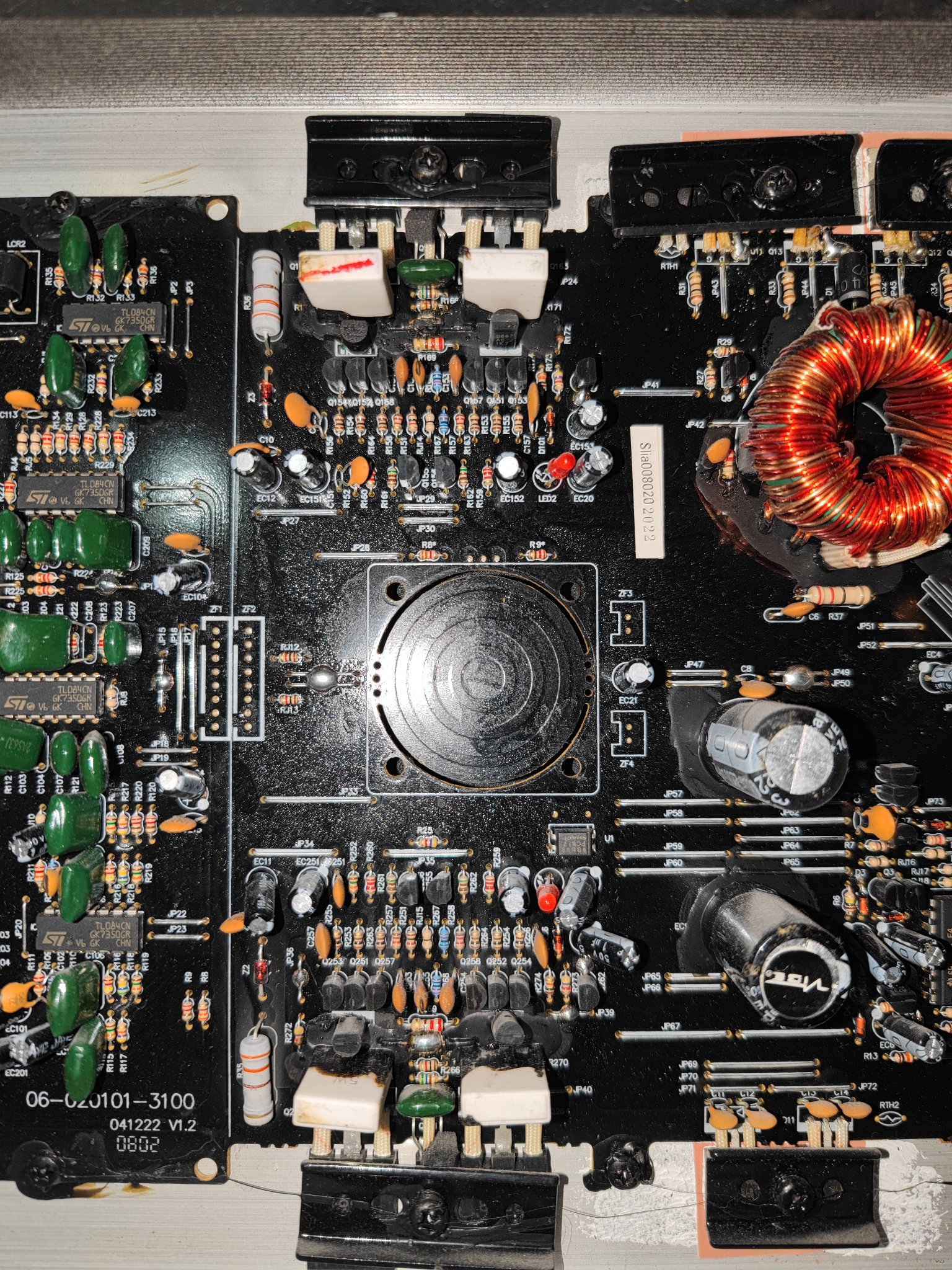

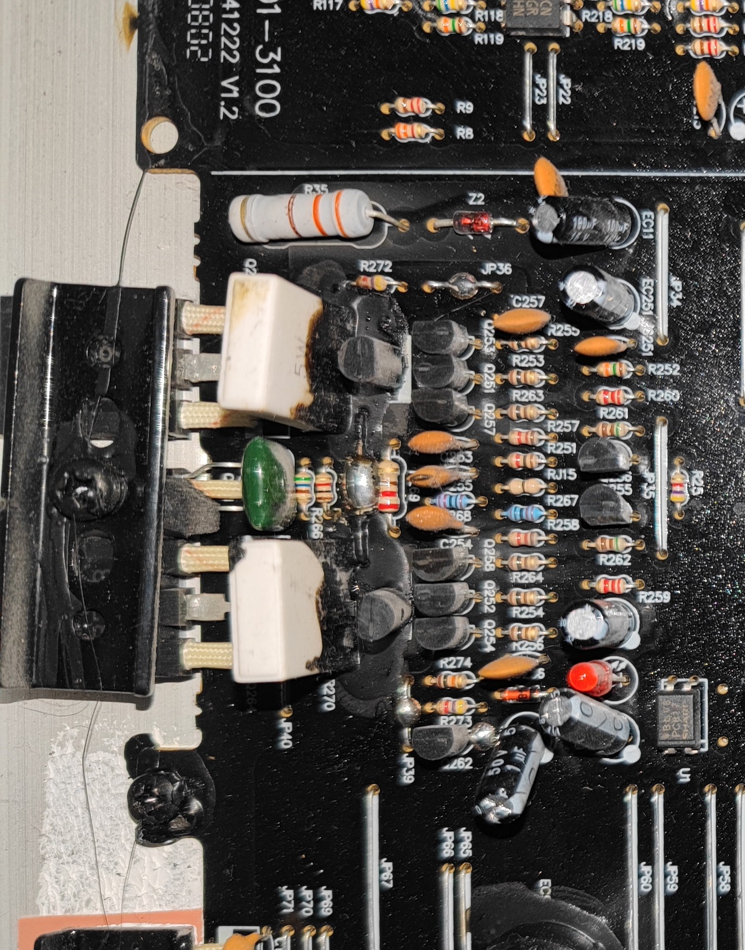

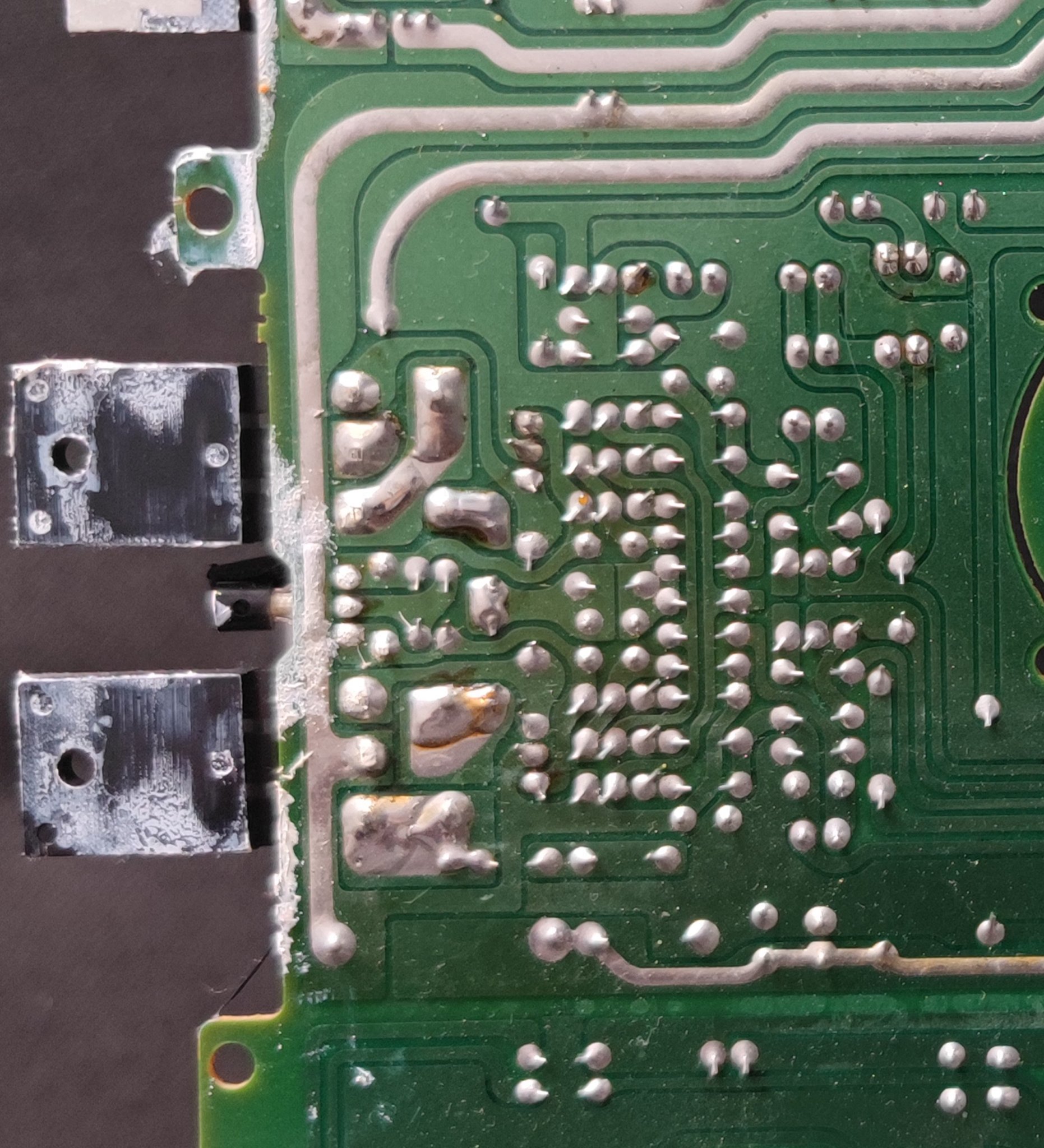

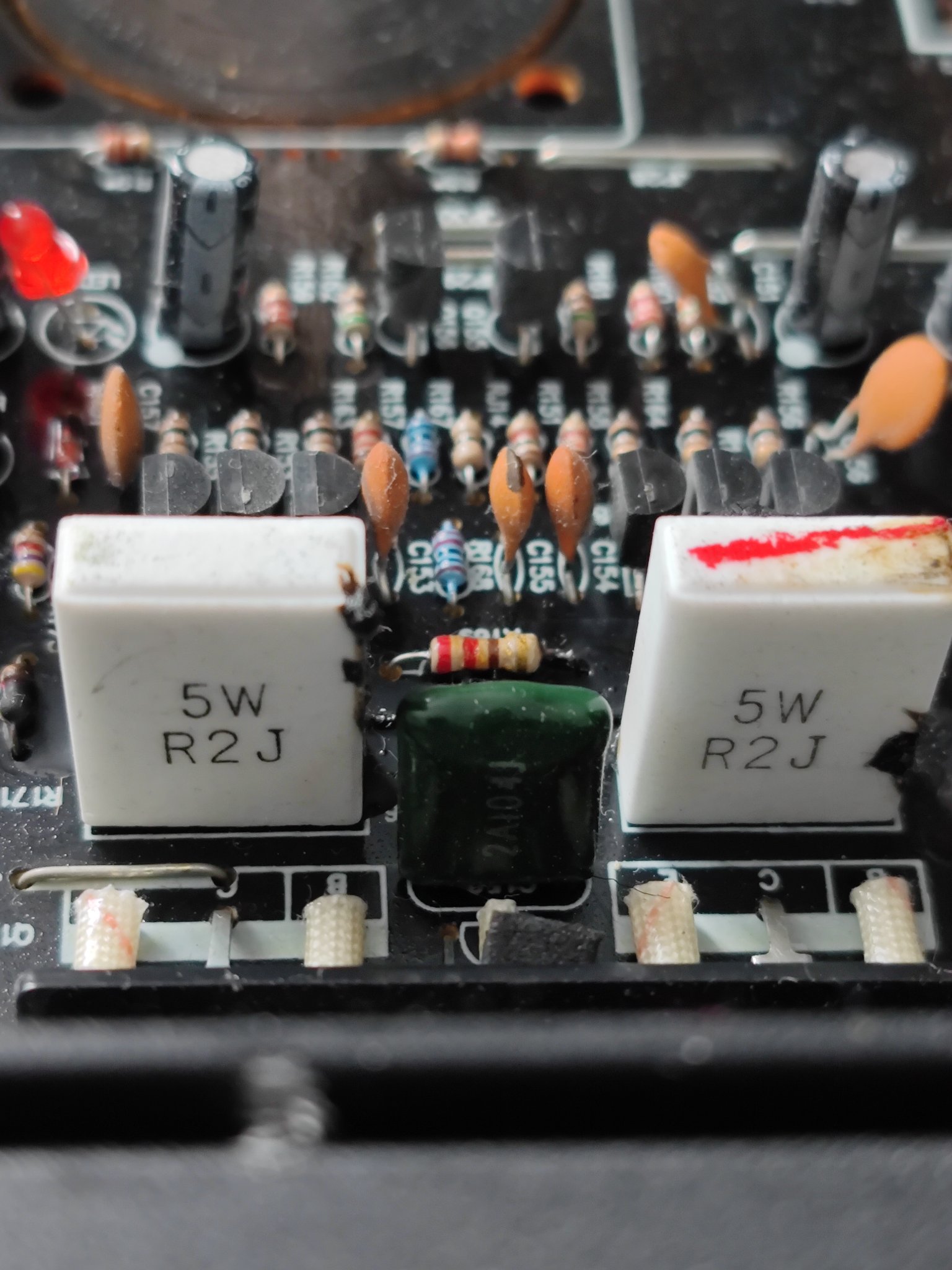

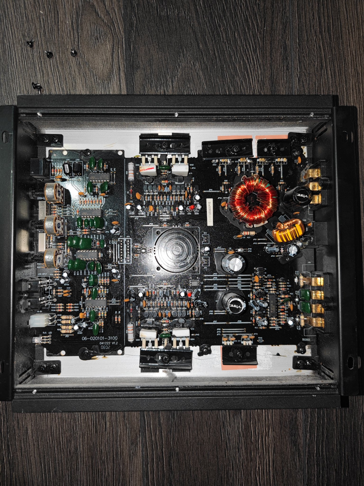

I've opened it up and the board looks ok, possibly some burn marks on the resistors, or not sure if that's just the black residue that looks like it was there from the factory (attached some pictures)
Anyway I'm thinking to replace the transistors anyway, they are currently k d998 and k b778 transistors. Does anyone know what I can swap them with as I can't find these anymore? I am in the UK. I can find 2sc5200 and it's complement (2sc1943?) for a pretty good price and readily available. Would these work?
If anyone has any other suggestions on what might need replacing or other alternative transistors to use any suggestions would be appreciated!

Unfortunately no experience with a multimeter other than basic voltage measurement and continuity testing. Slightly concerned that my multimeter or leads might not be suitable for the job, as touching them to each other shows values between 2ohms to 20ohms depending on the position of each tip on each other.
Nope it does not. So I have prodded around the board a bit. Interestingly those resistors are measuring 0.8ohms on my meter when pressed as tightly to the solder/pin on the back as I can.
What else should I be looking to measure and confirm where the issue lies? I can't seem to find anything that would show anything is dead or weak connections.
The transistors are still in, I have not removed anything from the board yet. It was placed on the heatsink, although not strapped down. However the amp turned into protect basically immediately, I'd assume the transistors didn't even get time to warm up very much (unless they do extremely quickly)
I assume my next step for testing is removing some components from the board? Could you guide me on what I should remove first? The transistors or those ceramic resistors you mentioned.

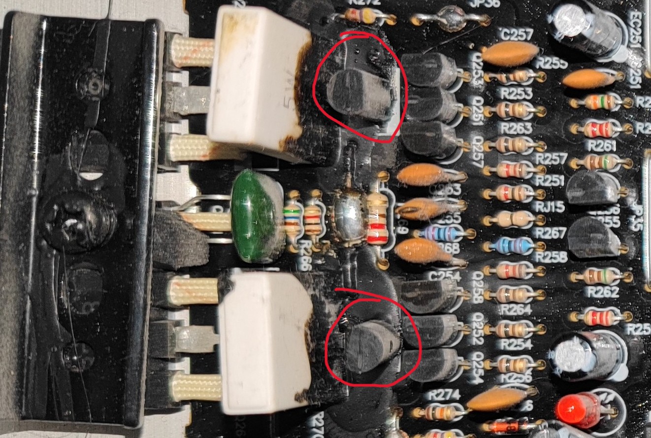

Sorry I am new to this and don't really understand how to read a circuit diagram, I found q116 and q216 in your pdf diagram, but i am not sure where it would be on my board? I assume it is one of these smaller D shaped transistors, not the big d998 style one? Would it be the one of the ones right next to the 5w ceramic resistor?

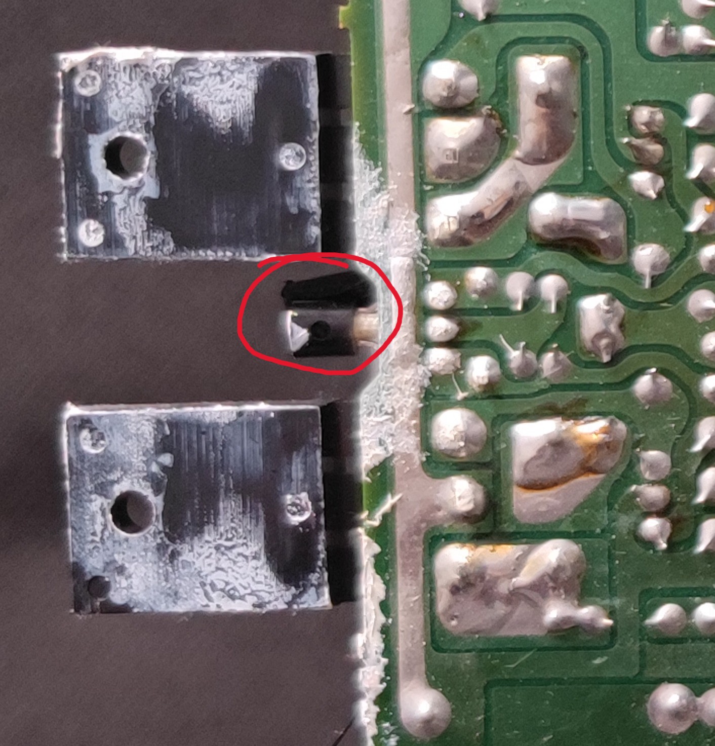

Apologies if i am being stupid, but I can't seem to figure out which one that would be on the board? I tried looking at the PCB traces to see what connects to the emitter resistor, but i can only see it being connected to the D998 style transistor? Would it be this small one that is hanging off the board?
Or the ones circled here?
