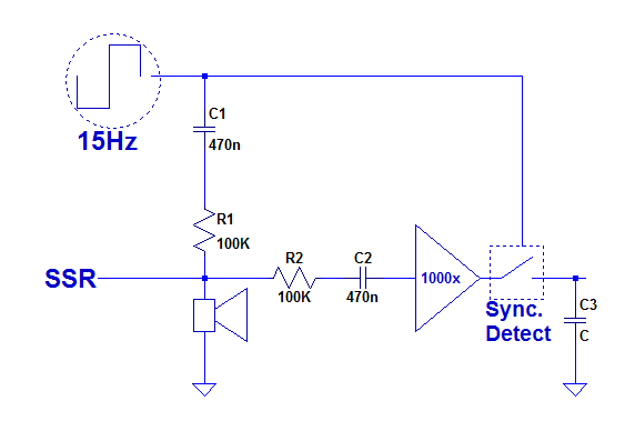

Just took a quick peek at the p300 sch, and they have electromechanical relays on the outputs, so, different..
Do you mean that the detection circuit does not have access to the muting condition info?I'll have to do some simulations.
The key is that whatever circuitry is used to sense this, it must be always connected, and so it must not disturb the amp when unmuted
The example I proposed easily meets that conditionand not be disturbed by the strong signal when the amp is putting out.
That changes very little, and in fact it could help meet your first requirement more easily: when muted, the amplifier output will act as the low Z return.And I'm aiming at the SSR being on the ground side, so that's a tiny bit different..
If the amplifier continues to be active and delivers a signal, a differential acquisition might be required to avoid overwhelming the synchronous detector, but that's not even certain.
To make the stimulus signal unnoticeable in case it is required, it can be passed through a second order LP filter: a 15Hz, -100dB signal is not going to be audible
No, that can easily be arranged. Actually what I have in mind is using a PIC to control it all, so it would be actuating the muting and it obviously would know it's doing it.
I'm fuzzy on that point. Can you elaborate please?
Well, if it can be designed in a way that it can be somewhat deactivated, although it wouldn't be "unhooked" physically, it could be made into something like a tri-state connection, kind of like some ICs are in computers, with their "legs lifted" when in their tri-state condition, so it's kind of like it's not there.
Actually in a way, the speaker's leg taken off line by the SSR is kind of "lifted" that way in something like a tri-state condition.
Obviously it would have to be totally inaudible, especially in case some speaker is highly sensitive and could put out some noticeable sound from a tiny signal.
The sensing signal would only be sent out when the SSR has lifted the leg. So nothing would be issued when the SSR is in the unmuted state.

I’d just inject a say 20 mV DC signal into the muted speaker through a 10 Ohm resistor, amplifier the resultant voltage divider circuit and make sure it was at the correct voltage +- say 10 or 20%.
No need to over complicate this guys!
In fact, if you’re using a micro, it’s a bit of code and 1 resistor.

The speaker will have one end tied to the output, which is a ~zero impedance point.I'm fuzzy on that point. Can you elaborate please?
For the synchronous acquisition, it is all that matters: even if that point is polluted by a strong signal (the music program), it will only see its own stimulus, and if that stimulus isn't present, it simply means that the load is shorted.
To acquire a few mV against tens of volts of perturbation will require a hardware implementation of the sync-det: the ADC of the PIC would not be able to cope with such a dynamic range, but the detector can be as simple as a CD4053.
In fact, most of the functions required to implement the whole circuit could be carried out by a single CD4053
With the switch in the GND side, the signal will be totally inaudible during normal operation. Only when muted, a small 15Hz signal will be heard.Obviously it would have to be totally inaudible, especially in case some speaker is highly sensitive and could put out some noticeable sound from a tiny signal.
You do not even have to turn off the test signal during normal operation

The sensing signal can easily be generated by the PIC, and there is no need for much electronics afterwards to get back the sense signal to be fed into the PIC.
Generating a signal that won't harm speakers is important. And all that stuff has to remain hooked up once the SSR goes unmuted.
