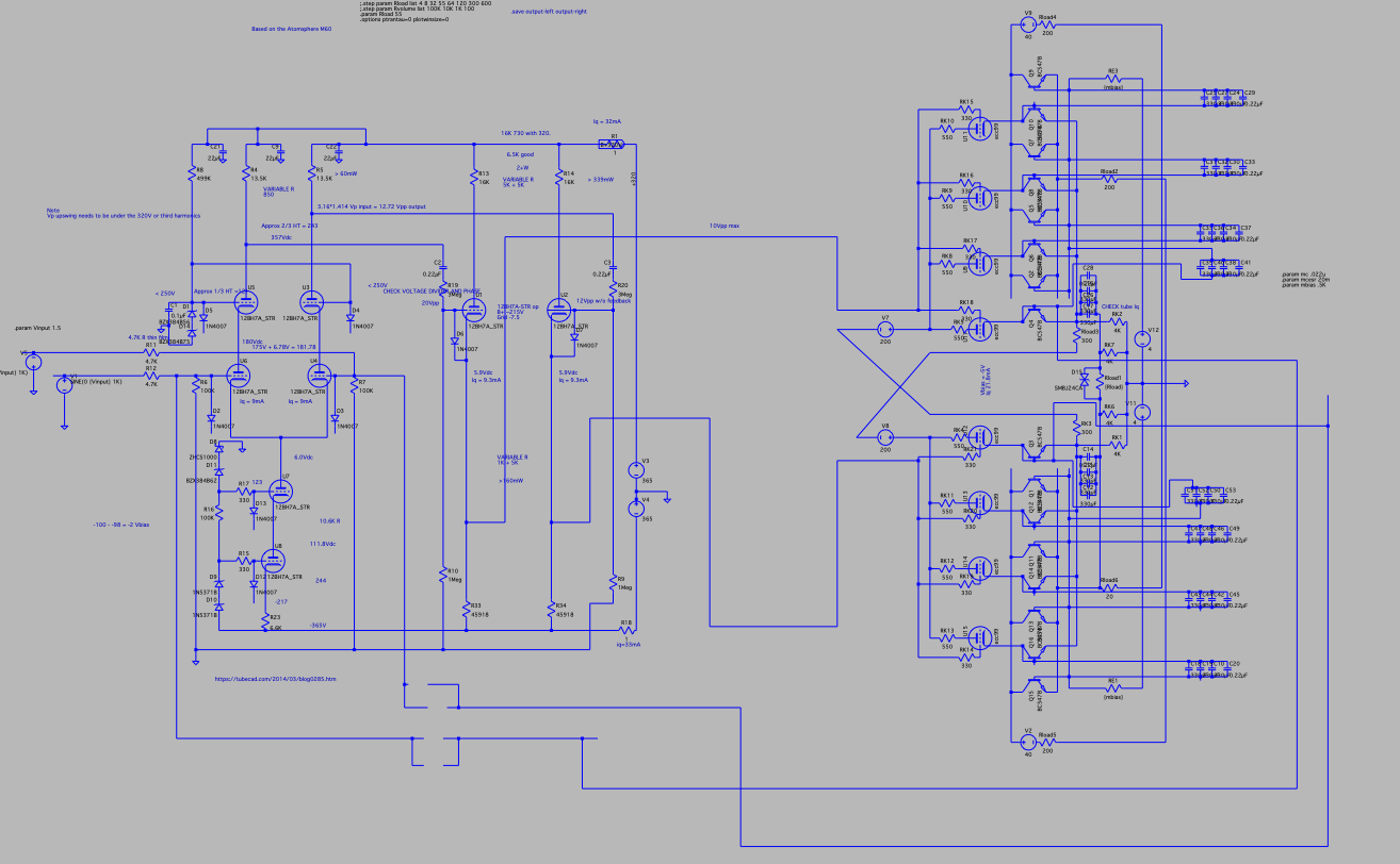

The current schematic:
I noted that the driver input voltage divider is adding a very very small bass phase increase, so I will also have a look at that later - hence the big capitals.
I'm happy that the back end is feeling better, the cascode is, in reality, probably creating too much gain ... but I have a couple of ideas on that which do not use voltage dividers near caps but possibly use some local negative feedback to reduce signal level.

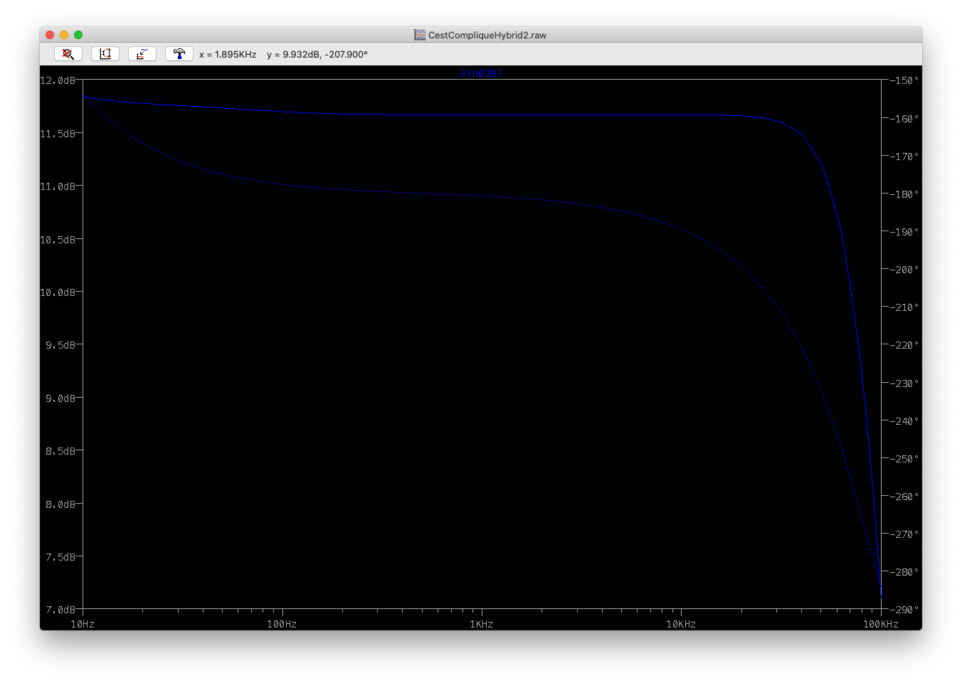

I wrote a lovely post only to be told my token had expired..

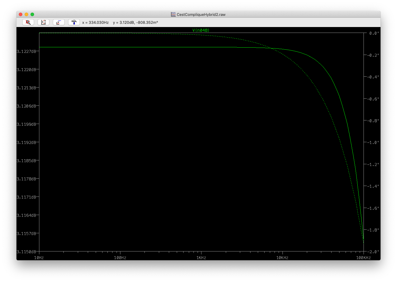

That will do - given an LTSpice sim is about as precise and accurate as a game of pin the donkey at a state level. It does give a general picture of things working or not which can curtail the obvious and the oblivious.
It's currently configured for my 104dBV headphones and CD player which I've measured 1.5V peak on some CDs. Let's be clear - I've seen this push 24V and 450mA just as happily as the values below (I have a 24V TVS across the load - an idea stolen from UltimateX86's schematic).
Input -> Output
-10dB 447mV -> 290mV, 5.2mA
-3dB 1V -> 650mV, 11.1mA
1.5V -> 960mV, 17.5mA
+10dbV 3.16Vrms 4.5Vpeak -> 2.14V +3.6dB

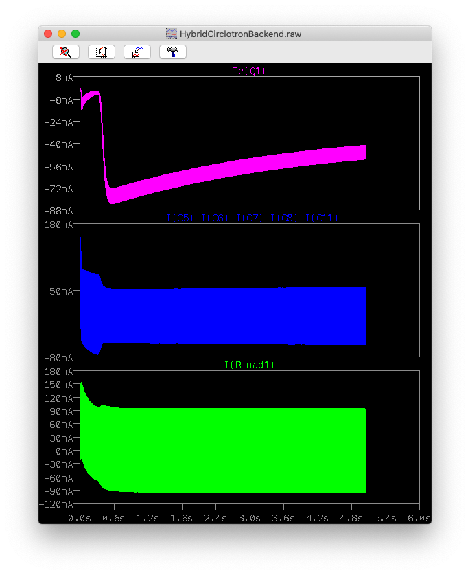

NickKUK
2019-12-28 9:16 pm

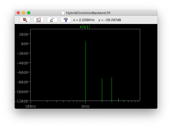

I've simplified the backend to remove unneeded components:
* the mirror BJT in the tube line isn't required - they are all connected so a cap bank provides all the required current that's required.
* removed cap banks - leaving one for the combined tubes and one for the BJTs base isolation. The multiple banks were, in fact, in parallel.
* stripped out resistors used for quazi-biasing - these, in a 60 second sim end up causing the system to fight. Biasing has to be via a negative to the grid (just like the original circlotron).
I've tuned up the tube side by disconnecting the BJTs (I may make this a switch) - this is the output at full 4V peak input and a full 160mA peak-to-peak across 55ohm:
That's enough not to worry about BJTs.. I'm just waiting for a sim to finish with the BJTs connected.. it balances nicely - the BJTs provide power and the tubes backoff their peak-to-peak voltage swings.
Bottom combined through load current (green)
Middle combined tube peak-to-peak (blue)
Top a single BJT current combined bias and signal (pink)

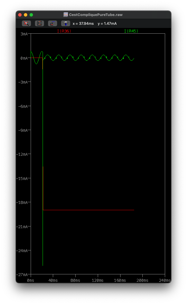

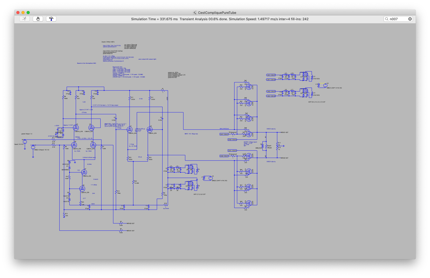

NickKUK
2019-12-28 9:16 pm

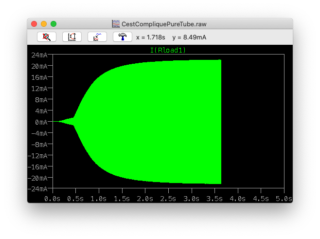

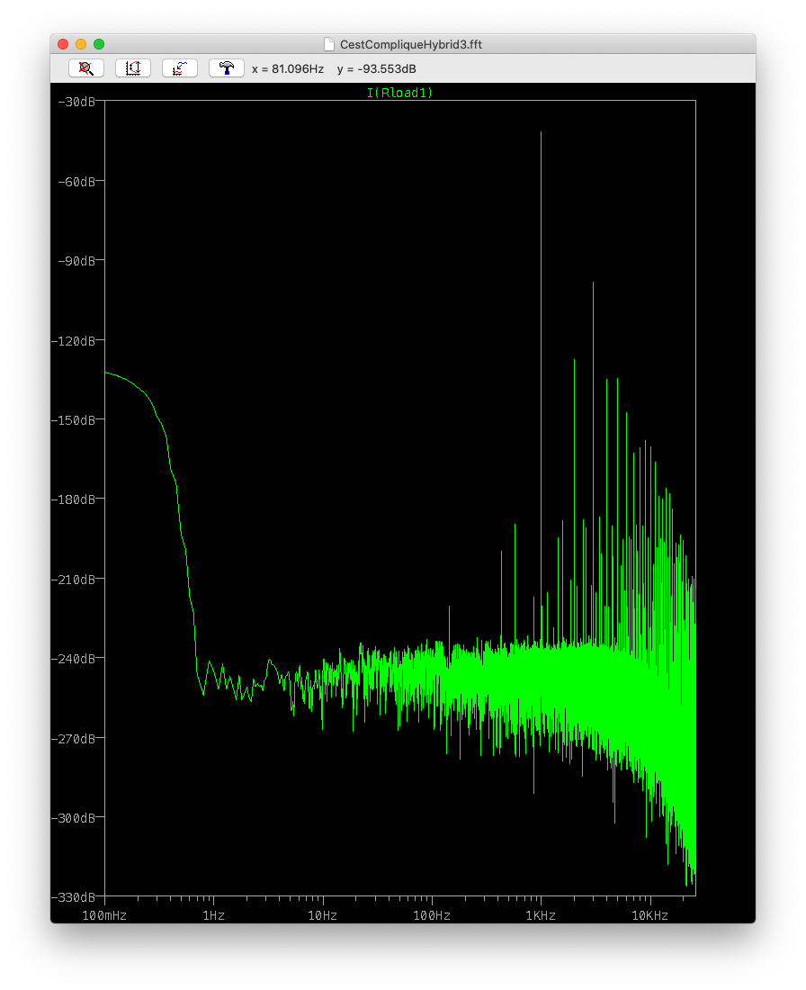

Just leaving this simulating for today - pure tube direct connected version (no isolating caps). This is essentially an M60 in class A only operation.
It's very well behaved on startup - load current with 1.5V peak input with the front end tuning the same as the capacitor version.

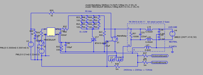

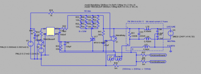

So I have a soft start.
The aim of the soft start is to keep under 6A for the IEC filter (rated for 6A). There are two transformers (although I need to updated the sizes in terms of henries). Plus, currently, the heater transformers are missing.
A Triac with an inductive load rather than reactive. I use a back of resistors to provide a start resistance, limiting to about 4.5A (2A rms). The MOC provides a optical isolation from the 5V soft start switch and also provides zero crossover triggering for the 10A capable triac. I still need to model the relay contact bounce.
I'm familiar with SMPS and the fact that a triac attached to a transformer becomes a SMPS switched inductor boost controller. I've put snubbing in to prevent large spikes. This also causes problem for optical isolators likes the MOC (https://www.st.com/content/ccc/reso...df/jcr:content/translations/en.DM00451014.pdf)
This approach provides a tube like soft startup with all the power supplies and parts starting up at the same time but at a restricted rate.

I suggest you include jumper options to adjust the delay between switch-on and softstart bypass. Here's measured data on a solid state power amp (using a current probe), at two different settings of the delay. Personally, I like the long delay better. But this choice does heat up the inrush limiting series component a lot more, since it's conducting current and dissipating power for more time.

The snubbing is important, not from an audio noise perspective as it's muted, but from a heater power voltage spike perspective.
The crossover point for the ZCD triac initial trigger is just far enough up the wave form to create about a 26mA spike which carries through that needs snubbing.
The ZCD then causes 230uA spikes on each successive waveform crossover.
Here is the ZCD triac (not the main triac) just operating by itself - although a sim using the official model for that ZCD triac, it hints at some of the noise expected and the additional snubbing required to remove the noise. Noise/spikes on this output current then cause issues for the main triac.
Snubbing an AC waveform is a PITA, you add capacitance to solve the spike, but you then cause a transition issue for the AC waveform.. So the method I'm looking at is a low pass filter configured to allow the AC rising waveform through but not the spike.
