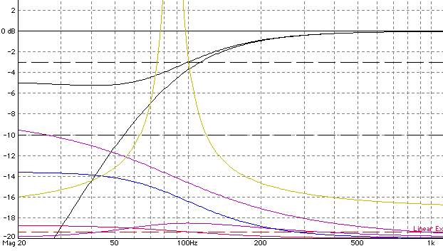

I've plotted a couple of boxes in WinISD - a 15l sealed box gives a Q of 0.57, as advised by planet10. Am I right in saying that I could start sealed and simply add a port later if necessary?

The FE167E rolls off fairly high in a 15L sealed box - you probably won't get much bass at all. If you want bass and small, then you will need to go with BR, with a front port.
I have my FE167E in the recommended BR, and measurements suggest that they are at -3dB around 60Hz, which isn't too bad at all. Mine are pushed back against a wall in a room very similar to your's in size, and don't sound "boomy" to my ear.
The baffle width shouldn't have an effect if they are corner mounted - the wall will act as a baffle, extending the width. If you go with a right triangle, you will need good bracing to keep your front panel stiff. Other than that, you could probably just build whichever you think will look better.
I think you might be surprised. He is corner loading them and his room does not have a whole lot more volume then a car. Put a sealed box in a car and you get pretty close to flat to real low because of cabin gain.
dave

I will try the sealed 15l box and see how it sounds after a few weeks listening.
If I don't like it I can soon convert it into a 15l ported box as Fostex recommends (albeit a different shape).
