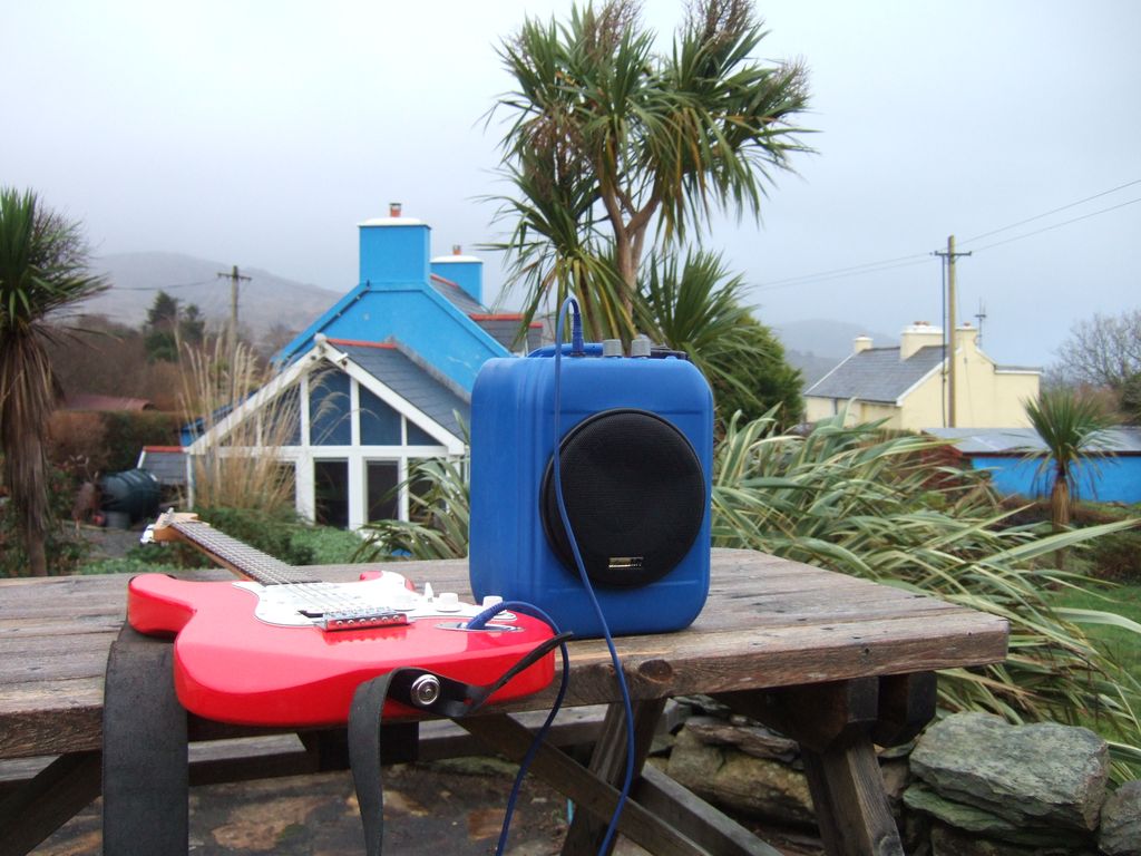

One of my early designs with 6.5" speaker in a 10l canister.
I call it the "trAmp" 😉
I just checked the Eminence and beside my little knowledge seems also to me that is much better! Unfortunately not only the specs outperform the Jensen, but also the price 🙁.
Love your bluey trAmp (and the name!!!). Is that a water tank?

Indeed the blue trAmp is housed in a used 10liter water tank.
