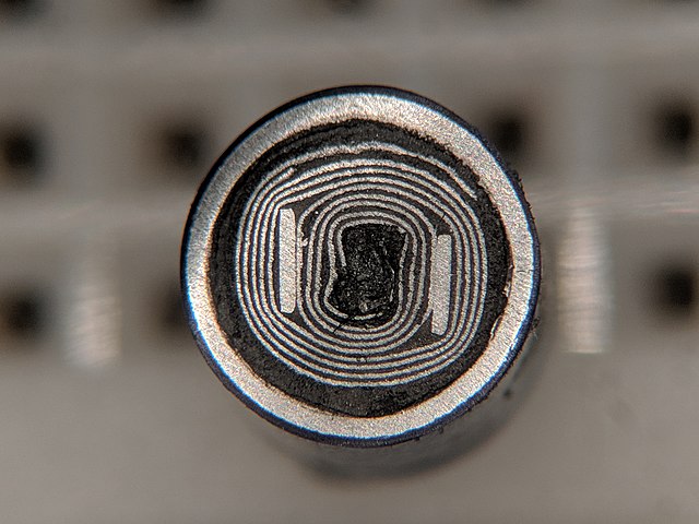

Hi. I've got a pair of 1000uF relatively low voltage Nichicon Muse capacitors with dents in them. I've had them for years at this point without knowing they were dented. They were part of a kit and not worth bothering the kit maker over, so. I'm trying to decide if they're usable in say the early stages of a low voltage power filtering circuit. With a cheap LC meter, they measure within spec, e.g. ~10% down of rating. There is this older thread discussing film caps with shipping damage and opinions seemed somewhat mixed.

If they measure the labeled capacitance within ±20 % at least the capacitance is good. But the dents will have caused the foil inside to deform, so all bets are off regarding the voltage rating. Personally I would toss them. I would definitely not use them in a power supply. They may be useful for decoupling capacitors as long as the voltage across them isn't more than a few volt.

The attached cross section suggests there's space between the aluminium can and the internal foil that should accommodate a small dent.
* as long as the dent does not cause the square corner of the electrodes to smash through the electrolytic-soaked paper dielectric. Without X-ray vision (or actual X-ray imaging) there's no way to tell. Unless you want to take the cap apart.
Tom

Some manufacturers lightly and uniformly crimp the cans down onto the internal roll to prevent movement and better withstand vibration.
You will notice that the crimps are not sharply formed in order to protect the windings,and additional insulation is generally used for safety and cushioning.
There isn't always the amount of space shown in that pic above. I've pulled electrolytics apart where the foil roll only just fitted inside the can, with there being a slight suction when removing the innards because of the wet electrolyte.

Don't count on there being internal clearance, or no damage to the internal insulators. Depending on where they are used there is always the possibility of a catastrophic event that could damage other nearby components.
