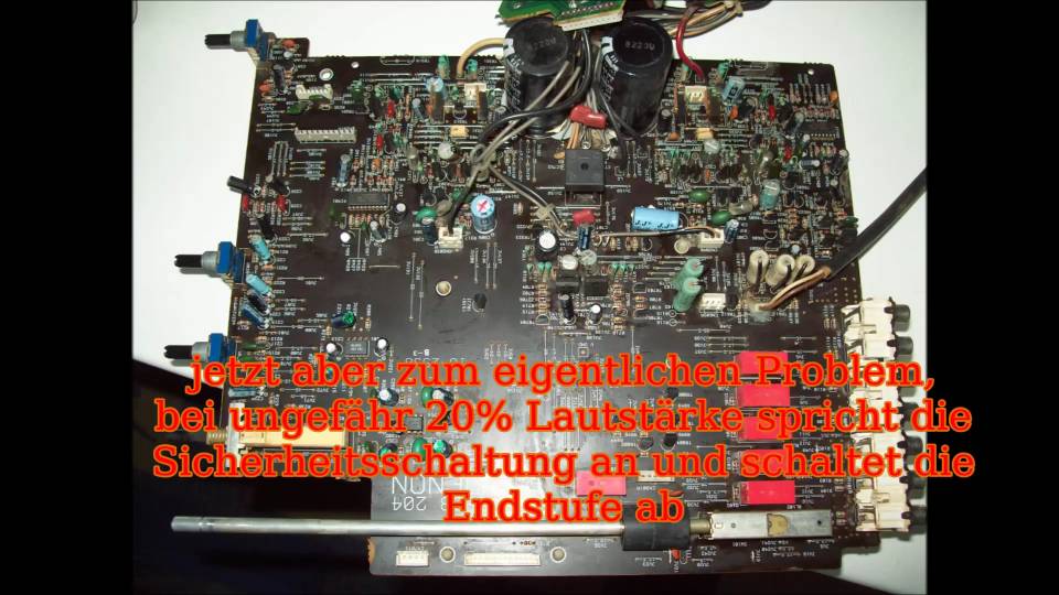

I have a 925r which drops the audio when i pass 30% on the volume control.
Before switching on I soldered main pcb complete, loads of dry joints.
HELP please as this is an incredible amp.

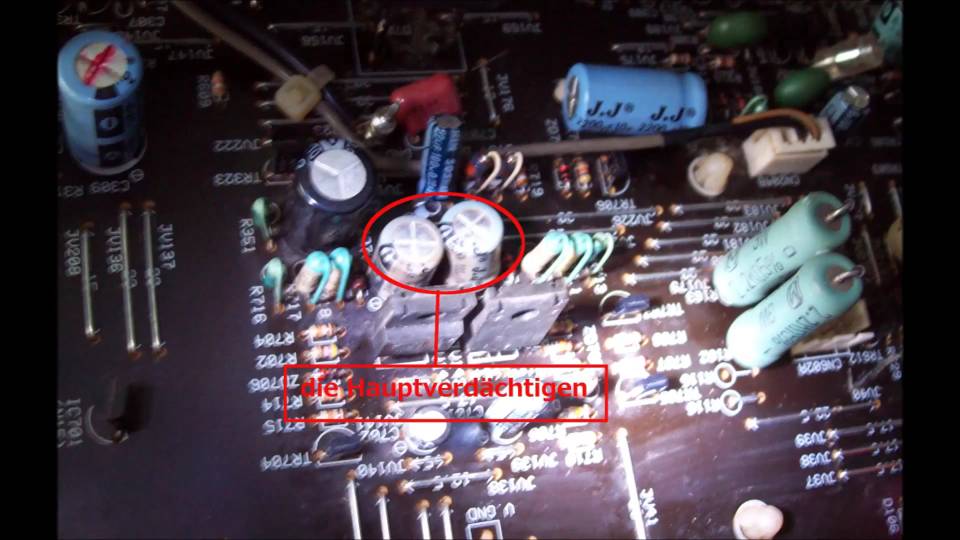

Google translate tells me this person had the same issue with a PMA925R and it was due to bad electrolytics, in that case it appears the primary suspects were C704 and C703.
If replacing those works I'd suggest replacing the remainder of the electrolytic capacitors, too.
