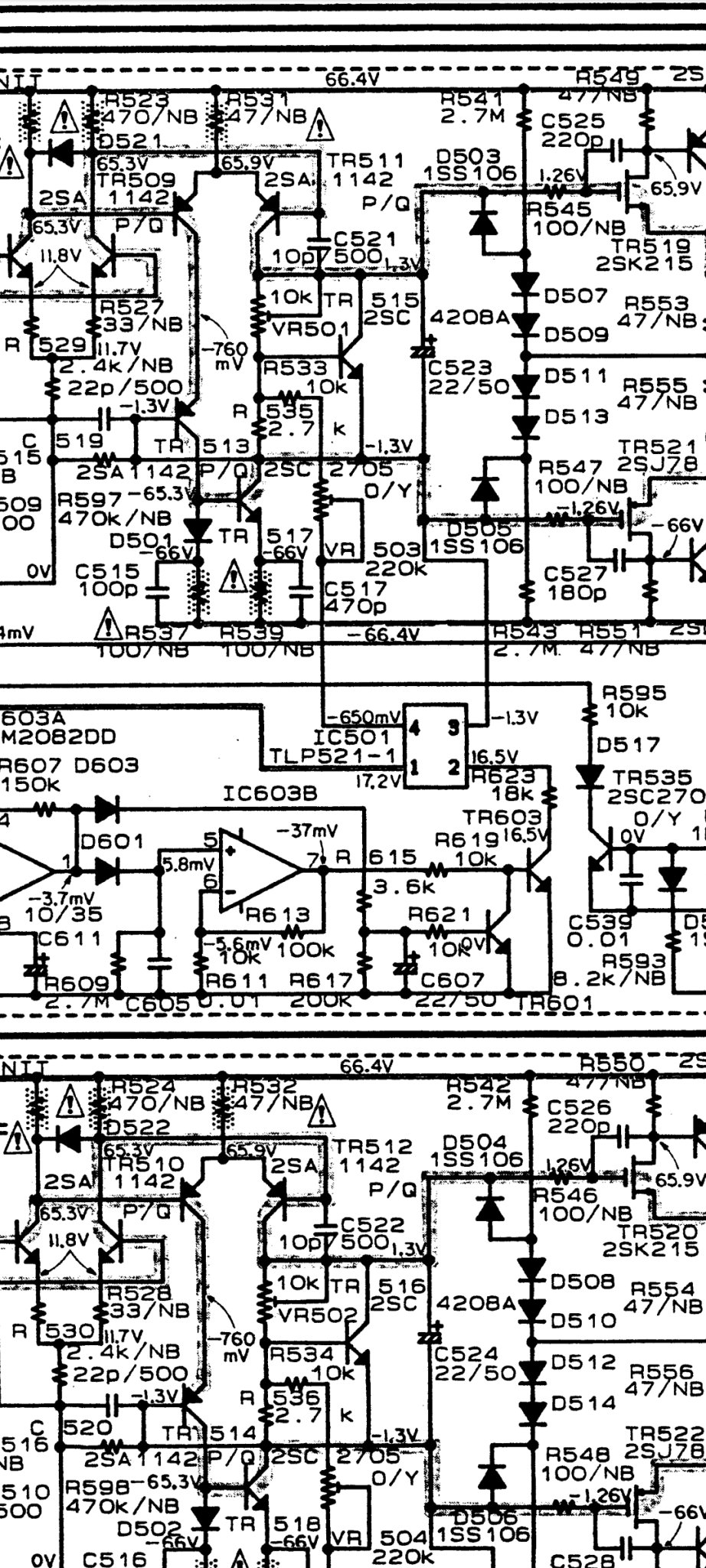

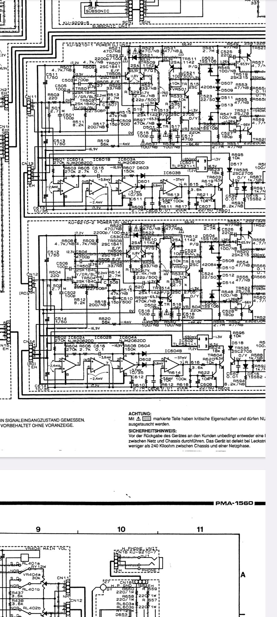

What diode could replace 1ss106 (a) ?
Would bat 42 / 43 work , or are there better subs?

I'd suggest SD101, BAT81, or BAT83. It all depends on the circuit schematic which you did not provide. A wild azz guess based on zero information, is that (Vfwd @ 1mA) might easily be the performance requirement which matters most.
On the other hand if it's an RF detector then 1N5711 might be better.
Here's the full Hitachi datasheet in pdf format
D503 - D 506
Adding partial schematic
