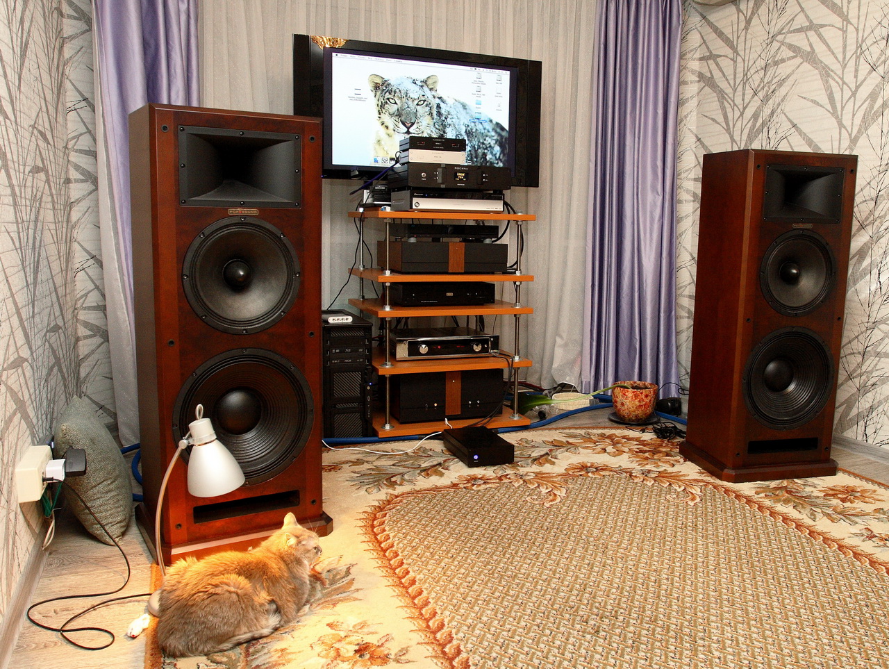

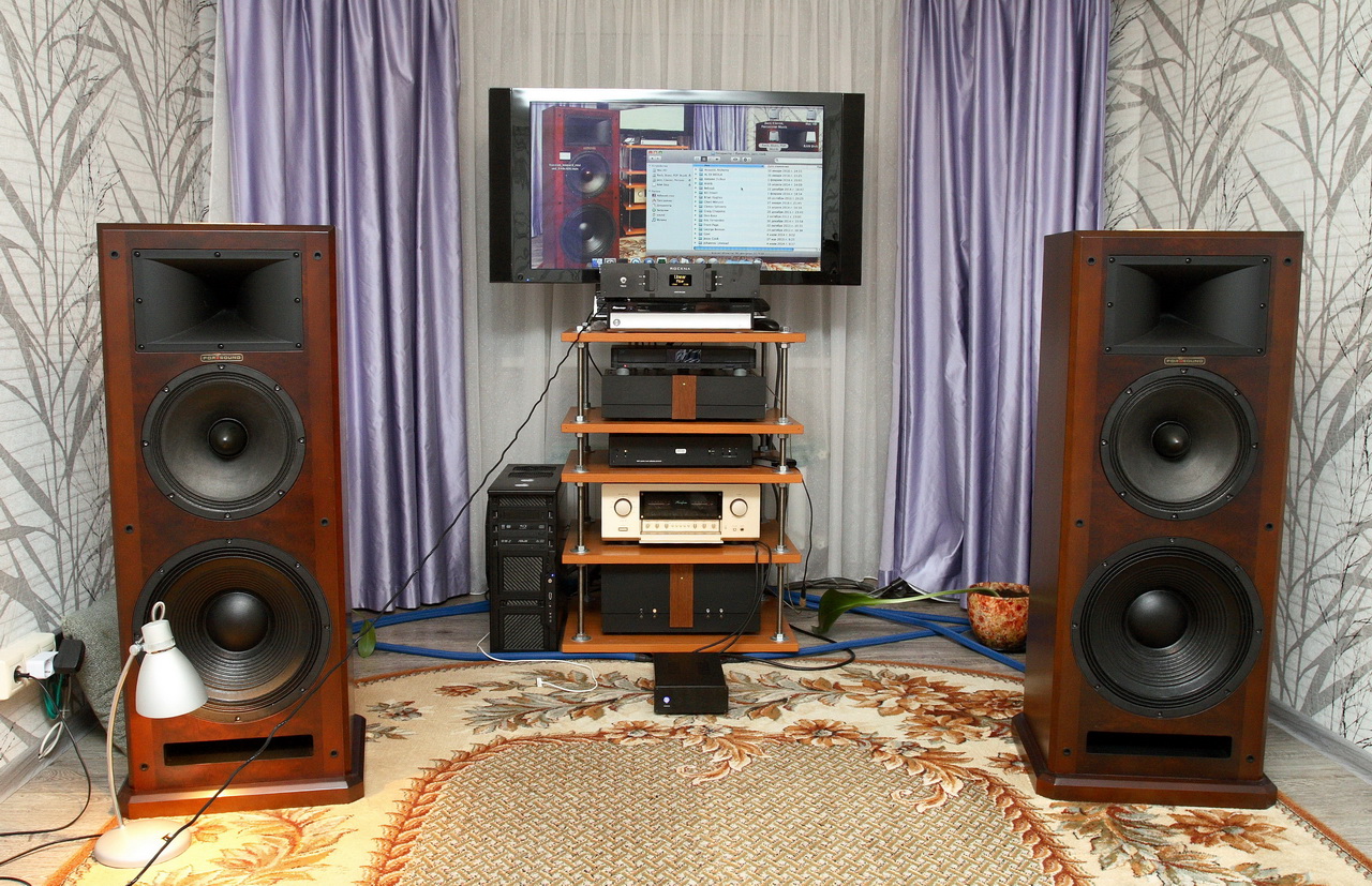

In our country, one speaker in 3 bands. Each band has its own amplifier (3 separate amplifier) and I can not put the delay in one column of bands to each other. We reduce by hand, not in the machine and all you need to configure manually - crossover bands of the volume, delay and so on.

If I understand you correctly, you have three drivers - tweeter, mid, bass. You would like to time align them manually. There is no way that I can see to time align three drivers independently.
With "single amp with optional stereo subwoofer" you can manually align the two. Note: that with this option, the lower driver doesn't have to be a sub, it could be a combination of tweeter and mid bass, etc..
With "biamp plus stereo sub" you can manually align the upper two with the sub (again, doesn't have actually be a sub).
That's it. If you want to time align all three, you have to do the upper two automatically, then manually do the bottom driver.
