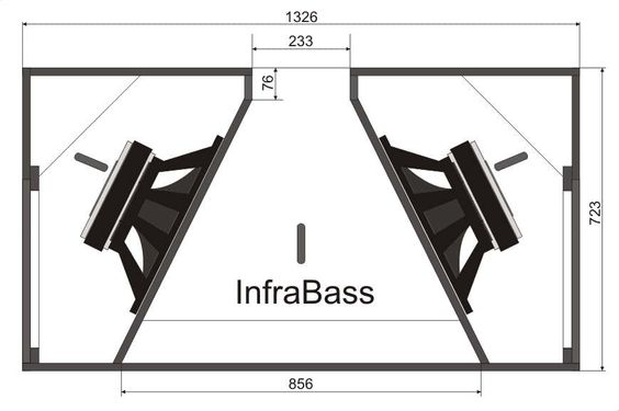

I'm going to be embarking on a build soon and I'm curious about this cabinet and if anyone here has experience in the design. The plan is to replicate 4 similar cabinets and potentially build 2 Infra Horns to supplement them.

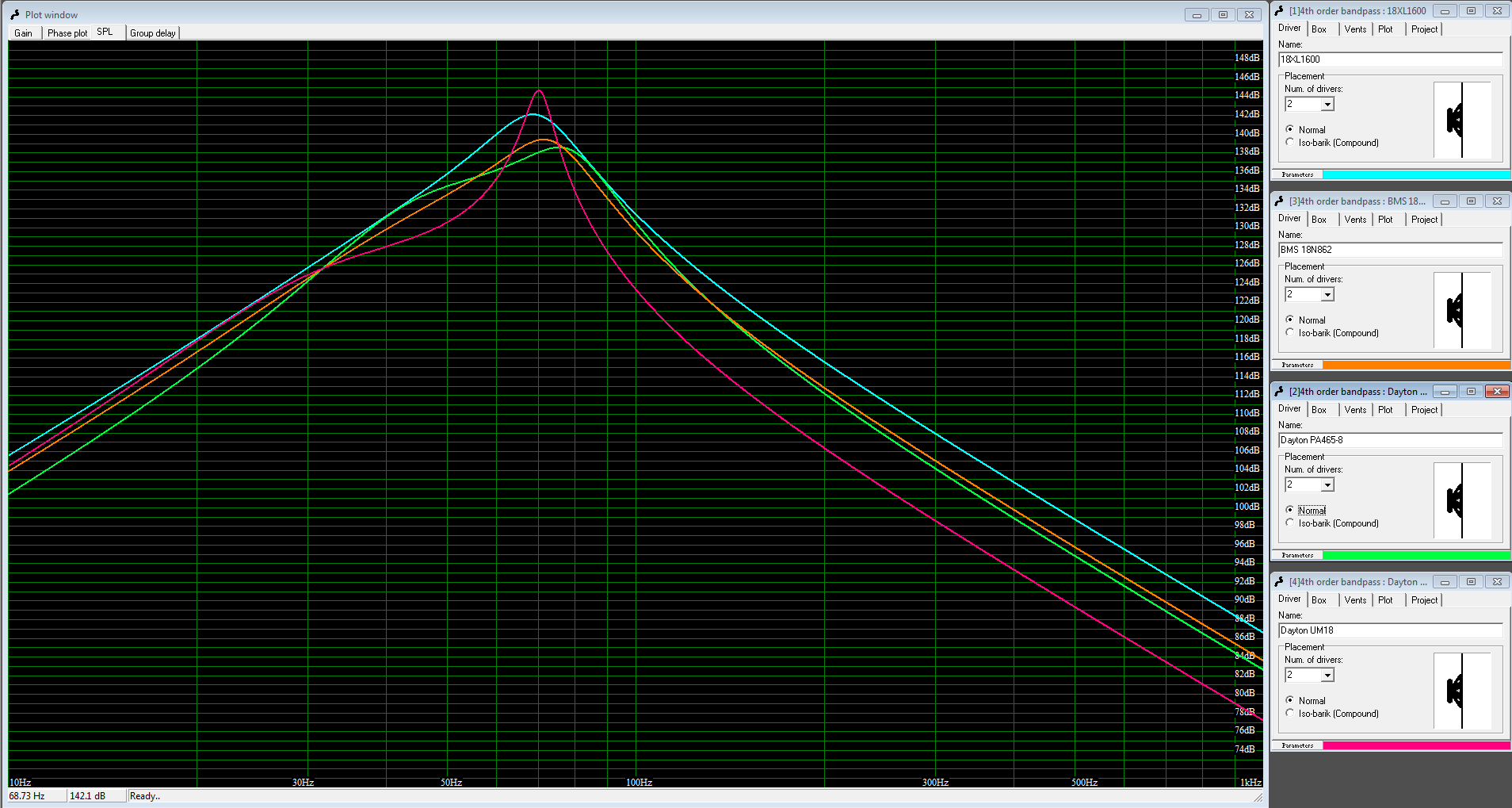

As far as I've searched, I could only find one set of vague plans and I have no idea as to its accuracy. I was able to extrapolate approximate volumes from the plans and it looks like the tuning is fairly high considering reported response. (65Hz according WinISD). Bandwidth isn't too wide either. Am I missing something here?
Vt Rear chambers = 225.4 L
Vt Front chamber = 216 L
Port area = 1030 cm^2
Port Length = 7.62 cm
These will be my first 4th order cabinets and I'd love to get some input from those with more experience. Do these plans and model seem accurate for those boxes?
Cheers!
Edit: all drivers modeled @ 2000 watts

You can't sim that accurately in WinISD.
To get a more accurate sim you would need to calculate the cross sectional area at the closed end of the front chamber, at the midpoint of the drivers, at the beginning of the port and at the end of the port. You would also need the length of each of those segments.
If you could provide all those specifics as well as driver t/s I could run a quick sim in Hornresp. Not sure how much difference it will make but it will be an accurate sim.

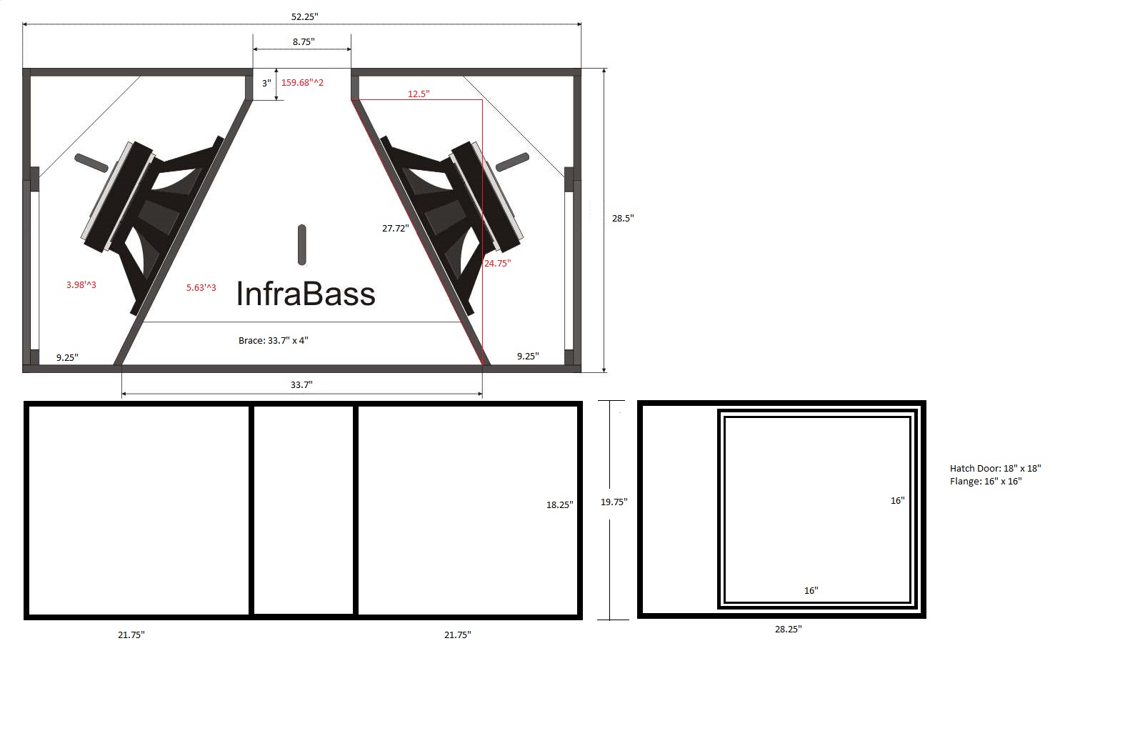

Here is what I came up with. Please excuse the crudeness of MS Paint.
I'd do away with the hatches and just mount the drivers from the front. There should be enough space in the "horn" to pass them through and fit them in. Screwing them might be difficult, but not impossible. Making the center brace for the horn removable would make it a lot easier.
Thanks just a guy. I kept scratching my head on this. Looks like this a true one-note-wonder. So many pitfalls in the data. I can only conclude that this design from the web is complete bunk or maybe these need to be used in multiples with the infra horn to help system response. Unibox threw up a red flag for exceeding Xmax and port air velocity.
This is actually what I was looking for - more justification for another design. I have a hard time believing this is F1's actual design.
As shown (at 6000 watts) excursion definitely was not a problem and port velocity was around 36 m/s.
6000 watts is probably a lot more than the drivers can handle so port velocity at much lower power levels is probably ok.
But the design is still junk unless I did something very wrong. Check my inputs.

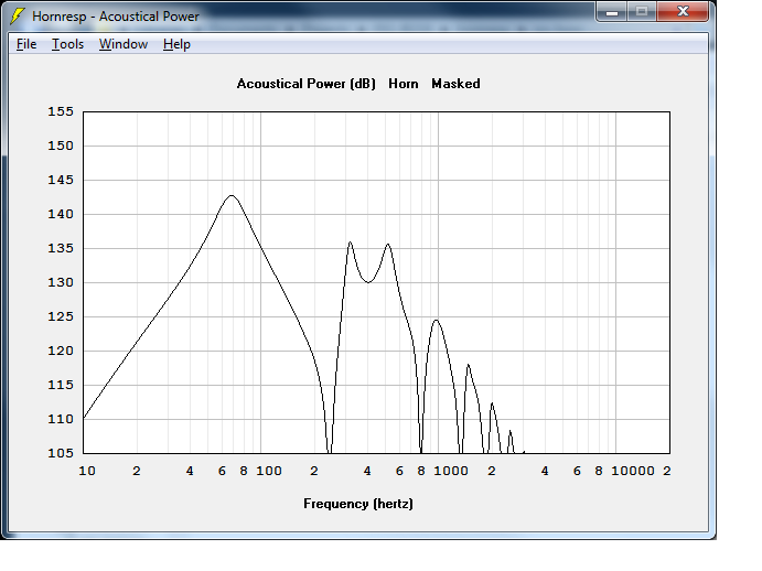

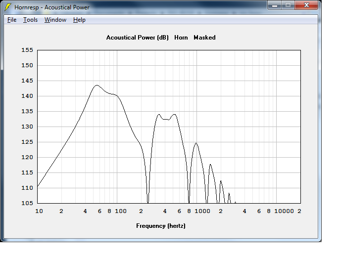

Not exactly the same data but very similar results...
I have used PD1850 as driver.
Things are different if the "infra-horn" is attached (See S4,S5,L45 on data).
But the size of this stuff becomes impossible...
Anyway I suspect there is something wrong in the plan...
Are you sure that is 4th order?
There are no vents between the 2 chambers?

Another question from curiosity- how was the layout in OP's post arrived at? Is that known to be approximately what the internals look like, or a wild guess? Can't help but thinking there's a fold or two missing. There's lots of ways to get approximately the same specs as the IB218 with these drivers and this much cabinet volume, but this layout seems completely wrong from looking at the sims.
Reactions: 1 user
Excellent question. I believe this is another "I read it on the Internet" problem. This design is all I could find after searching around. Like I mentioned, the most likely cause for these poor sims is these plans have zero validity as to their accuracy. They only thing we really know are outer dimensions. Someone could have easily filled in the gaps as to what's going on inside and then posted it.
