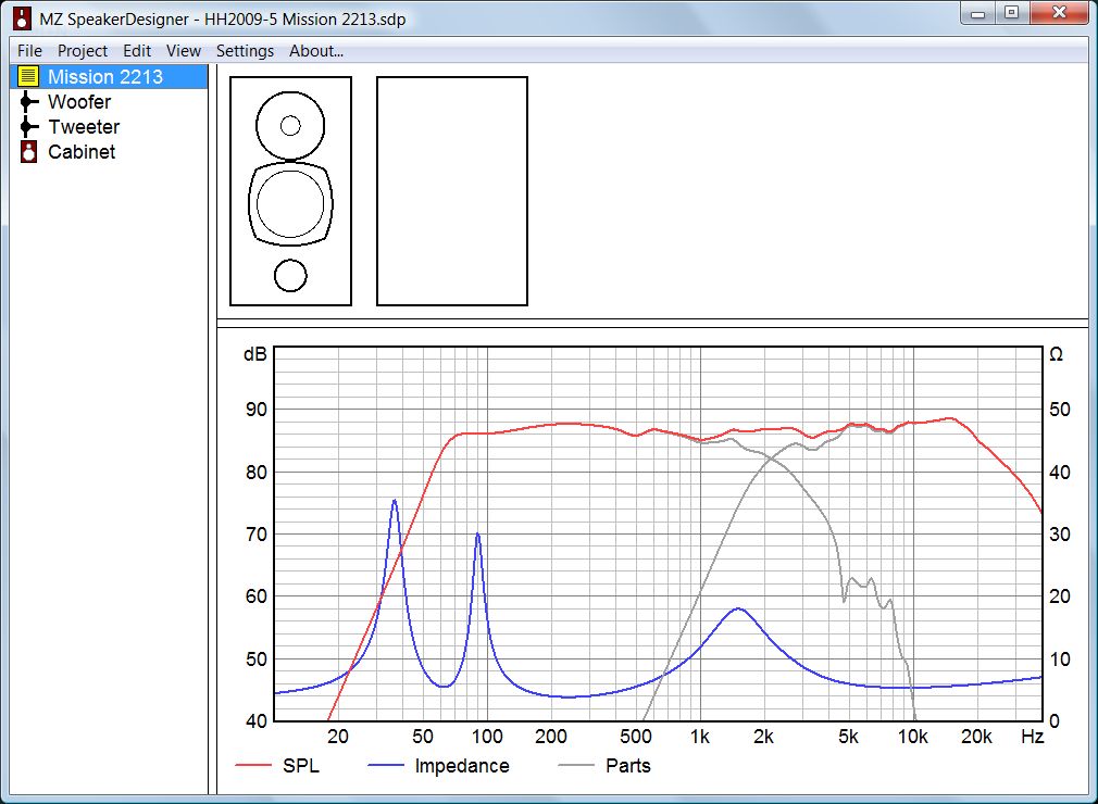

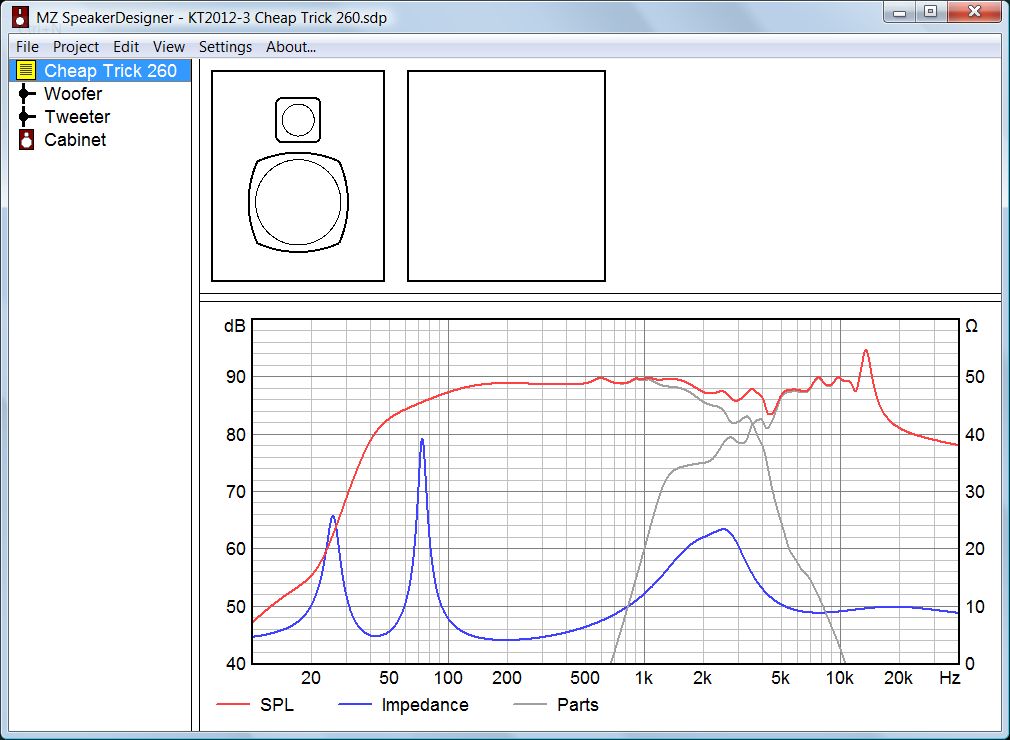

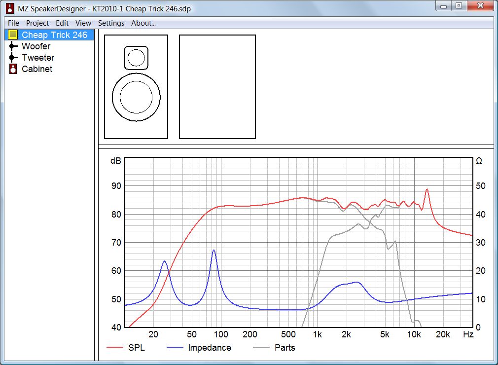

Impressive.
CC95 is the smoothest, pity it does not reach that low.
Can't you combine 260 woofer with CC95 tweeter?.
All 3 very good and reasonably efficient.
Thanks for posting.
Thanks for posting.

Problem is, such graphs don't tell anything. If the graphs are accurate, what a poor design the first 2 designs are.
If you want access to such graphs, just download the FRD and ZMA files of the drivers used. Then from the site you can easily reverse-engineer the crossover (from the technical data and the component list).
Again, such graphs tell almost nothing. But if you are familiar with the drivers then you will know more.
the graphs are as telling as the majority of data shown here in most threads. The THD data earlier in the thread shows the mission CP168 to be better than the price suggests. The Tweeters, as I said, are an unknown to me. Does this data tell you subjectively how they 'feel'? No. I agree with that, but then no measure can. Data is a means to pre-assess a measure of their sound, as in all cases. Dont understand what there is to get het up about. The CC95 looks rather good, since i have the woofs, i may have to buy the Audophon tweets and build them myself, as i am confident in the missions, having heard them. Frd and zma are not available for the missions, data is scarce other than what is here. The visatons though, different matter, it would be simple to sim to add phase, polars and sound power to the other data. FWIW i dont like the cone tweets used but polars may just redeem them. CC95 is my favourite for that reason.
What have you built with the woofers? It is not difficult to produce your own ZMA and FRD if you have the mic. Measuring your own drivers is one step above using "standard" charts. Surprisingly, many cheap products have loose QC. Two drivers may completely measured and sounded different.
If you are familiar with your stuff (such as the woofer), you will know what will happen when they are given an arbitrary filters, such as used by the CC95.
If I have drivers and want to make a speaker, first thing I do is to find all available design on the net using the drivers and try to better them. In your case, I would have been familiar with how the CC95 may sound. Most known designers will come up with similar solution because it is not difficult to model each after each and come up with similar conclusion.
- Deciding which speakers to build
