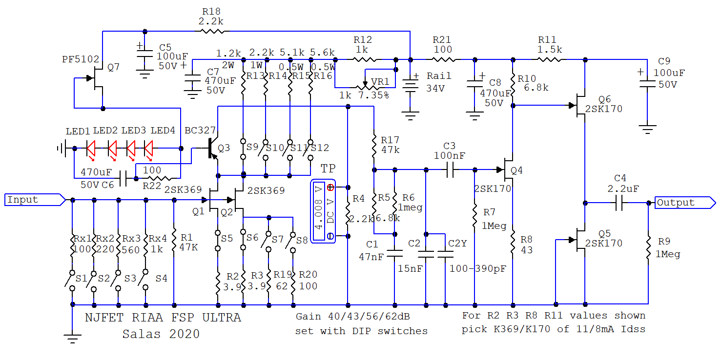

I'm looking for a decent MC phono pre in either kit form or pre assembled for med gain cratiridges. Adjustable subsonic filter would be great as would be cartridge loading. I just want something better than your typical fair op amp design. Any thoughts or ideas?
Salas Ultra. It stands toe-to-toe with any of my other phonostages, and I have quite a few. It’s absolutely wonderful. 🙂

The Salas is easy, comes as a kit, and is well supported.
Gain selections are 40/43/56/62dB made with a switch.

Here's the schematic, see the gain switches S9, S10, S11, S12.
If the switches are not on your board, just change the drain resistor.
For 43dB, it should be 2.2k.
Would 40db be a good setting for a MM cart? I'm getting started with a decent turntable with an Ortofon OM20, and want to make one good preamp that can also work well with a future MC setup.
Thank you. Can the gain be reduced any further through the correct choice of drain resistor, like DNic's unit (32db)? It looks like the OM series is rated right at 4mv (1k, 5cm/sec) and I would like a little headroom.
So less than 40dB gain?
You can set the gain as you want with the resistor value, as long as the test DC voltage across R4 is correct.
Check the thread, it should tell you the value. Also looks like you'd have to adjust VR1.
