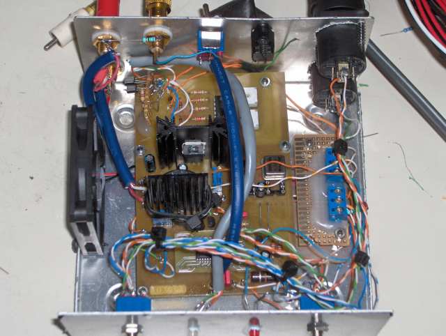

I finally installed the new trim pots and changed the cat5 cables for input - output rca. I also installed new rca that are chassis insulated. I then managed easily to configure the voltage at 8.5 volts and the dc at pin 6 and 8 to average about 3,85 volts. The noise level is very low and output voltage very high to drive any preamplifier.
I auditioned the dac only through a cheap pc loudspeaker so I cannot tell you anything special. Next week I will audition it in its proper place.
I also installed the duoled and I have one extra hole now left in the front panel. How can I use this getting some more functionality from the DAC. Can I install a led when the dac locks onto a signal. Where do I connect this led?
I have also attached a picture of my dac.
George
George
