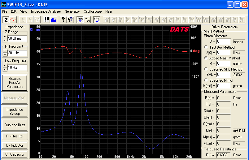

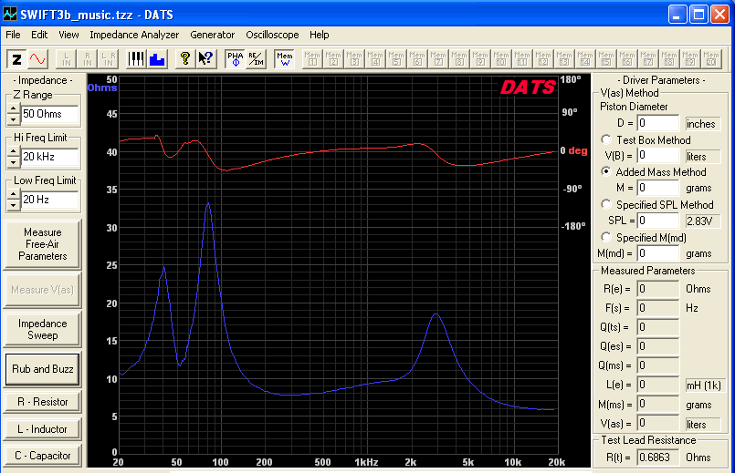

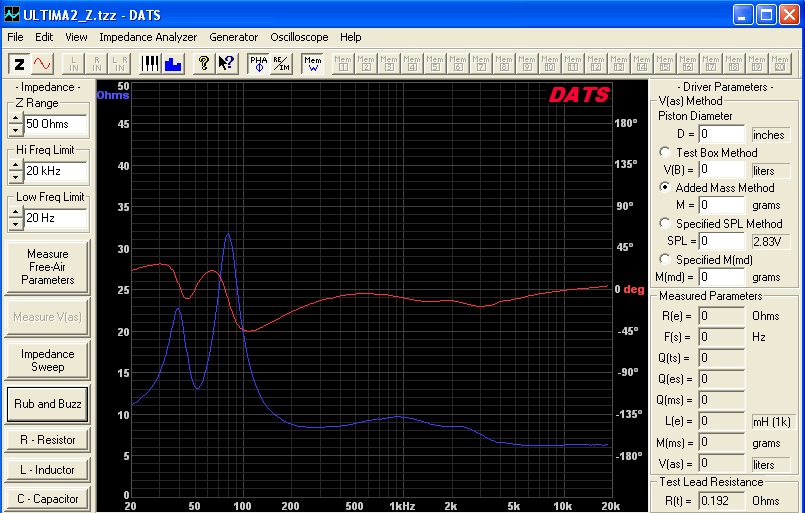

There's more to just Re.
Here are three plots of a speaker I worked on some time back. A 2-way design using ZA14 for mid-woofer and a Vifa XT25TG30-04 tweeter.
In the first plot, the impedance dips to 2 ohms at about 3K. This is a very "unfriendly" load for power amplifiers.
The next plot is much better. Lowest impedance is about 6 ohms at about 20K.
The plot on the extreme right shows less fluctuations on the impedance. More importantly is the phase. It is almost linear from 500Hz to 20KHz.
Same woofer, same tweeter but different crossovers.

Re does not indicate the lowest impedance of a loudspeaker.
It sounds wired to me. Could you please explain it more? As far as I know, to reach an impedance lower than DC resistance the speaker needs to move at least 120deg. out of phase with the source which no speaker can do. Does it have something to do with the crossover? And what is it in simple language?
When you use a meter and measure the resistance across a woofer terminals, that is your Re, the resistance of the voice coil.
Speakers are normally specified as a nominal impedance. What that loosely mean is like average. To see how demanding a speaker is for a power amp, do an impedance sweep.
In the three impedance plots of the same speaker I showed above, you can see how the impedance changes with different crossovers. It is these impedance and phase that affect power amplifiers.
