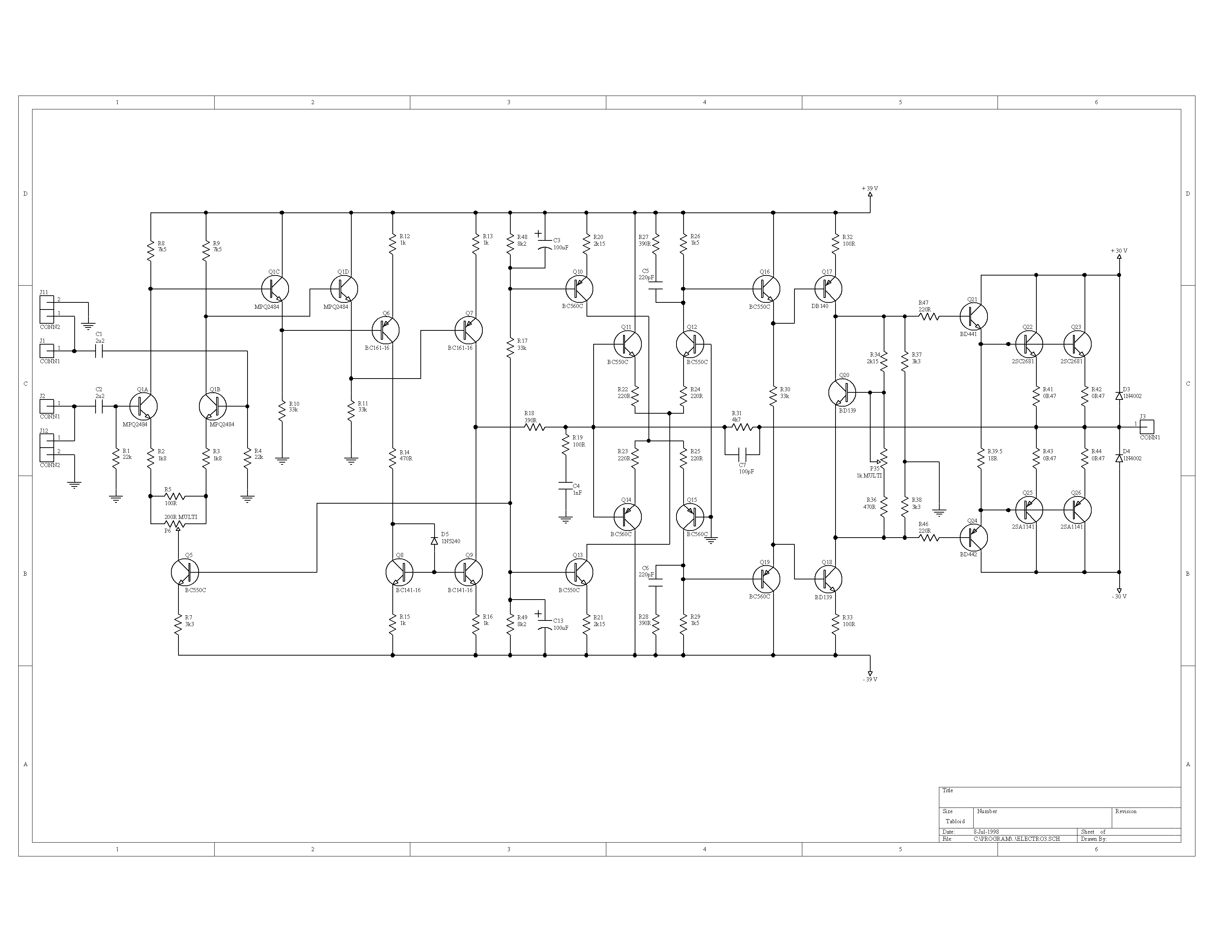

Dc offset can't be nulled on one side of an Electrocompaniet AWII. If I load the input with a 100K resistor, I can do it. I thought replacing R5 with 200 ohms to have more range with the pot. Here is the front end schematic. There was a service bulletin with upgrades that have been done. C1 and R4 are now replaced with a jumper. C2 is replaced with 1K resistor. Thanks
