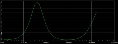

Attached is what a typical speaker impedance plot looks like. Because of resonant effects the lower end has a much higher impedance than the nominal impedance through the midrange. In practice full bass extension can be achieved with smaller capacitance than what is calculated for nominal impedance.
