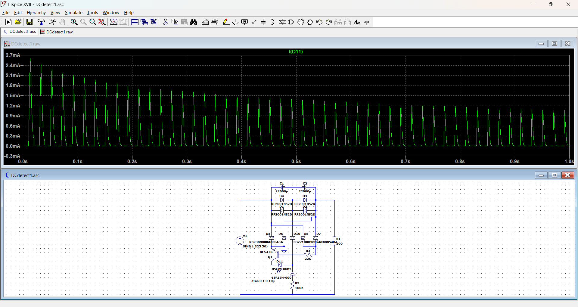

It should be OK. I am less sure about the big schottky's: they tend to have a large leakage. I'll try to simulate them in a realistic manner.
If the drop of the bridge is too small for detection, the solution could be the two-transistor alternative, or a prebias of the single transistor.
I am going to think about that, and test options with sims

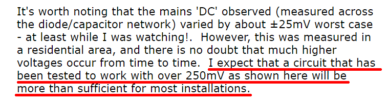

Naturally, readers will wonder whether the LEDs light up when the amount of DC present on the mains is "only" 249 mV [for 230VAC mains] or 124 mV [for 115VAC mains]. Numbers I extracted from Rod Elliott's article on Mains DC Blockers, posted on his Elliott Sound Products website.

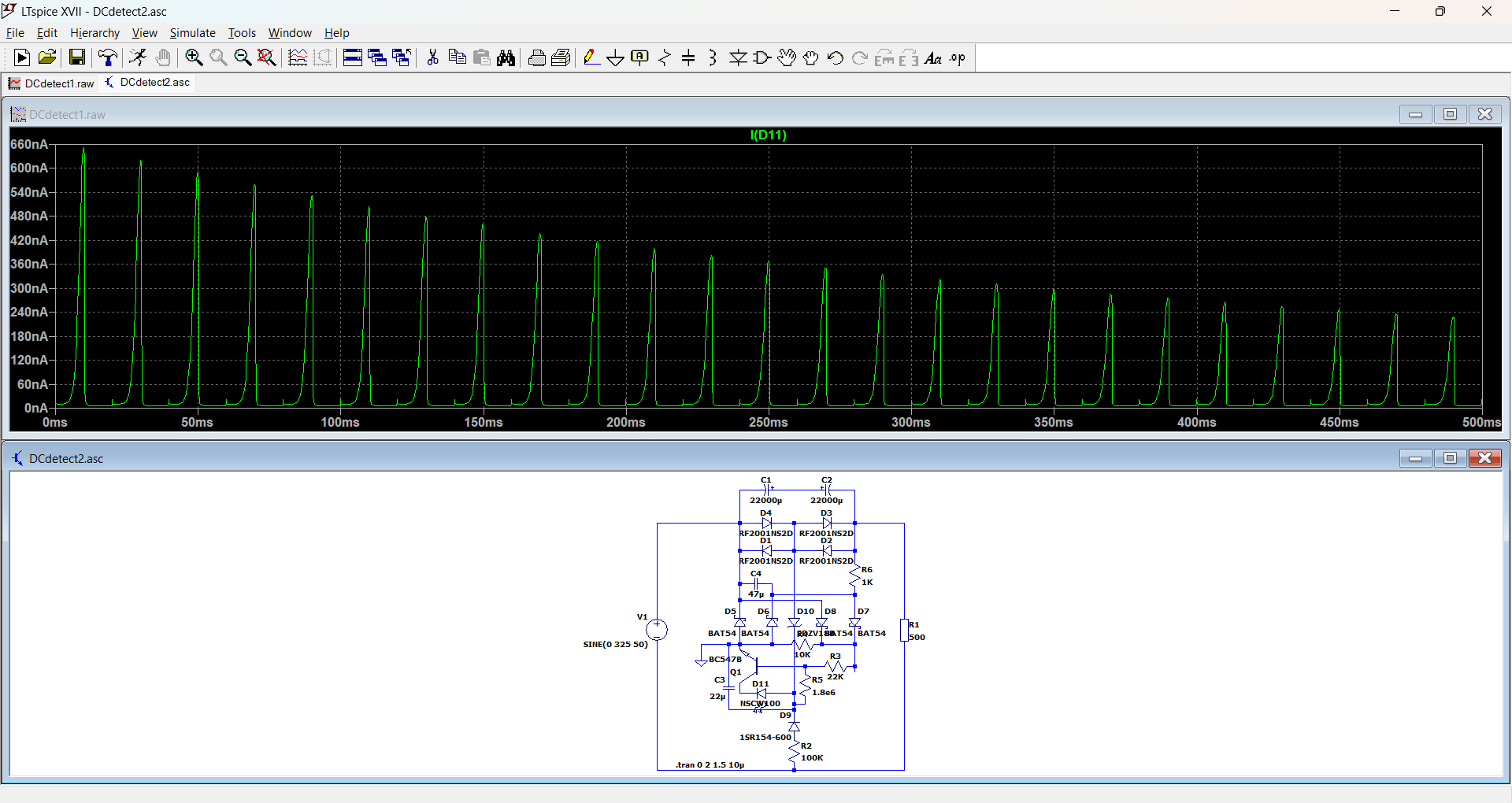

With the RBR30N40 of LTspice, the circuit still works, and provides a larger indication current:

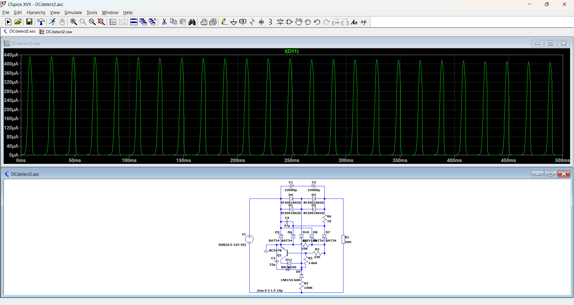

Here is a tentative of prebias, to improve the sensitivity. A number of filters becomes necessary, to avoid an indication with just the 50Hz residue across the caps.
It is a first, clumsy attempt, and it could certainly be streamlined.
This is the LED current with no DC offset:
And this is the same with 0.5V DC offset:

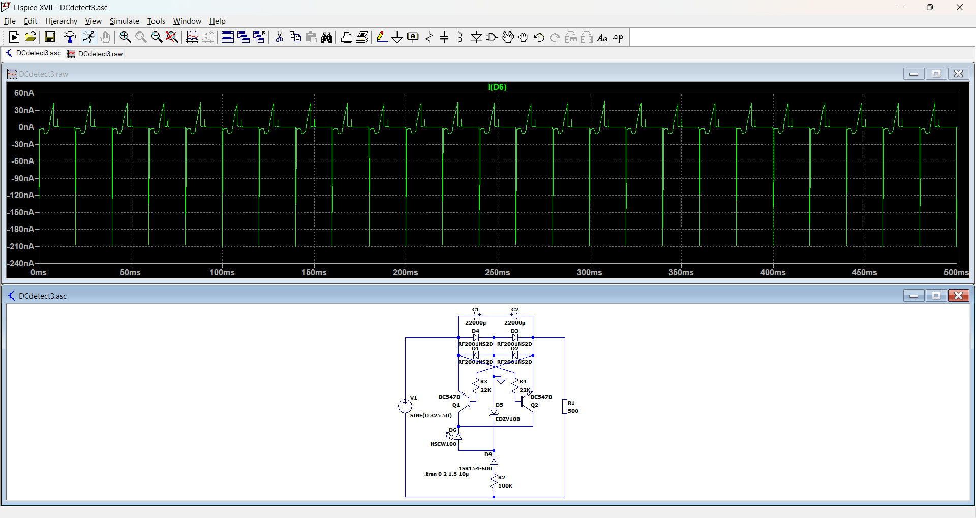

Here is the 2Q without offset:

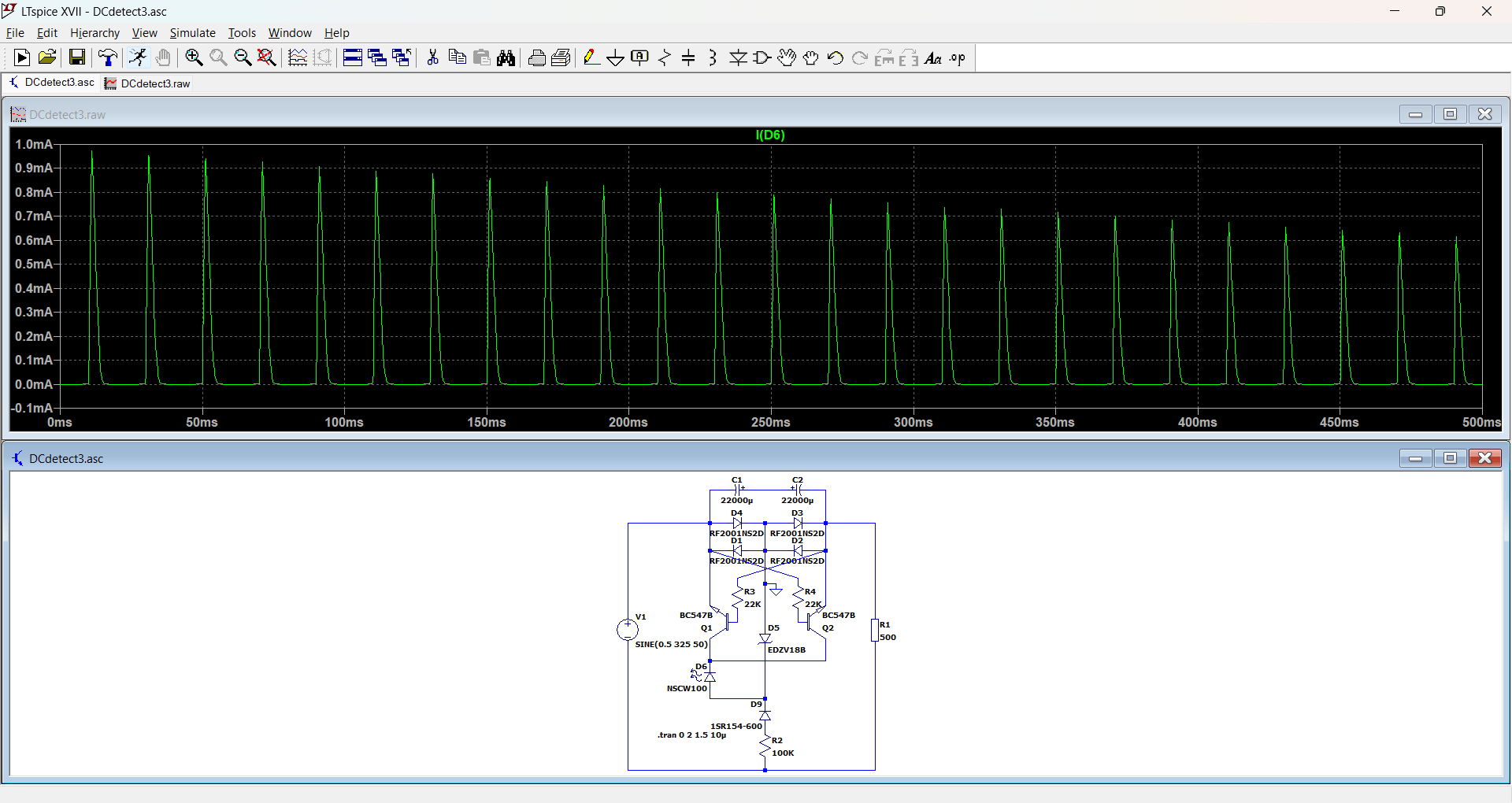

Now with 0.5V offset:
This is without any prebias, meaning it is more tolerant.
A prebias could also be added if required, more simply than for the previous one.
Note that the sims are kind of worst case: pure resistive load.
With a transformer primary, the DC load resistance would be much lower, meaning the totality of the offset would find itself across the diodes, and would be more easily detectable.
Many other variations based on these circuits would be possible, depending on the needs and requirements
