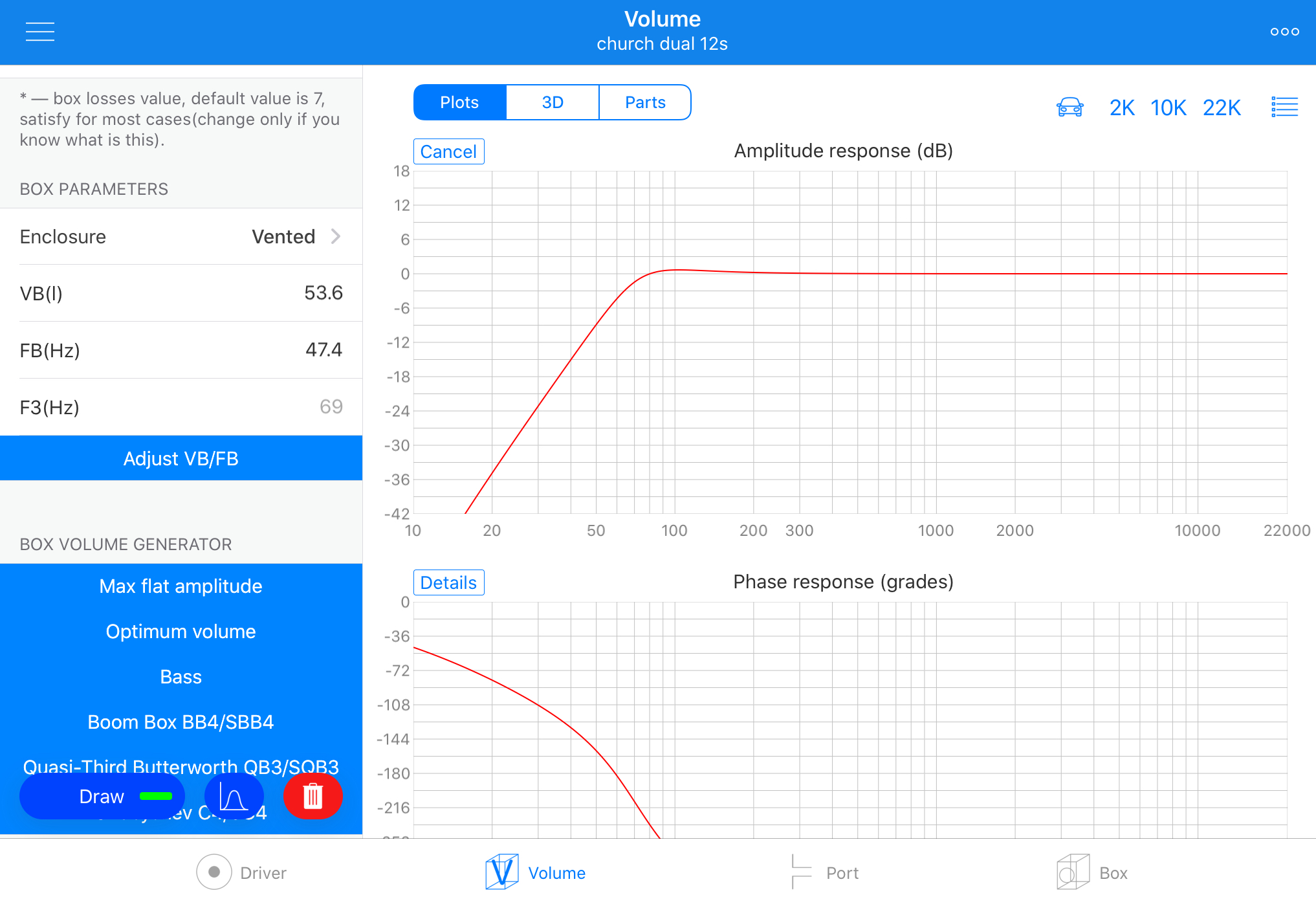

I am starting a project with two 12” and a 2” compression driver. The Dayton PA310-8 fits the goals I have, in a really small enclosure. I am using the Speaker Box Lite app, and it recommends a 53 liter (1.9cu ft) box tuned to 47Hz. (All I need is extension to 70Hz) for TWO 12” drivers sharing the box space.
Before I make a purchase, I wanted to verify with anyone familiar with this driver, that the specs are reliable.
Again, that’s 2 drivers sharing a 1.9 cubic foot box.
