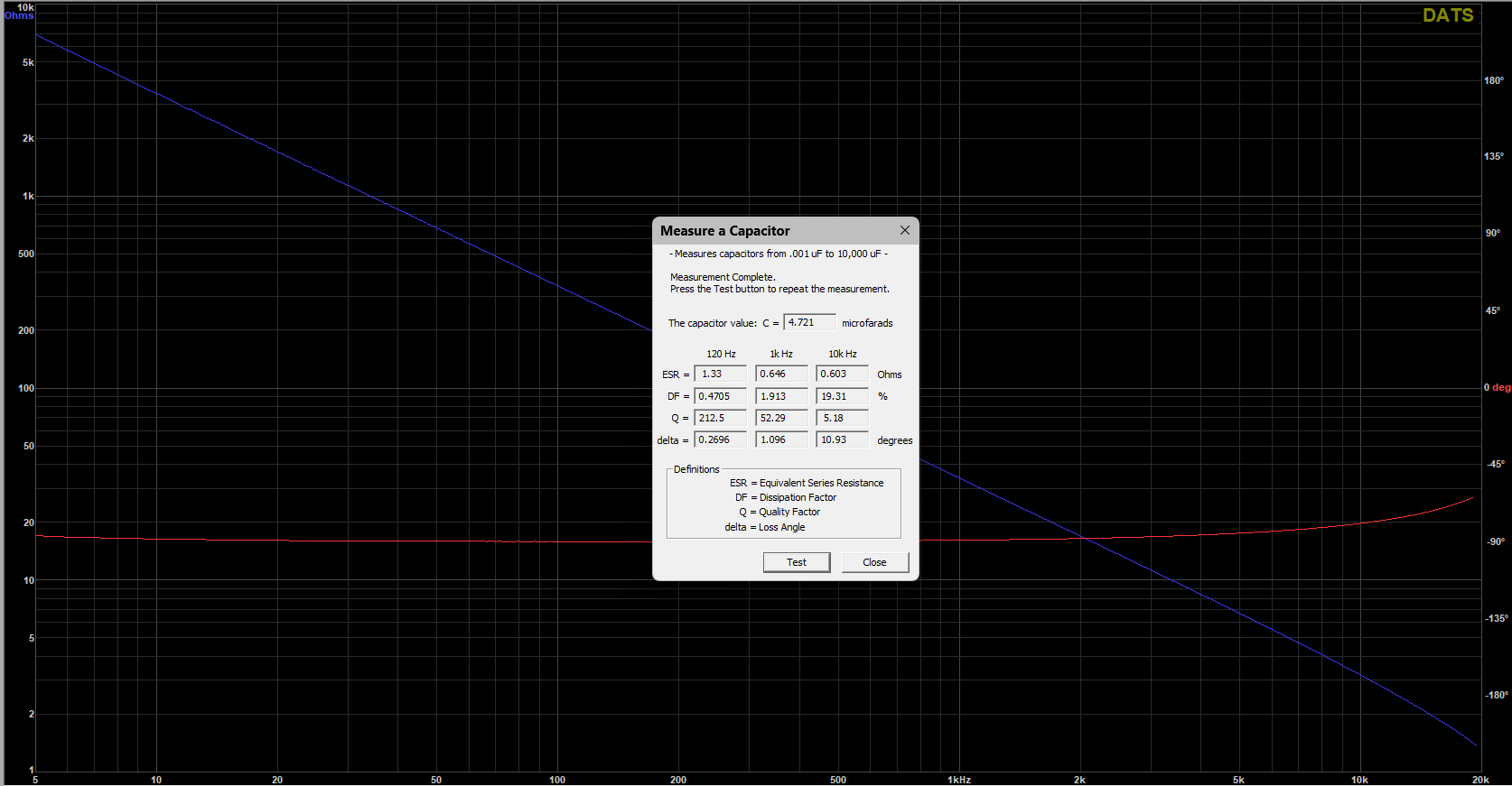

I purchased DATS 3 because I have to measure the parasitic components of capacitors and other components.
I noticed that the ESR measurement of the capacitors is always around high values and always similar to the test frequency of 120Hz (to give an example of frequency).
I would like to point out that I am measuring capacitors like Mundorf Supreme! and all of the same value!
I would like to share my experience with you, have you also encountered this problem with the same type of capacitors as mine?
Is there a truly reliable instrument that gives certain and repeatable values?
In fact, if I measure a capacitor 3 times it always gives me very little different values but all the measured parameters are different.
I wonder, is the much-vaunted DATS really reliable and with repeatable results?
As for the capacitors, I don't think so.

If you simply break it down DATS is an external soundcardchip with usb and probes. The V3 got an internal resistor for calibration reasons. In the end it's more meant for validation than precise measurement.
If you need the real ESR you need a Wheatstone measurement bridge from Peak or Hameg or whatever suits your pocketmoney. For audio application especially crossover parts the dats works super easy and is a no-brainer.
If you expect results comparable to lab equipment you need to create a lab environment with measurements under lab conditions.
Else do it as taught ongoing electricians - repeat the same measurement of a component and take the mean value 😏

Most of the shops I know are German based so best would be to search for LCR meter - simple ones are around 35-50$ and dedicated equipment only for inductance, caps and resistance some even for diodes. Those won't give you the ESR in a proper way. I assume something like the PeakTech 2170 – LCR-Meter does the trick and is a dedicated tool only for this task. I suspect to get precise measurements from this one.
Dats is a tool that is measuring the voltage behaviour on the input and compares it to the output on a time basis - like an oscilloscope.
Based on the information it calculates the results which may vary.
The tolerance need to be in a narrow band or else two things happened:
1) the calibration especially with the probes is off and needs to be redone
2) the object changes drastically and is more on the broken than the reliable side and should be replaced
If not already done perform the calibration again to ensure the DATS ain't rolling the dice due to wrong reference data.
Get a brand new cap of any type and do the measurements, if the tolerance is just in the smaller digits, forget about it.
I would be interested in the values you get out of DATS from a cap to get a feeling what we are talking about.

how to calibrate DATS ?
after this probably i could write you more precise values, because i have never done the calibration
It's just a guess but without the calibration the DATS is really far off from a reliable measurement tool 🤓
I hope I gave you the right hint and the situation improves immediately after the very quick and easy process.

after calibration the results are more stable, the doubt is why regarding the value of my tests (4.7uF) are the results identical even for significantly different brands, construction types and voltages?
The images are looking promising and gladly the situation is now as expected.

I found some info in my formular books that might help. The used frequencies are standardized as following:
120 Hz are used for electrolyte caps and for other cap types with C > 10uF
1 kHz and/or 10 kHz for small caps 1 nF ≤ C ≤ 10 µF
I would simply go with the ESR of 1kHz because this is the more interesting frequency area if we are talking about the mid-/highrange crossover point.
The 10kHz can be interesting if you have an application for a super tweeter but usually the ESR values are close between 1 & 10kHz and are better than the tolerances of the speaker in the end 😉
There are resistance losses that are due to frequency, temperature and a part is surely a time related.
If you still hesitating with the accuracy of the measurements than as mentioned before redo the measurement a couple of times with everything untouched and note the values in a table.
There will be variations but they should be minor.
