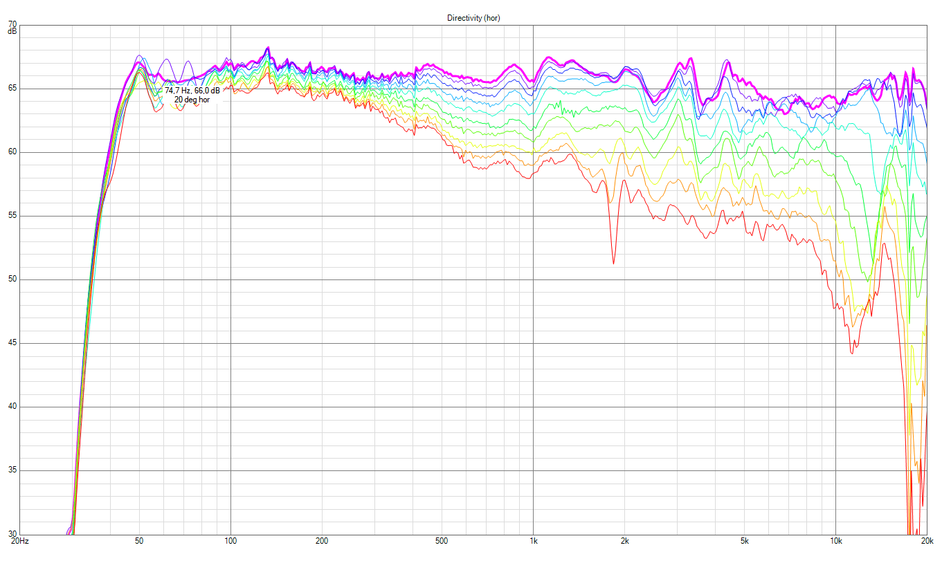

And yeah, I agree, my latest speaker from a few years ago sounds awesome, it's the best sounding speaker I've made this far, specially due to the care there is on the DSP design, but without holding back, it sucks off axis, which for it's purpose is no good since it's a speaker I and others listen never on axis and always from moving locations
Its really noticeable when listening to it and moving around even at less than 45° off axis
I've set as a challenge to myself to make a new one much improved all around, the bass section is solved already, but the making it sound good off-axis not yet
This is the response from 0° to 90°
And this is the speaker is question
