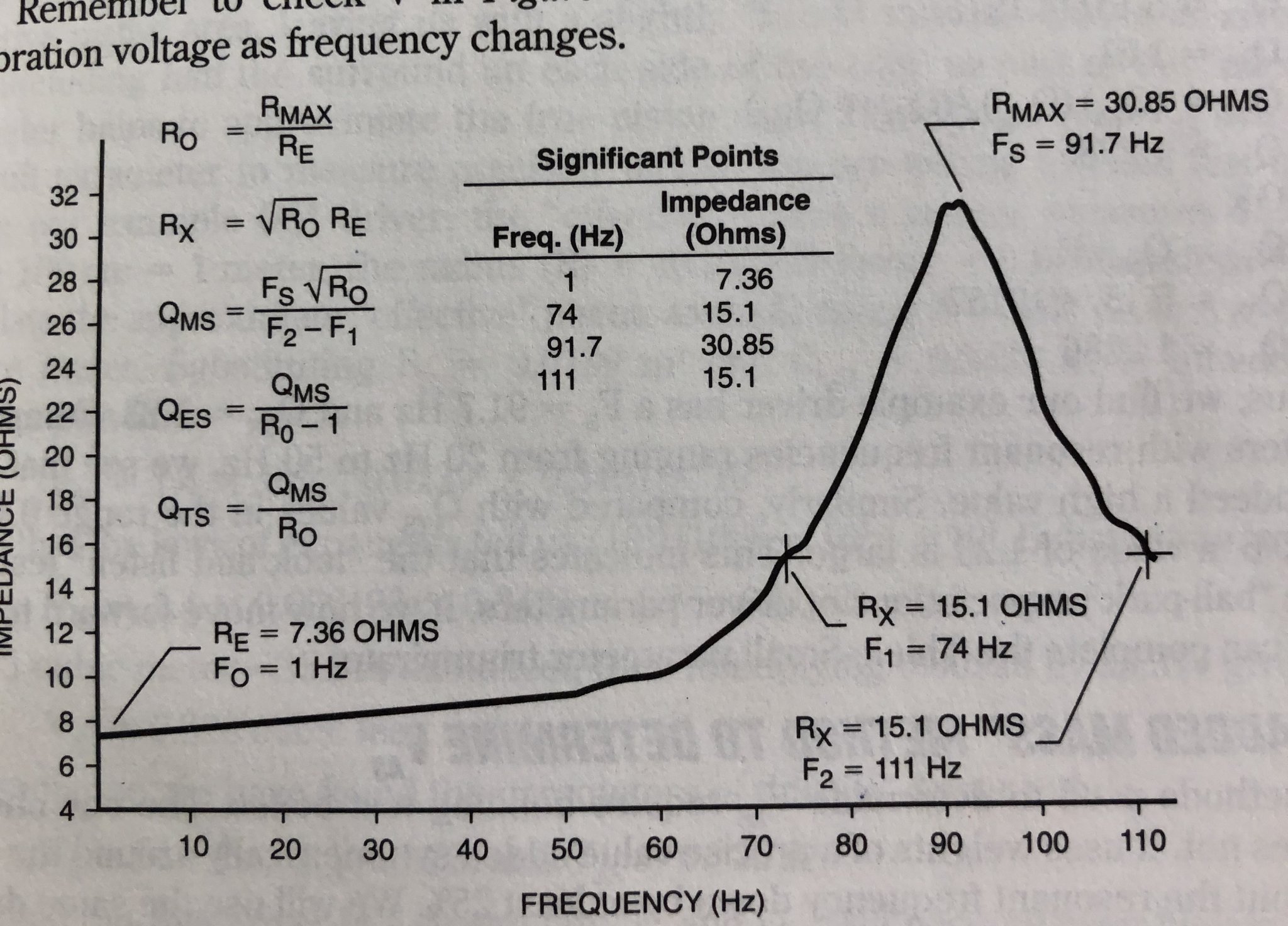

An old Radio Shack book has the same equations as the scan speak webpage but presented in a different way which may be a little clearer. It shows how to calculate Qts and how the DCR directly influences the result.
To me it is of interest to better understand how to measure T/S parameters. Thus, I went back to do measurements of the Scan speak W21/8555-01 woofer. DATS gives an Re of 6.2 Ohm. Using a multi-meter, Re is in fact 5.7 Ohm, which is the same as the published spec. By using the formulas from the DATS documentation (similar to formulas given in your post), I managed to manually calculate the T/S parameters presented by DATS. Now, if I adjust Re to 5.7 Ohm (instead of using Re = 6.2 Ohm), Qtc reduces to around 0.33 (down from approx. 0.37. Note that the published spec is Qts = 0.26). If, in addition, I use the published spec for Fs = 19 Hz, Qts gets close to 0.30. Also, usage over time may lead to a Qts-value closer to the published spec.
