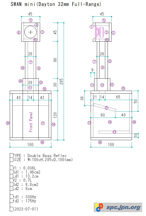

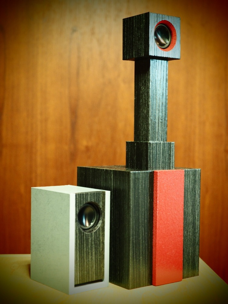

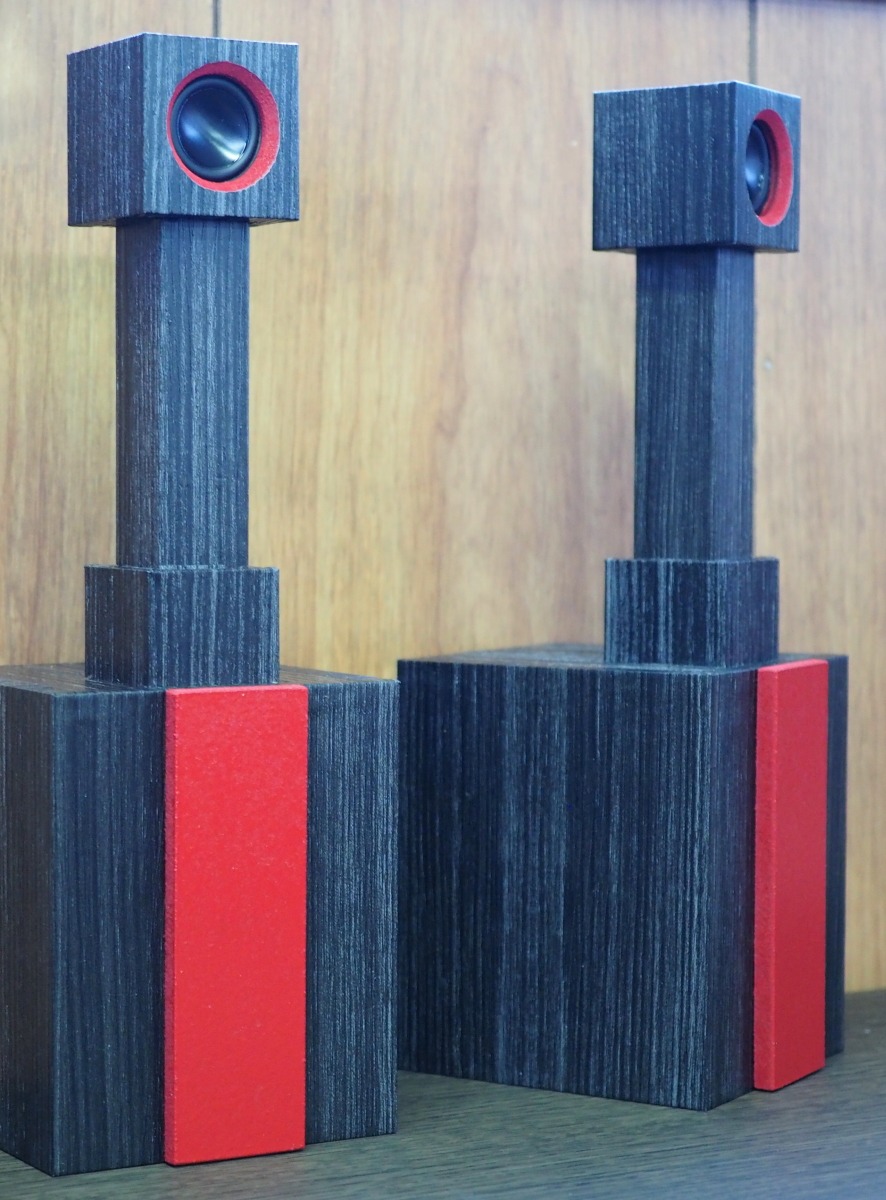

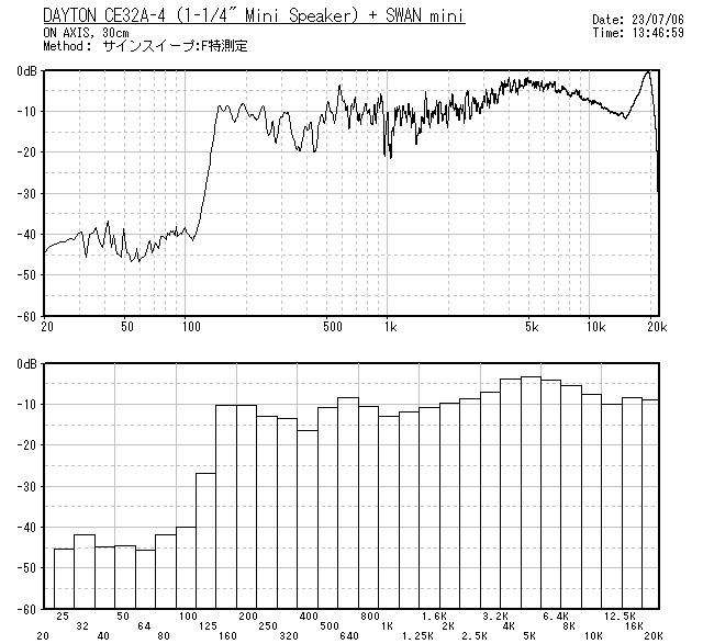

I installed the Dayton Audio CE32A-4 in a mini-sized bass reflex enclosure.
The finish is vinyl sheet.
It doesn't produce low frequencies, but it delivers a lovely female vocal performance.
Truly the "Songstress of the Dwarf Kingdom."
It may not be considered a full-range speaker, but it is sufficient to enjoy on its own.

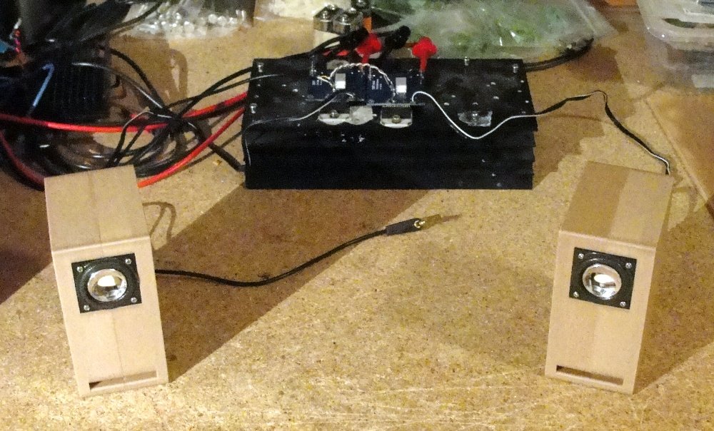

nandappe, thank you. Great project to work on with the grand children! (got some foam core sheets👍)
Any dampening materials needed?
I used felt wool 0.3 gram.
The places to stick are parts 4 and 5.
If you use foam core sheets for the box, I don't think sound-absorbing material is necessary, but I don't recommend foam core sheets.
I used them several times for verification, but they only produced cheap sound.
Thanks. The foam core sheets box will be used as a teaching moment for the grand kids. I will make a pair out of wood also.
