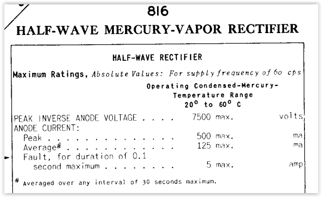

Provided that the tubes are not defective, arc-over or flashing in a MV rectifier is a design problem which should be corrected. Application of the plate voltage must be delayed but maybe the warmup time of most damper diodes in not sufficient to allow full vaporization of the mercury. It is also possible that some other maximum ratings (peak current...) are exceeded. And if you need to use damper diode tubes ahead of the M.V rectifiers to delay plate voltage I don't understand why you still need the M.V tubes in the circuit. This seems an unnecessarily complex way to accomplish a simple task (rectification). Maybe you could post your circuit so we can have a clearer picture and help you more efficiently.

I tried some other tubes in my stash and it looks like it may have been a defective tube, even though it was new. I gave it a 10 minute warmup before I applied any HT.
I built a hybrid bridge with two 816s and two UF4007 diodes. It's choke input (5Hy) and has two stages of 100uF electrolytic with the second stage being RC.
I haven't really drawn a schematic, just wired it on my bench to prove the concept would work. It's overkill for what I'm building, but the customer wanted MV tubes for the blue glow, so that's what I plan to give him.
I'm building a hybrid bridge with two 816s and two UF4007 diodes. I'm using the damper diode with the cathode wired to the power transformer center tap and the anode grounded. I've done this with 6D22S dampers before and it worked well with 866As. I want to use an octal ST shaped tube with this design.
My voltages are comparatively low, only about 210VDC, so I don't think I'm exceeding the 816's specifications
