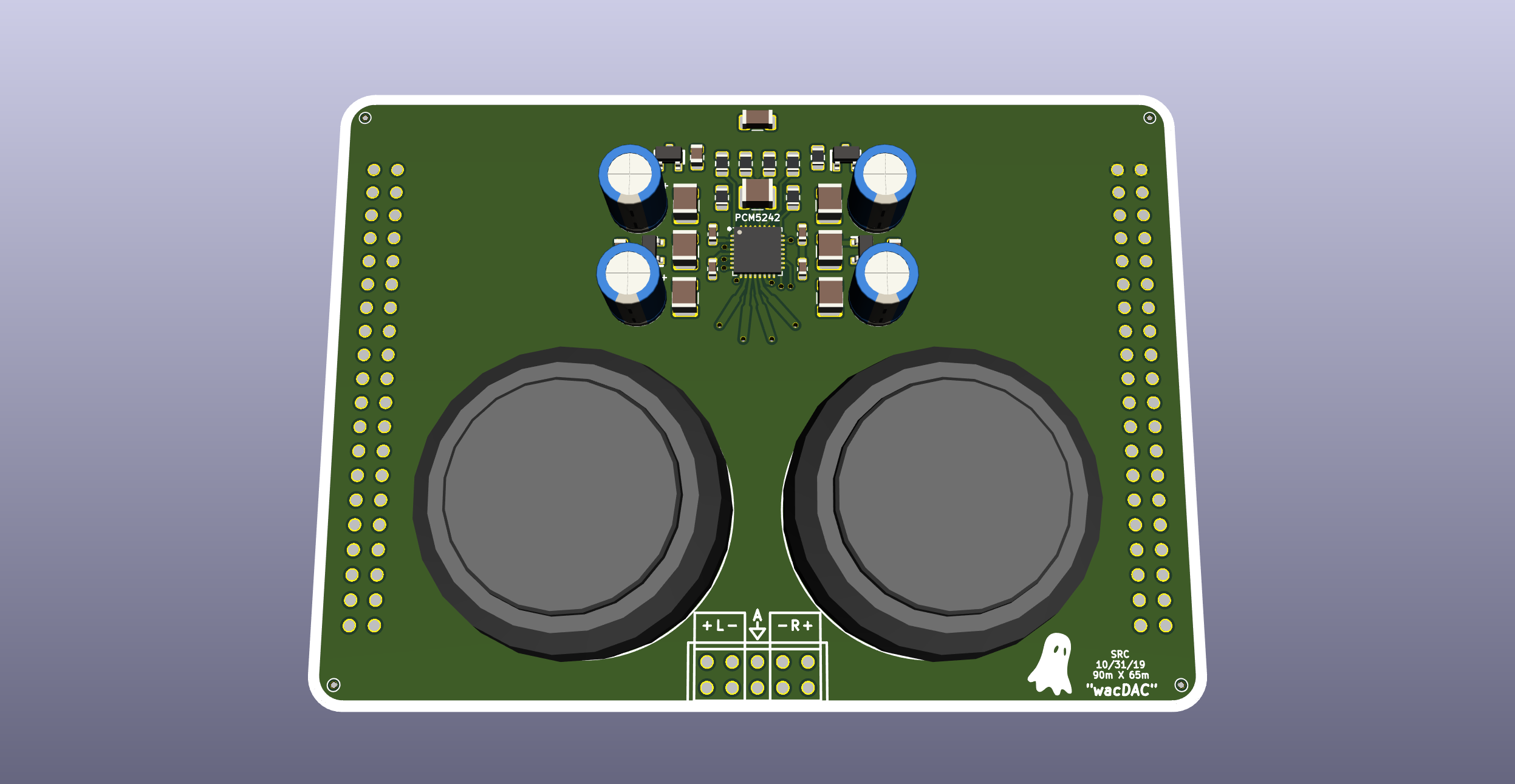

In the time between different parts of my projects, I've gone from PCM5122 to PCM5242 and will be looking into the PCM5252 before long.. Mine are RPi based and they are simple to piggyback on drivers. In the not too distant future, I'll be digging deeper and will most likely be having some driver work done for me for custom performances. Recently finished a beta on my all-in-one DAC& and will be using the same design in a stand alone DAC chassis that includes UPS and other goodies. One feature that I require in my DAC is hardware volume, and I havent delved enough into other chips yet to see whats available due to time constraints, but soon! Some DAC are finicky and I started easy and have been satisfied for the year+ performance so far.
S
Edit: Added image
S
Edit: Added image
