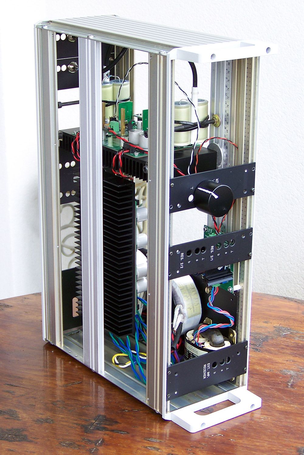

You mean the modular chassis?
Yes, it's a nice construction method.
It's a former line of Schroff's cases, they still offer good stuff, e.g. Ratiopac PRO | Schroff | Europe, Moyen-Orient, Afrique et Inde | Pentair.
As I've saved several one (and other cases) from trash. I've also built my amp in, http://www.diyaudio.com/forums/class-d/87913-class-amp-photo-gallery-119.html#post4811949 , and still got one left as they come handy to customize. And as a perk all my builds looks the same =)
