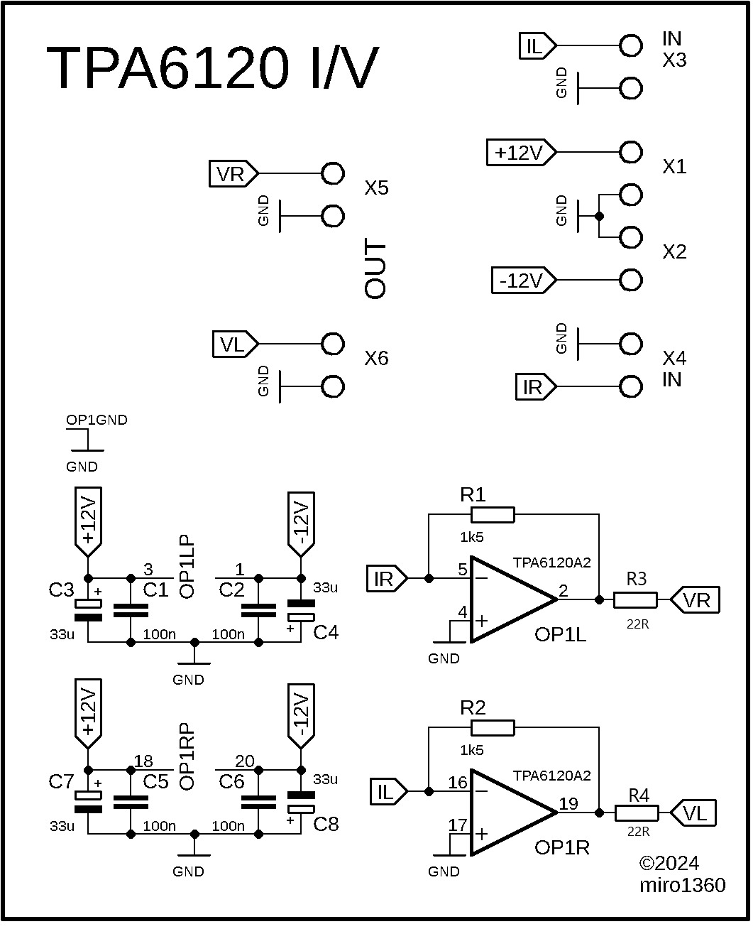

I wouldn't play with that. I experienced an explosion of four lateral mosfet just because of similar things, it was not pleasant. It's one thing when you're working for yourself or testing, but when it goes public, it must be safe. I wouldn't like to be in your shoes if someone's tweeters or amplifier burn out due to the lack of two resistors in the circuit 😉 .@grunf I am testing this TPA I/V for 8 years, from 2016, in different configurations 😊
each is responsible to use the diy circuitries here at his own risk, it is not the responsability of the designer, if you want guaranty, go in shops with legal guaranties, but it is fair to repeat it is at your own risk and of course to be prudent (the diyer can be injured too). Anyway, better to follow the datasheets, the ic designers know more than the people whom use them.
Yes in LTspice, but how will it behave in another environment, with another power supply or stage behind I/V. AD811 is also very stable in LTspice, but the reality is something else.@grunf You can simulate TPA6120 in ltspice using model THS6012, including parasitistic capacitances and inductances ... it is very stable 🙂

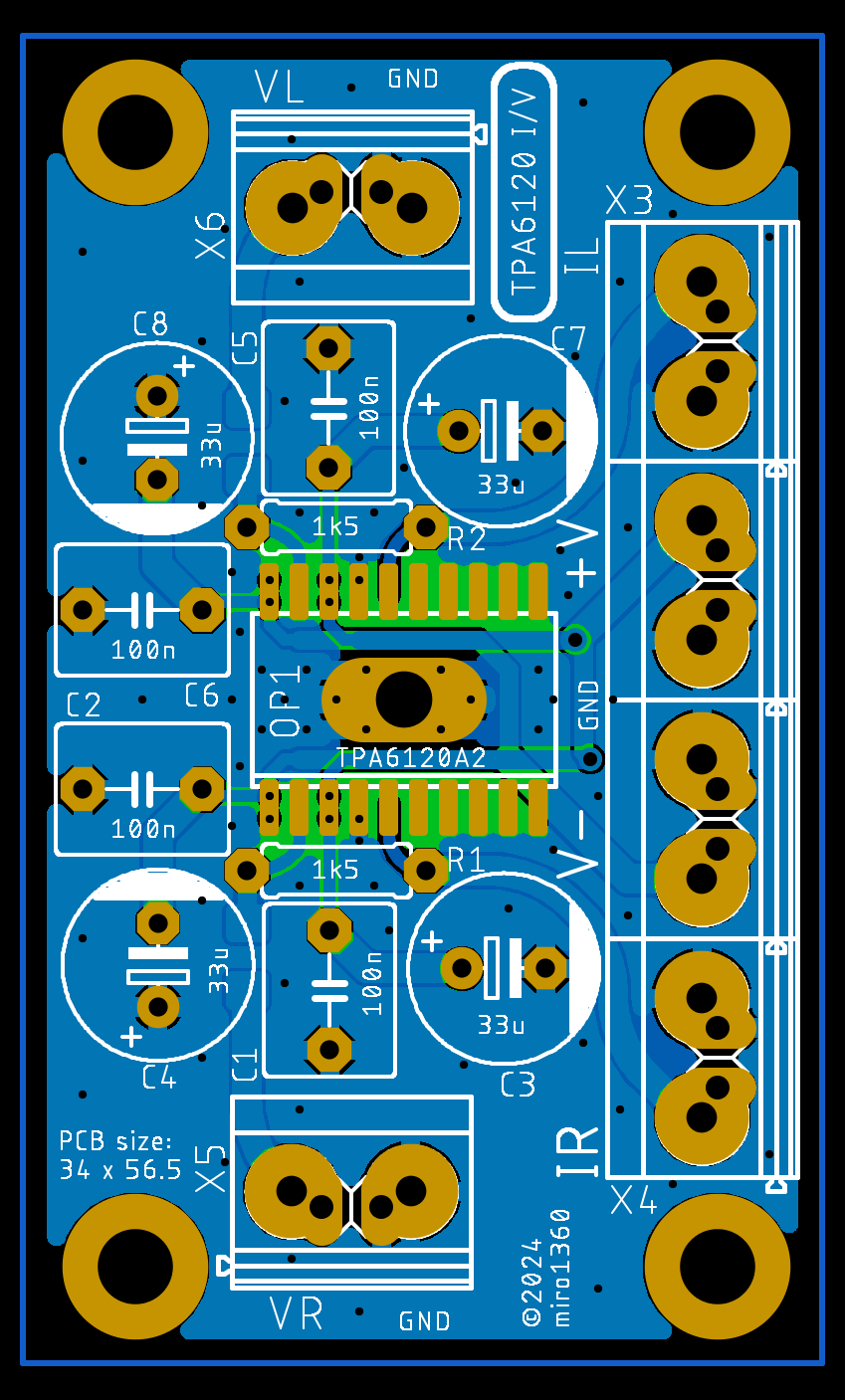

I/V based on TPA6120
edited post #9463 (added R3, R4 on the output signal, hole in the GND under the feedback trace)
Power supply range is from +-5V up to +-15V. It can be powered directly from DAC PSU.
R1 and R2 value determines the output voltage. For a higher output voltage use higher value of this resistor (1k5 == 1.5Vp, 2k7 == 2.7Vp, ...).
R3 and R4 resistors melf 0204 or SMD1206, value 22R up to 100R.
Capacitors are polypropylene and a high quality electrolytics (UKW from Nichicon is still available).
There is hole in thermal pad under the IC, where you solder the IC with PCB from the bottom.
IL, IR is current input from DAC.
VL, VR is voltage output.
Note, that a small (not harmful) DC offset may be present in the voltage output.
This is redesigned PCB and so far not tested.

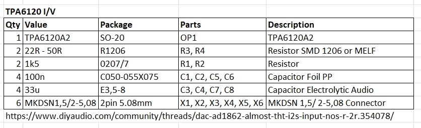

BOM example: https://mouser.com/ProjectManager/ProjectDetail.aspx?AccessID=5ca5f6fb0b
