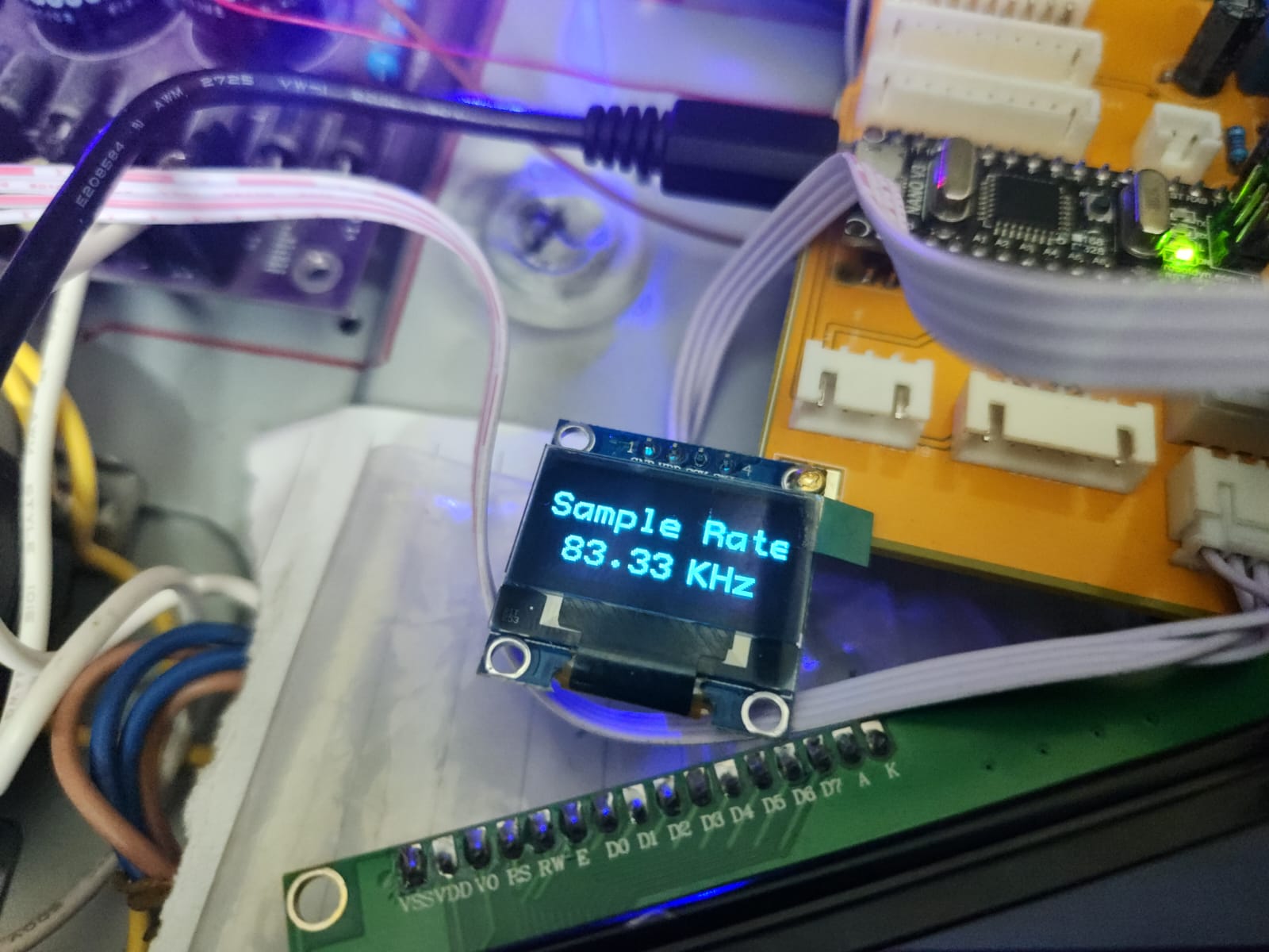

Thanks miro1360, gave the code a try myself, used ssd1306 I2C and here is the result.
I realized some errors in the code in the sense that LRCLK carries stereo signal instead of single channel, therefore it had to be adjusted.
HD44780 20x4 LCD will be the same, slight changes from the last code instead of Hz the code is now calculated in KHz and displayed as such, since I am out of time this weekend so I leave further tweaking to the DIY community. I guess as POC it works.
Here is the modified code for SSD1306 I2C oled.

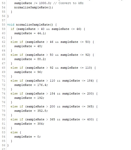

Thanks @miro1360 I was experimenting with the code before I embarked on yet another 10 days travels, was trying to normalize the code as you suggested, with something like this one, but will be able to give it a try next weekend.@rehanabid It looks very good 👍
You can add a code for normalizing the sample rate:
last upload to arduino did not resolve the underlying issue, will try your approach of adding another function "normalize Bit Rate", I am sure it will work. Thanks for the continued help to the DIY community and lazy people like me. Once I am done with this part, I think the next logical solution is to develop this one to have IR capability of signal switching by replacing the toggle switch and a display of input between (USB, Coaxial/optical, and bluetooth)

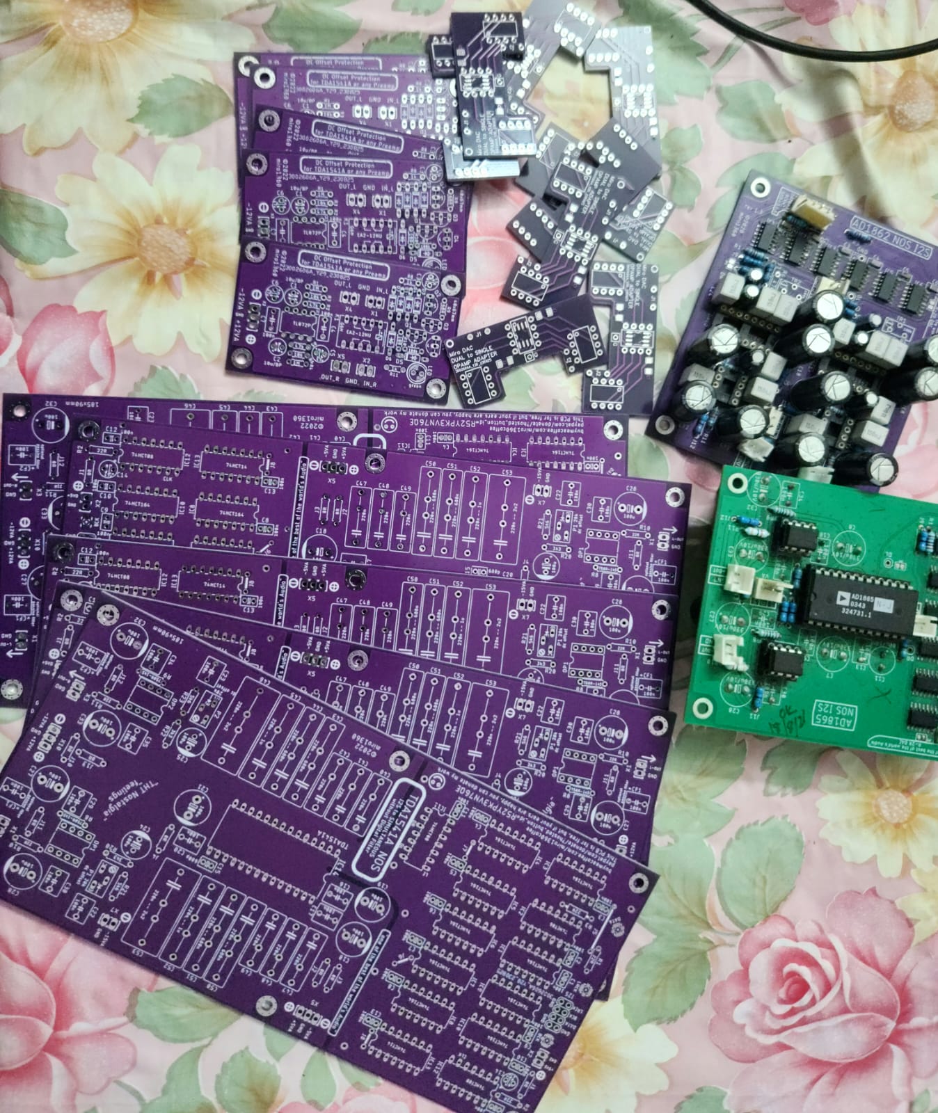

Dear all,
I am giving away two bare PCBs of miro1360 TDA1541 DAC free of cost to anyone on the basis of first come first served with following conditions:
- Interested person drop me a PM.
- Only 1 PCB per person.
- Interested person to pay shipping charges depending upon the country they vary from $10 flat to $15 flat via regular post
- Tracking ID will be provided once the board is shipped, the tracking ID is valid till the board reaches your local post office.
- I am usually traveling locally/Internationally so shipping can be delayed by a few days till the time I get back home.

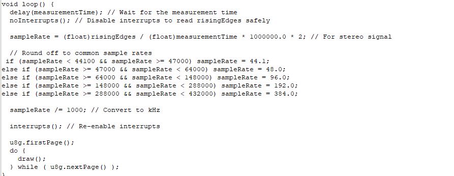

@rehanabid, in your post #7390, did you notice in the "if..." line, you have the "44100" and "47000" values reversed with each other. As it stands, the condition of that line will never be true.

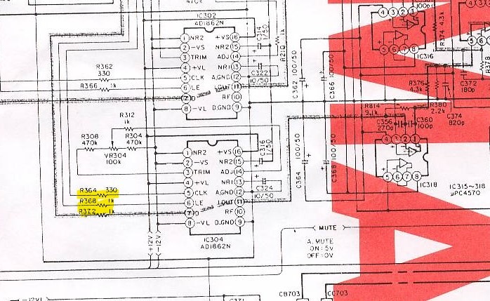

Is it beneficial to add resistors right before the digital inputs of the AD1862? I notice Denon does this in the DCD2560.
330R and 1K are the values.
Regard
In my perspective those resistors are added to reduce ringing following signal transitions (rising and falling edges), due to parasitic capacitive and inductive effects (which cause transmission line impedance mismatch), the higher the R value the lower the overshoot (or undershoot). There is, however, a drawback, since the digital inputs typically also present some capacitance, the slope in the transistions can be decreased if the value is set too high (typically over 1 k). The best way is to check this effect with an oscilloscope.
In some cases the resistors can be omitted and the system works fine, in others the ringing is too high for adequate operation (i.e. the system will assume ringing as signal transitions).
