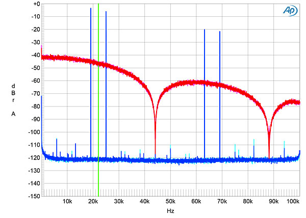

Like this example of a NOS DAC, the well regarded Holo May measured by JA (bless him), with IMD from high frequencies mirrored around 22.05kHz and folding back into the midrange:
HoloAudio May, NOS mode, wideband spectrum of white noise at –4dBFS (left channel red, right magenta) and 19.1kHz tone at 0dBFS (left blue, right cyan) into 100k ohms with data sampled at 44.1kHz (20dB/vertical div.).
https://www.stereophile.com/content/holoaudio-may-level-3-da-processor-measurements
This is an extreme torture test with a full dB 19.1kHz tone. The 44.1kHz sample rate creates a ~6kHz IMD clearly visible above. But its >100dB down. I doubt anyone could hear that in normal playback.
To make things even less of a concern for NOS lovers, most files I have are -50dB down over 15kHz. I would speculate that even if a DIY NOS DAC measures much worse then a Holo, with say 30dB worse IMD so what? With most tracks the IMD's from aliasing IMD products will still be -120dB and lost in the noise floor.
I cant see a happy NOS user being worried by IMD folding down into the audible band when its inaudible.
I still think OS with a great filter has the potential to markedly improve listening enjoyment. Anyone?

Nice post. JA's chart captures the effect which I believe Zoran is alluding to. My take, on what we see is that the 6kHz IMD spur isn't fundamentally due to the sampling process or to the DAC image frequencies being present. It's an artifact of the IMD generated within the DAC's own analog stages. That chart showing a 19.1kHz test tone inter-modulating with it's 25kHz image tone within the DAC's analog stages.That definitely happens.
(44.1kHz - 19.1kHz) = 25kHz image
(25kHz - 19.1kHz) = 5.9kHz IMD spur
If analog stages were so linear as to not exhibit IMD, there would be no 5.9kHz spur, despite the 25kHz image frequency being present. At least, that's what I read Atkinson's chart as appearing to show.

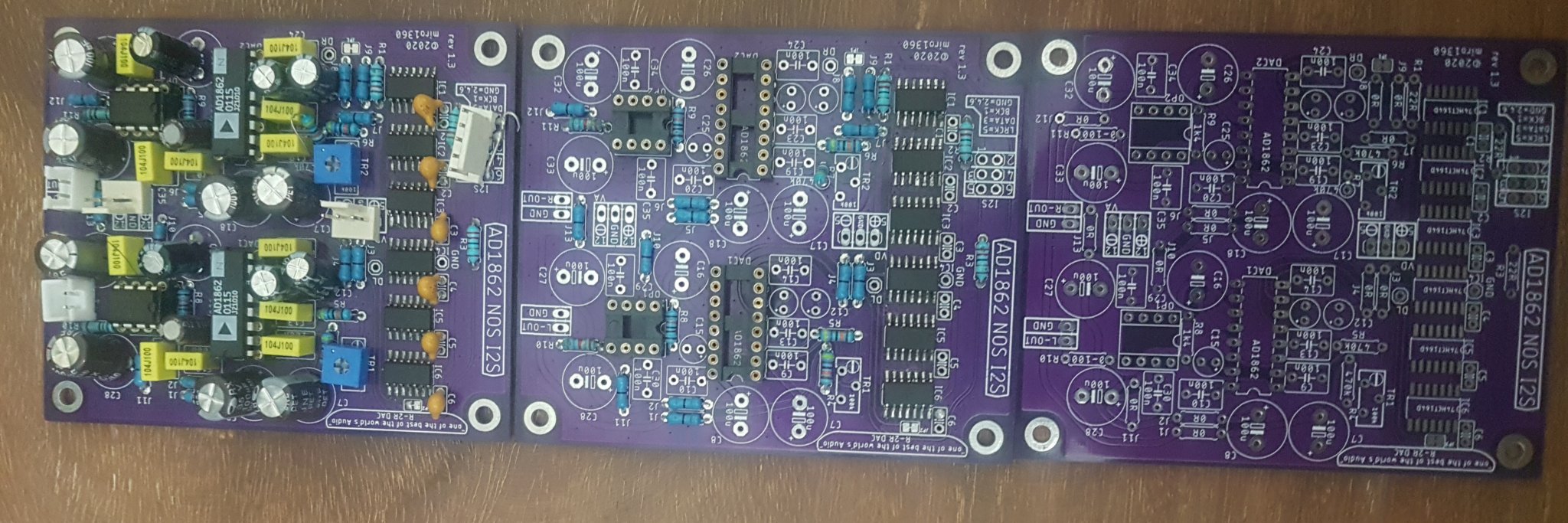

Finally got time enough to complete AD1862 DAC, chips courtesy @Paddy Garcia (who is a genuinely honest and patient guy, informed me that the chips he dispatched to my address were delivered back to him. He posted them again and thankfully received them)
PCBs were made from JLCPCB with a purple solder mask. For PSU I used the 7805/7905/7812/7912 version, I have had enough with LT1963/3015 version.
the IV stage is standard OPA627/AD797, the final version will use OPA627AM or BM version (found the nasty buggers rotting in a small box in my lab).
USB interface was generic XMOS (chinese source) and the input was from RPi 4B (4GB version) having operating system of LibreElec, and the audio files were both FLAC and MP3s.
Amplifier's were Yamaha A1000 and Lo.D HMA-6590 (both have been completely recapped by me in the past)
First impression of the AD1862 sound was crisp, sharp and pleasant to my ears. Although I have enough test equipment to measure noise characters but I don't indulge with the esoterics.
After listening for a few hours I changed the DAC to AD1865N with the same USB/Input/AMP setup, what really surprised me was that even AD1865 performed much better than the previous experience. So I went on to test the RPi based input with other DACs like AKM4490, ES9038Q2M and ES9038Pro, TDA1541 and PCM63. Every DAC sounded better than before. I will share the picture tomorrow (hopefully).
I Understand @Vunce uses RPi as input source for his DAC. Next stage I tried to use the DAC directly interfaced with RPi over the I2S (required some ssh editing to include RPi DAC in the config file as PCM5102) (Data at pin 40 of RPi, LRCK at Pin 35 of RPI and BCK at Pin of RPi), although there was some sound but it was low and there was static and noise as well, which led me to conclude that I must do some serious reading to understand if there is a bitrate mismatch.
Anyways I have used PC, laptop, IPad, Samsung S22+ as input sources but trust me nothing did sound as crisp as the RPi setup, and merits further exploration.
On another note AD1862 DAC definitely is a notch above AD1865, AKM4490,ES9038Q2M, ES9038Pro and PCM63.

My ocd is going off seeing all those components soldered at an angle 😅
I'm half way trough components for my pcm63 (damn those LDO-s), and my bestman is making one too. But one of my friends want to dabble with ad1862, so i will definitely be making a comparison.
Dont bother with raspberry i2s it is verry bad 😀 You can read more info in this thread.@miro1360

Congrats on your new DAC rehanabid! I would suggest to remove the MSB trimming components if your not going to use a proper trimming procedure.
Also, there is no fruit in my audio system, no RPi used. 🤣
- Digital Line Level
- DAC AD1862: Almost THT, I2S input, NOS, R-2R
