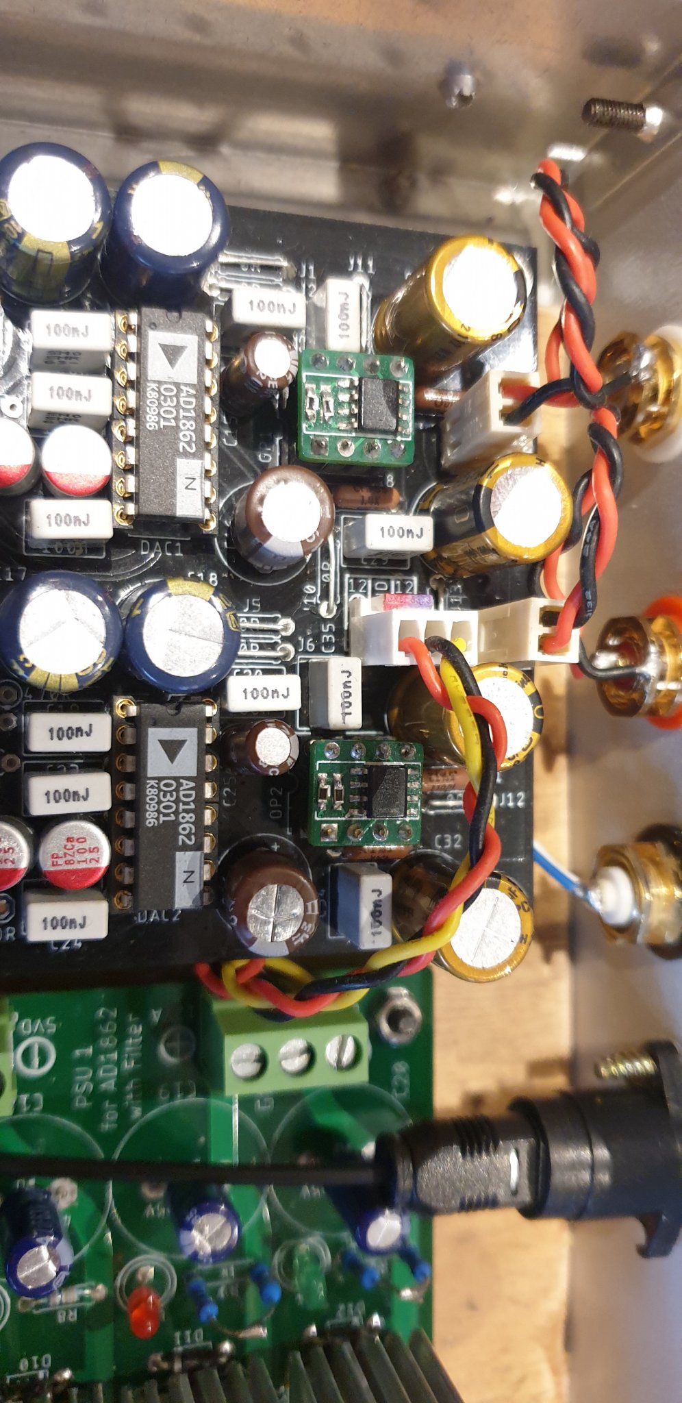

@Ryssen - my apologies, yes, you are correct. I found it easier to take it from the opamp socket and not take it from the AD1862, I think it was pin 11, but double check that!!Shouldnt the resistor be betwen 2 and 3 and take the signal off 2?

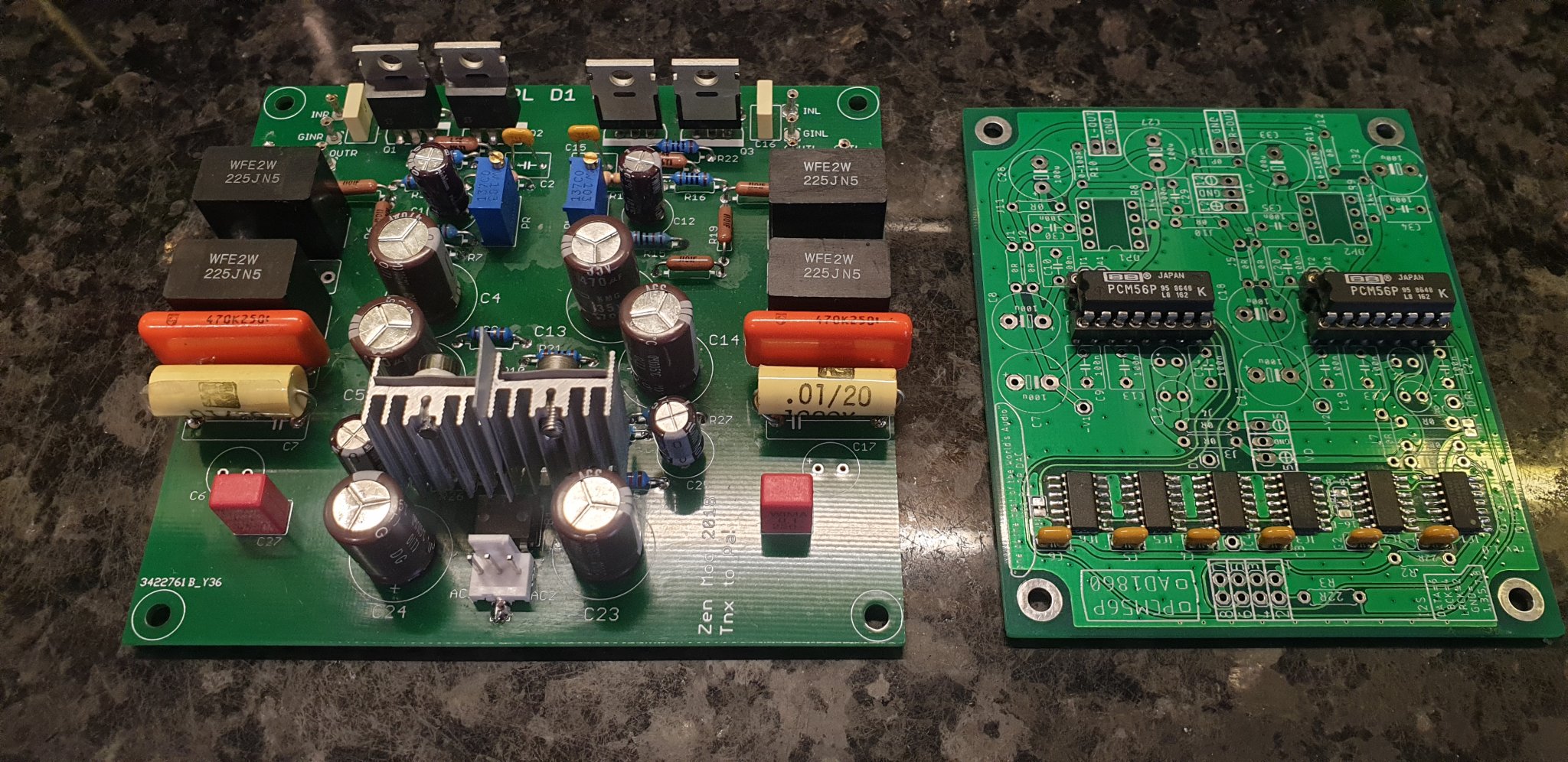

I've finally finished the D1 IV. Powered it up. As usual the 25v AC trafo runs a little hot with over 30v unloaded. But hopefully the regs will take it. Powered it up to check and I have zero DC offset....and I mean dead steady zero. I'd expect something so maybe I have an issue but I guess i need to connect the signals up and see.

I built your Tube Output Stage today and connected it to the AD1862. I'm happy to hear that I prefer the sound over the OP stage. The mid-range voice are especially attractive to me. Thank you.

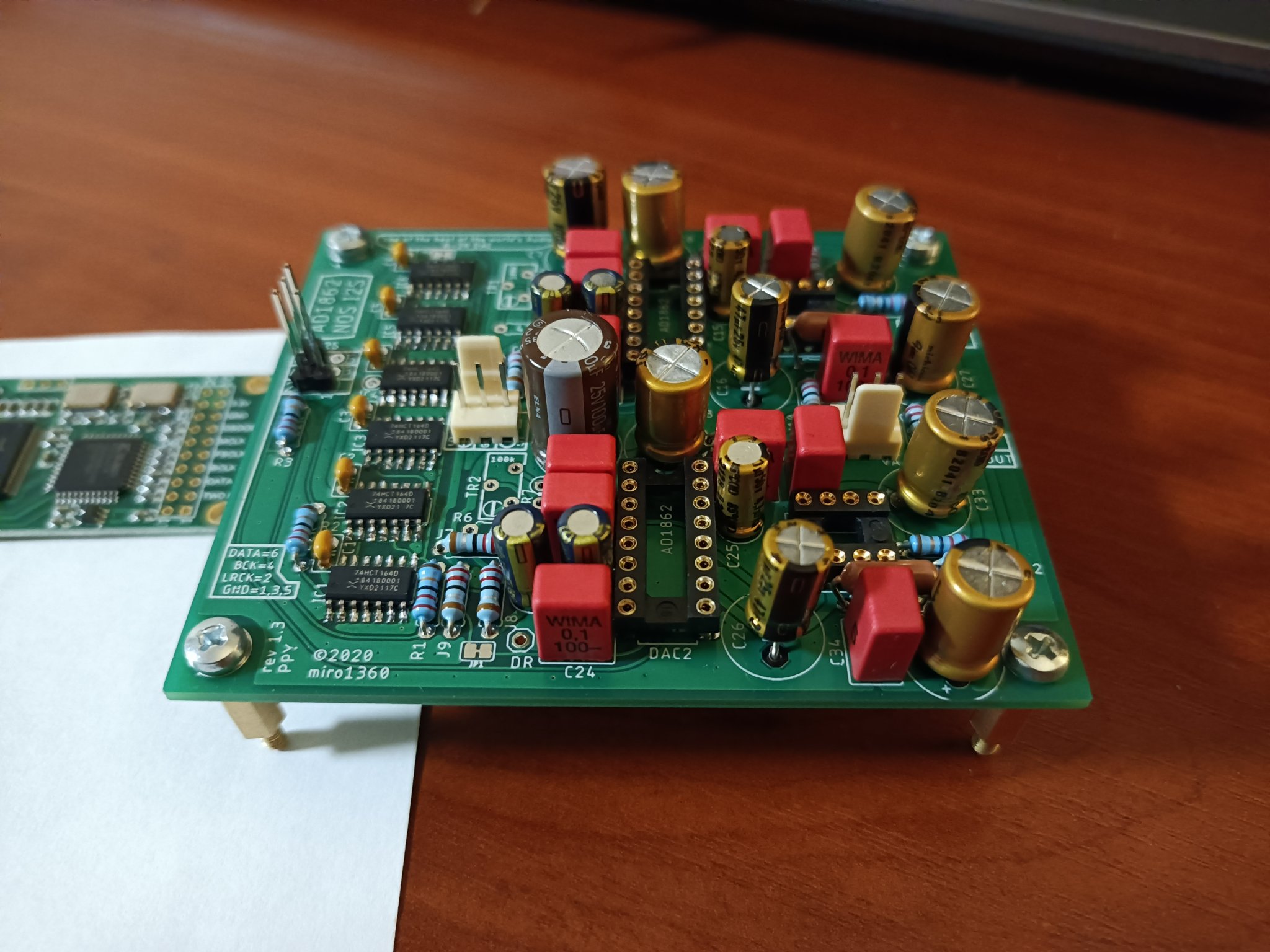

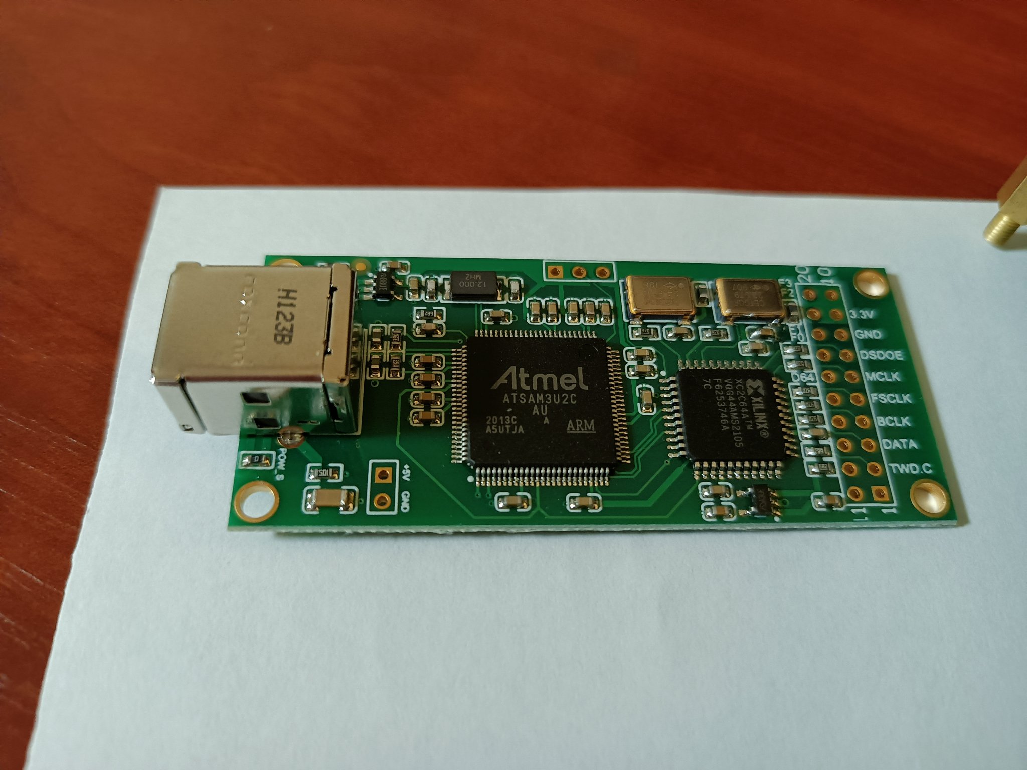

Hello, guys. I finished soldering the Dac. He looks very pretty! Now I have everything except PSU. I also solder a I2S pins (1,2,4,6) - is it correct? Also I buyed Amanero as transport. The connection between them is BCK-BCLK, LRCK-FSCLK, DATA-DATA, GND-GND - right?

Yes the wirering is correct. Distance should not exceed around 10 cm and the shorter the better.

Today I got the D1 IV in on my 1862. Bit of a fiddle. It is kind of 'botched ' in there to test....aren't they all!
Well initial thoughts were good but maybe that is just my bias...I am always happy when things I've built even work, never mind sound good!
But yes it does sound very nice. Using the schematic as is, not altered the IV R for 1862 1mA. Plenty of output. Maybe sounds a little heavier in the LF than Patrick's IV. If this is to my liking or not remains to be seen...but initially I am liking it. I dont have the greatest repertoire to describe audible things.!

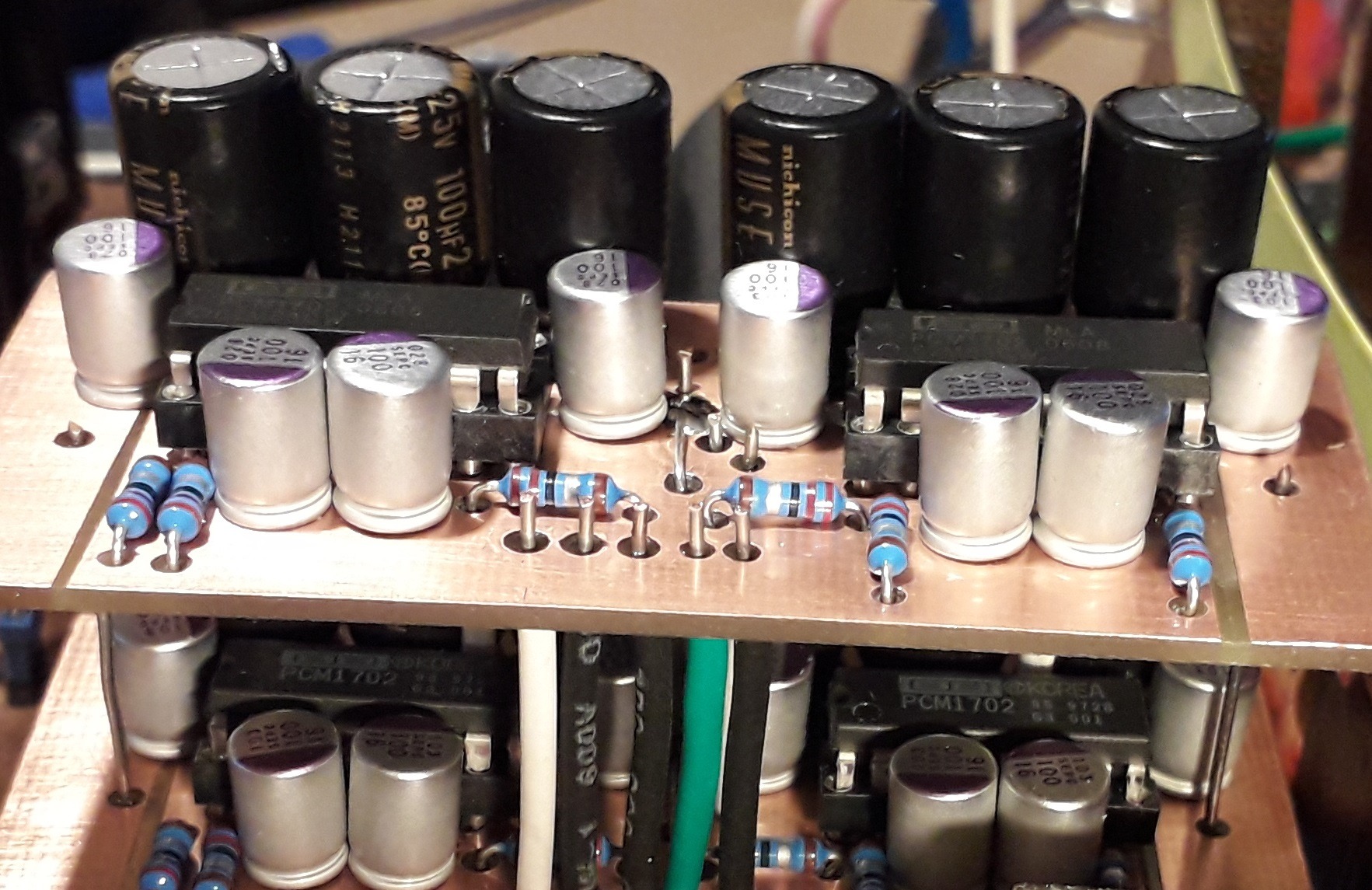

Although not related to this topic, but now I have seen these Nichicons for decoupling around AD1862. Yesterday my friend replaced them with OS-CON but around TDA1541, he listened to my advice and says the sound is much better now, more precise, cleaner, firmer bass, he is very satisfied. The regulators he uses are Salas shunts for +/- 5V and -15V.Hello, guys. I finished soldering the Dac. He looks very pretty! Now I have everything except PSU. I also solder a I2S pins (1,2,4,6) - is it correct? Also I buyed Amanero as transport. The connection between them is BCK-BCLK, LRCK-FSCLK, DATA-DATA, GND-GND - right?

Os cons definitely have their place. Digital is where I keep them but I am no expert.! Sorry for poor photo.

OS CON were blue or violett plastic surrounding polymers from Panasonic. The actual are polymere aluminium cans: SEP, SEPC, SEPF etc. They kept the violett tough above the aluminium can...
They do not give the same result , dielectric has changed. The SEP is more advised than the others that are not easy to use, especially the SEPC...that often give not good results due to its lowish ESR and perhaps a difference inthe dielectric maybe.
The FP red serie above is a Nichicon iirc. But if it were me for 100 uF I would have chosen the United Chemicon 100 uF of the APSA serie...that are way better than the previous last time I benchmarked them as some others polymer brands. Though no needs to desolder the ones you populated.
