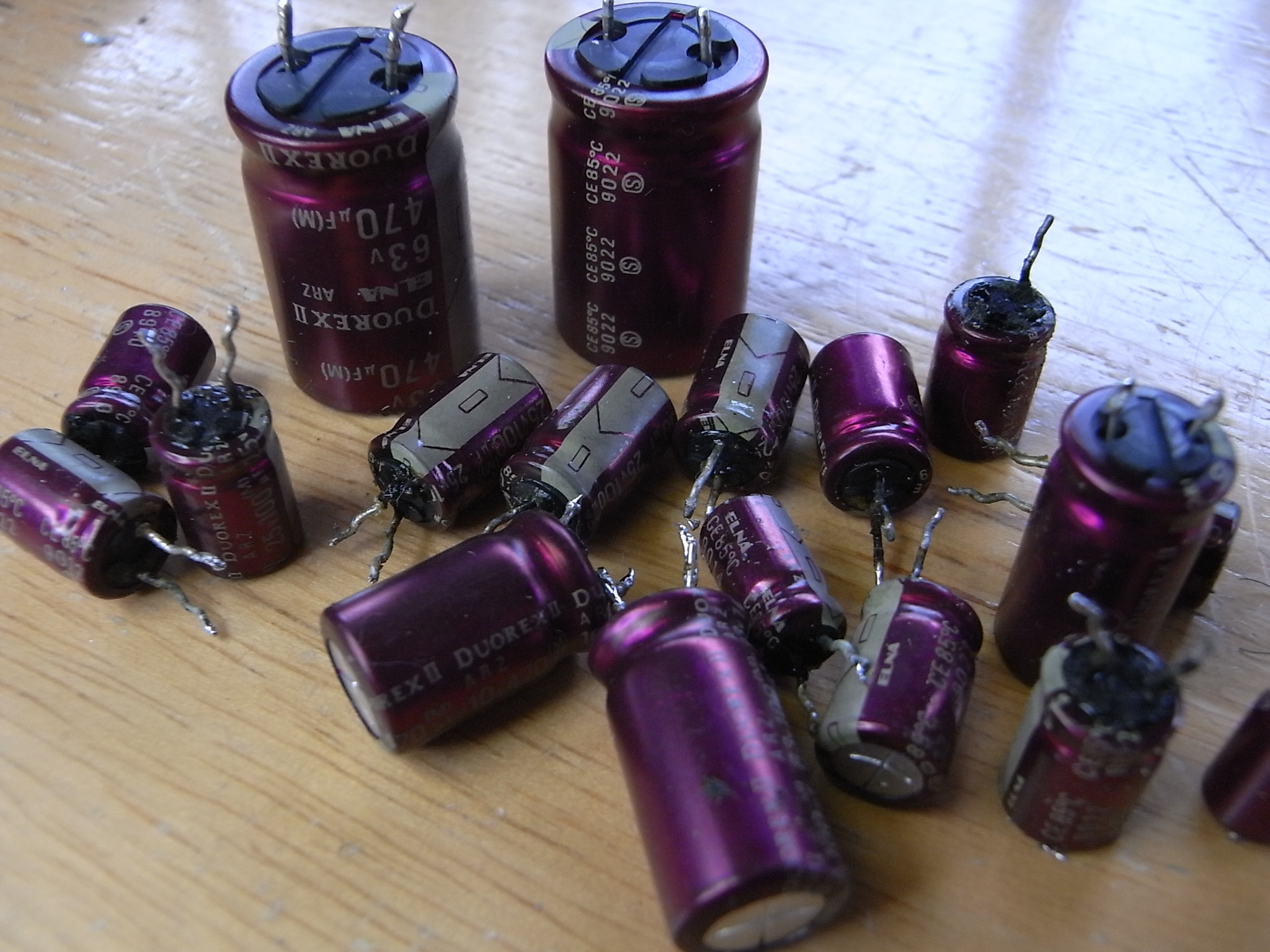

Just to underline what jean-paul and others have said about 20 year old electrolytics, pictures of blown/leaking Elna Duorex capacitors from a repaired Sony x33es CD player. The player was cheap on eBay so I couldn't resist
. I didn't expect it to work but surprisingly, perfect audio via optical output but only distorted, low volume sound from one analogue channel. The capacitors had failed and the electrolyte leaked onto the PCB underside, dissolving several tracks. After a complete capacitor replacement and some delicate PCB surgery, all good and the Sony lives to fight another day
