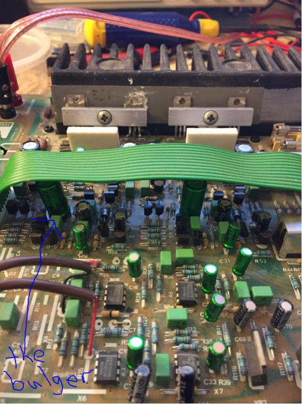

I'm looking for a little guidance. My friend gave me his beloved Cyrus One to try and fix - the audio was fading in and out on the right channel, as well as crackling on volume changes.
I opened it up and could see that the power FET's for the right channel have been previously replaced. I tried to clean out the volume pot with contact cleaner and air. Noticed C44 was bulgy, couldn't see any others, but decided to replace (hopefully) everything in the audio stage with Nichicon MUSE ES series.
The caps finally arrived, and I finished replacing them today. Listening to it now, the audio no longer fades completely out on the right channel, so I think that was the bulgy cap. And the volume/power seems equal in both channels. The sound still crackles in the right channel, but only when the volume is adjusted.

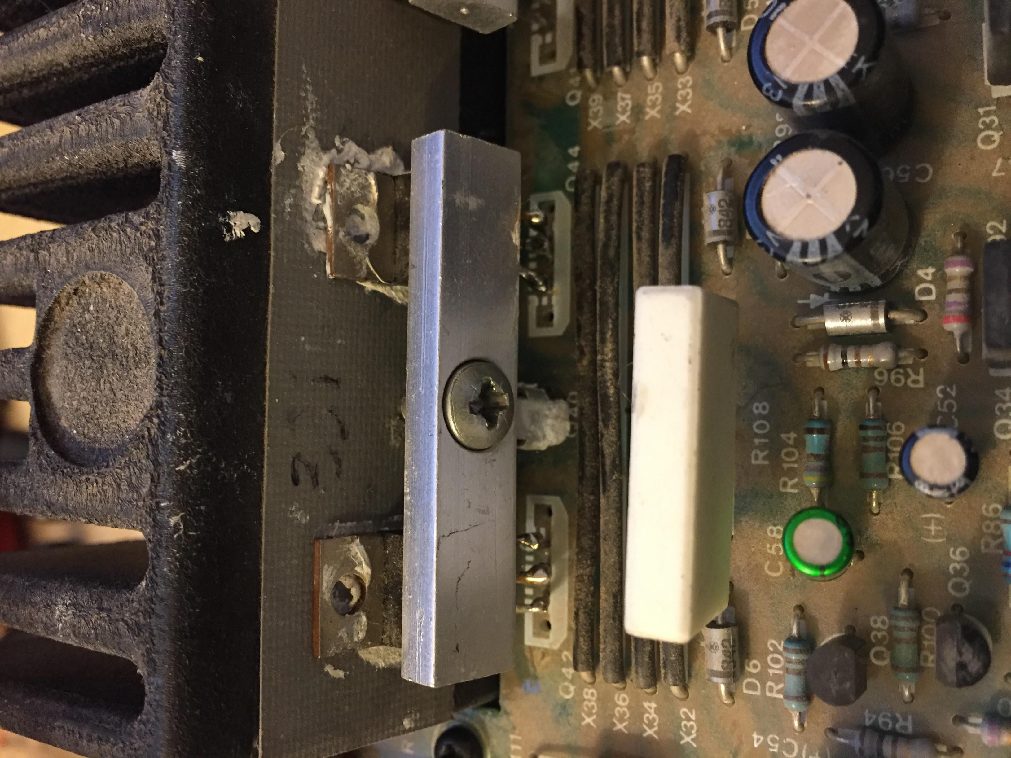

I'm thinking, because it's only when the volume pot is adjusted, that it's just the pot. But it's hard not to rule out the replaced FET (Q40), because, well, it's not the hottest soldering job. And to be honest I don't know the theory well enough to understand if a transistor or FET could add crackles.

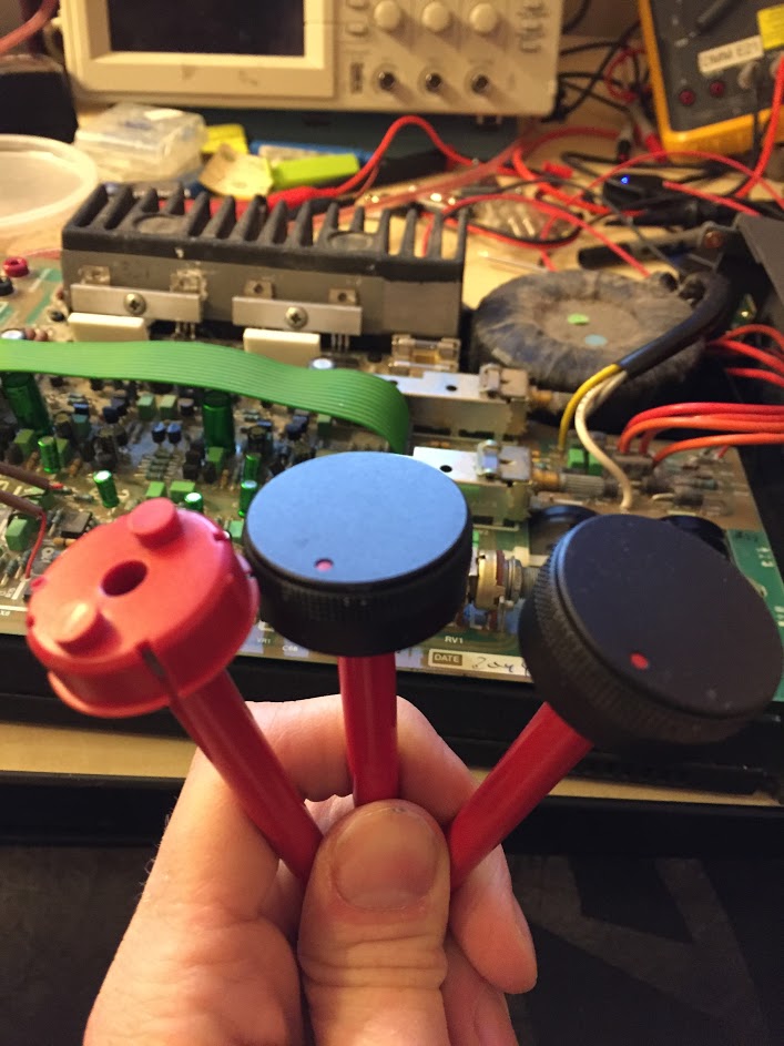

Does anyone know where I might be able to find a volume knob? Perhaps someone has a broken unit in the parts graveyard?
