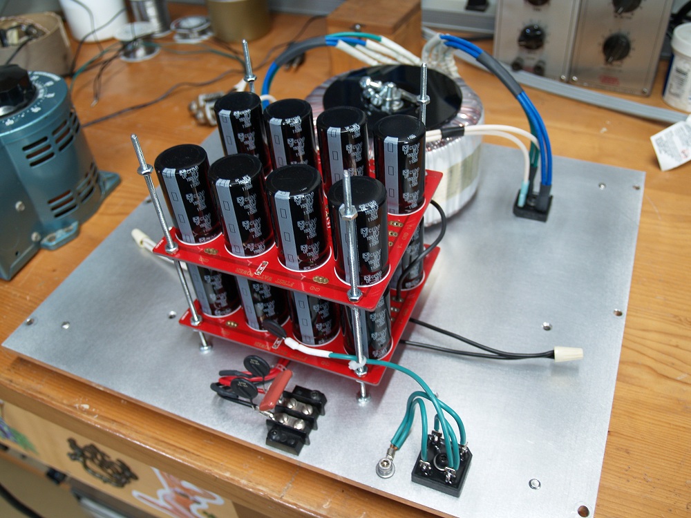

I built a standard F5 using these pcb's.It was configured with a single power supply using a cvillers p/s board with 8x33,000uf 40V caps; schottky diodes powered from a 500VA Toroidy.pl transformer with dual 18V secondaries.The heatsinks are the PS385 from these guys;over sized for an F5 but will come in for something else in the future;

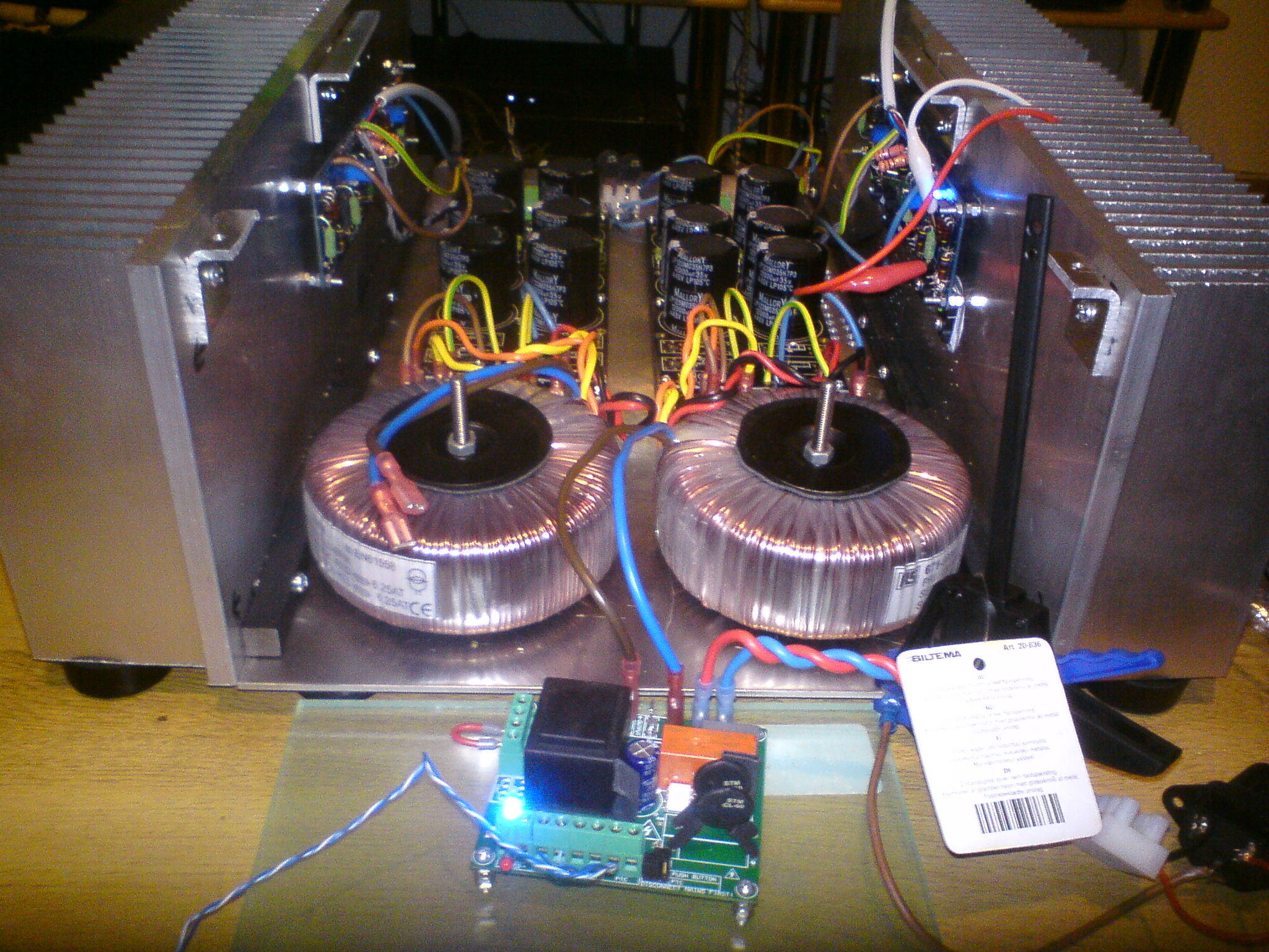

I used those boards, will take some pics today and post them. I first used the standard first watt zen style crc psu, and ended up with 180mV of ripple, so I am reworking the psu now with more c and im trying choke input.
I did not cascode, used a xfmr with 20v secs, ended up with 27.5 volt rails with the crc. the construction is pretty standard for F5, just more parts to match. also if you want a high bias, get big sinks like the ones in Audiosans pic. those look like usa's 10.08 profile, looks like he has two per channel.

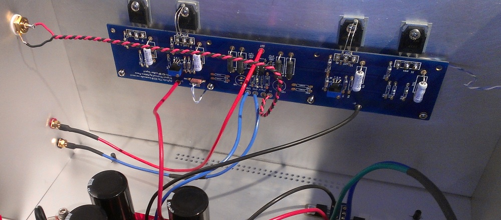

here are a couple of pics, first one channel, then the new power supply in progress
Nice clean wiring! I wish I could wire like that.
With two power supplies, did you consider using two sets of rectifiers since you have enough secondaries to supply them?

The channels are sharing the psu. At a glance it looks like two, it was a crc with 30uF/.1r/3uF per rail, with 27.5V rails and 180mV ripple in circuit on the F5c. Now it is 30uF/5mH/90uF clc. The rails from the first board are the inputs to the second. I don't have the chokes yet, so I don't know what the volt or ripple are.
The xfmr is AN-8420, 800va.

it's a little overkill. but also 2 pairs of output. +/-23V rails and 1.7A bias, so that it runs a little higher in class A at 6ohm.
