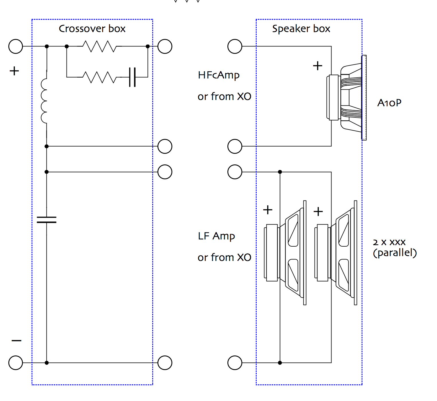

Has anybody used the a10p in both pensils and frugal horn? Or used it with a sub? I'm not really sure what to change. I've been happy with my pensils, but I'm borrowing a pair of Klipsch heresey and they are reminding me what bass should sound like.

Here is an alternative for augmenting the bass of the Alpair 10P: Halcyon
I have just delivered a set of A10PeN for a set of those. I have this document to add to the pot. A digram for wiring the speaker to remove the passive and try active. Key to the success of this speaker is how well the XO works i suspect. (note: the designer said that connection for bi-amp could not be done??)

Here (but with A10p) is a thot experiment on putting a WAW together that should play loud & low with lots of slam.
