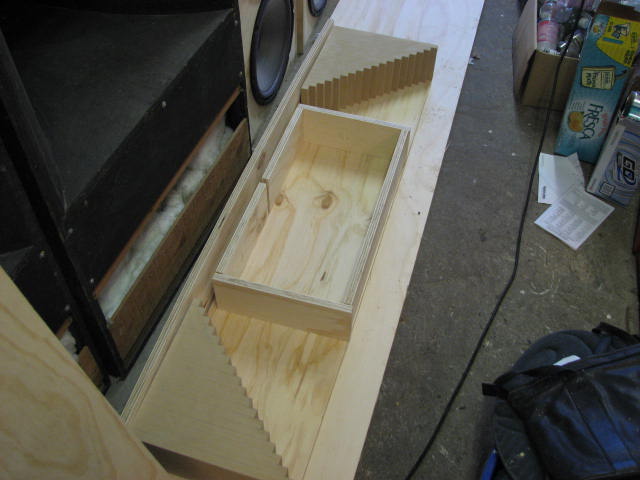

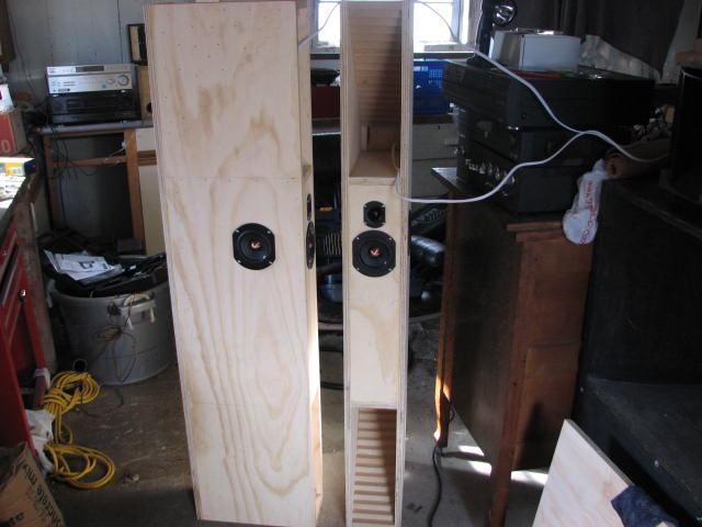

Cal, those look really great! Enjoy them. You can tell your friends how there is an elaborate maze of wood beneath the skin and that it is a difficult to build back horn of Japanese old world design.
Or you can tell them it is a modern BVR that is pretty easy to build.
I love the way those look.

They sound pretty good too...
