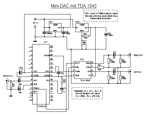

I built this mini dac http://www.jogis-roehrenbude.de/Leserbriefe/CD-Player-Projekt/CD.htm
But I change the spdif reciver with the CS8414.
I read many times, this is compatible with mini dac.
I've change the filter 470ohm 0.068uF (CS8412=1K 0.047uF).
When I push play no sound....
At this moment I' haven't a scope but I check the tension.
Pin 28 4.6v (I must be zero when lock spdif)
Pin 26 1.3v
Pin 11 4.6v
Pin 7,22,24 5v
Pin 14,8,21,17,18,23 GND
Any idea?

I solve the problem!
The digital out on the back of cdrom unit, is spdif in ttl format.
I remove R1 (75omh) in input interface, R1 in needed only with coax cable (cdplayer).

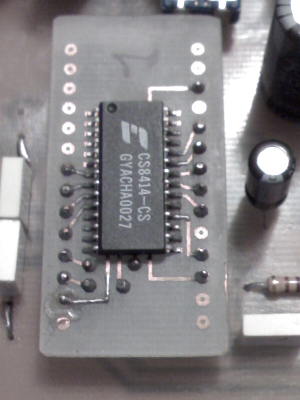

But I've an another problem....I bought 3 CS8414 on futurlec.
Only one works, possible other 2 have failure.
In the attach file not work.

That code is the manufacturer code and should tell you where it was packaged and when. If you go the Crystal website it may tell you how to read those codes.
It really does look like some pins are not soldered properly on both of those adaptors and I would address that issue first.
Actually putting spdif receiver chips on carriers like that may not be a wonderful idea, and I bet there is no supply decoupling on that adaptor either, despite the obviously long trace lengths.
