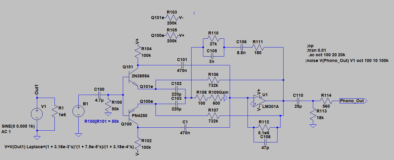

The two input transistors that Crown used, 2N3895A and PN4250A low Rb, the LM301A opamp is truly ancient. I hadn't seen this type of phono-pre, but only started seriously dabbling in phono pre and RIAA comp networks in the past decade or so!

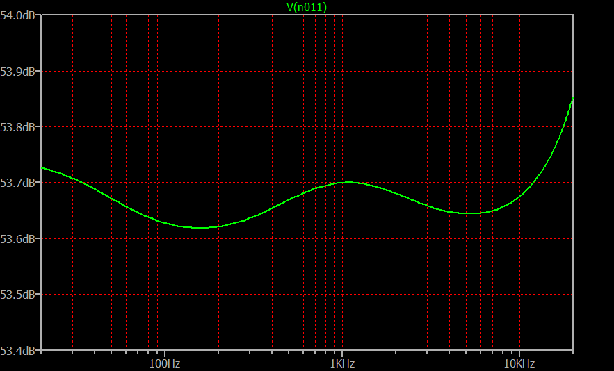

SY isn't around to throw bricks at this Crown design. The compliance, in simulation, to the RIAA curve is very good. Will have to see if my actual living model is equal to the simulations.

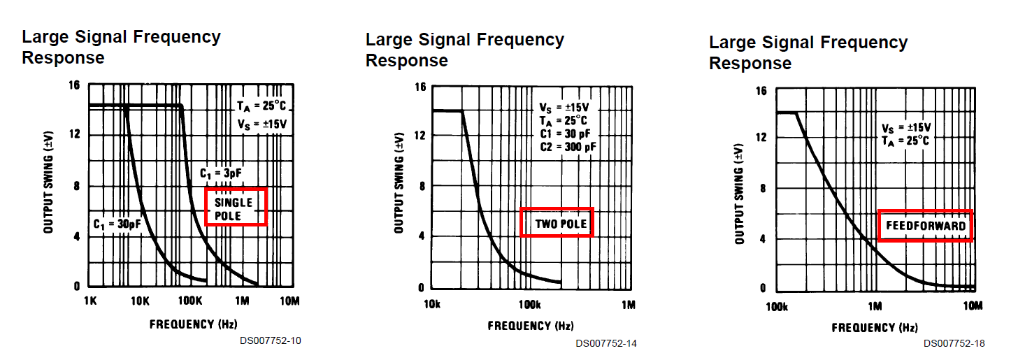

It's a bit disappointing that Crown did not exploit one of the LM101 (milspec) / LM301 (commecrial grade) opamp's greatest features: EXTERNAL COMPENSATION. It gave board level circuit designers tons of flexibility. Application brief LB-4 discusses a few possibilities, and the datasheet discusses a few more.

I fit the model into LTSpice without the compensation pins...there is 100pF from the inverting input to pin 1, and 1nF between output and pin 8.
Multisim has the complete model but I simplified for the purpose of using LTSpice.

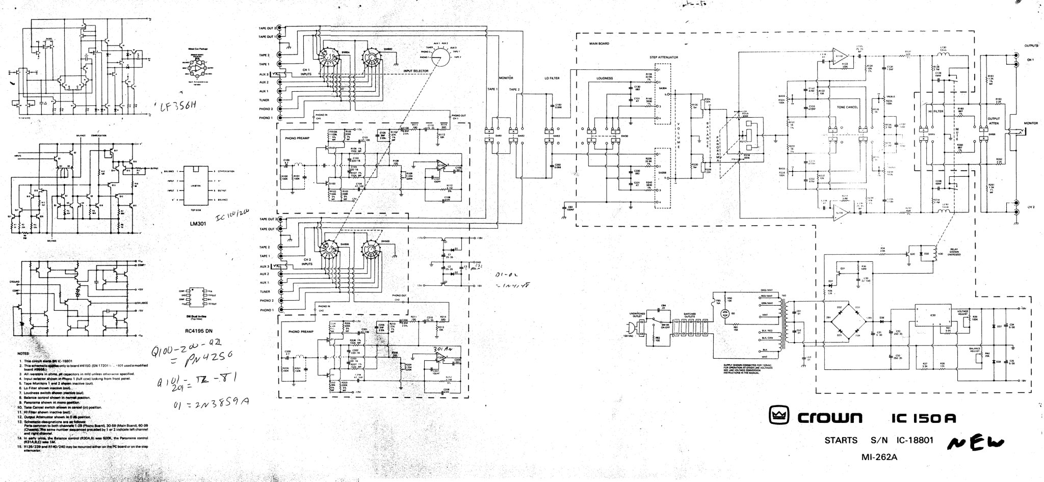

I believe you got the schematic wrong. The 732K resistors connect to the emitters. I loved the 2N4250 transistor when it first came out. It was probably the best cheap low noise transistor available. It would run with microampere collector currents and still had good beta. Many transistors had severe beta loss at low currents.

I agree. The 732K provide DC feedback to the emitters.I believe you got the schematic wrong. The 732K resistors connect to the emitters. I loved the 2N4250 transistor when it first came out. It was probably the best cheap low noise transistor available. It would run with microampere collector currents and still had good beta. Many transistors had severe beta loss at low currents.
While we are nit-picking, the input transistors are the plastic PN4250 and TZ-81 not 2N3859A. The TZ-81 was by Sprague. I don't know where you would find a model for it. Probably use any decent low noise NPN.
Good to see that the collector bias currents are reasonably close to the noise optimum, not decades too high. Are the supplies +/- 15 V?
The manual states/shows both TZ-81 and 2N3859AWhile we are nit-picking, the input transistors are the plastic PN4250 and TZ-81 not 2N3859A. The TZ-81 was by Sprague. I don't know where you would find a model for it. Probably use any decent low noise NPN.

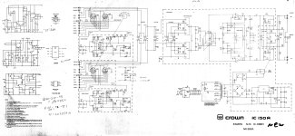

The Crown IC-150A schematic is still available here.
https://www.crownaudio.com/en-US/product_documents/ic-150a-owners-manual-ic-150aownersmanual-pdf
@rayfutrell -- tnx, my manual does not have the service bulletins. (I bought the unit with a DC300 a long time ago.)

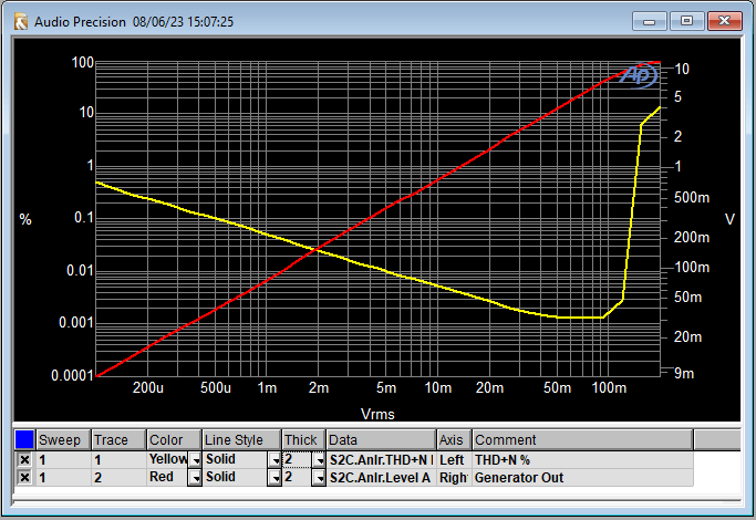

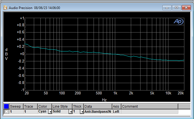

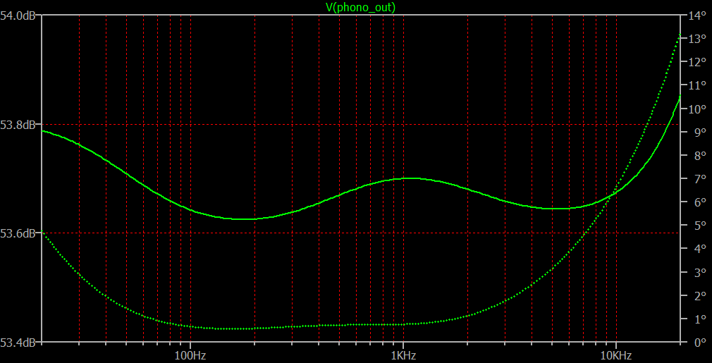

post#15 attachment 1 seems to show RIAA conformance is ±0.1dB and I think that's extremely good. Congratulations!
Which is still damn good for the 1970's! That's better than plus-or-minus 2.5% in an era when 1% resistors were expensive and 5% capacitors were unavailable at any price.
To me, it appears that yellow crosses above 1% at the halfway point (on log axes!) between 100mV and 200mV.
antilog( (log10(0.1) + log10(0.2)) / 2 ) = 0.141 = 141mV.
