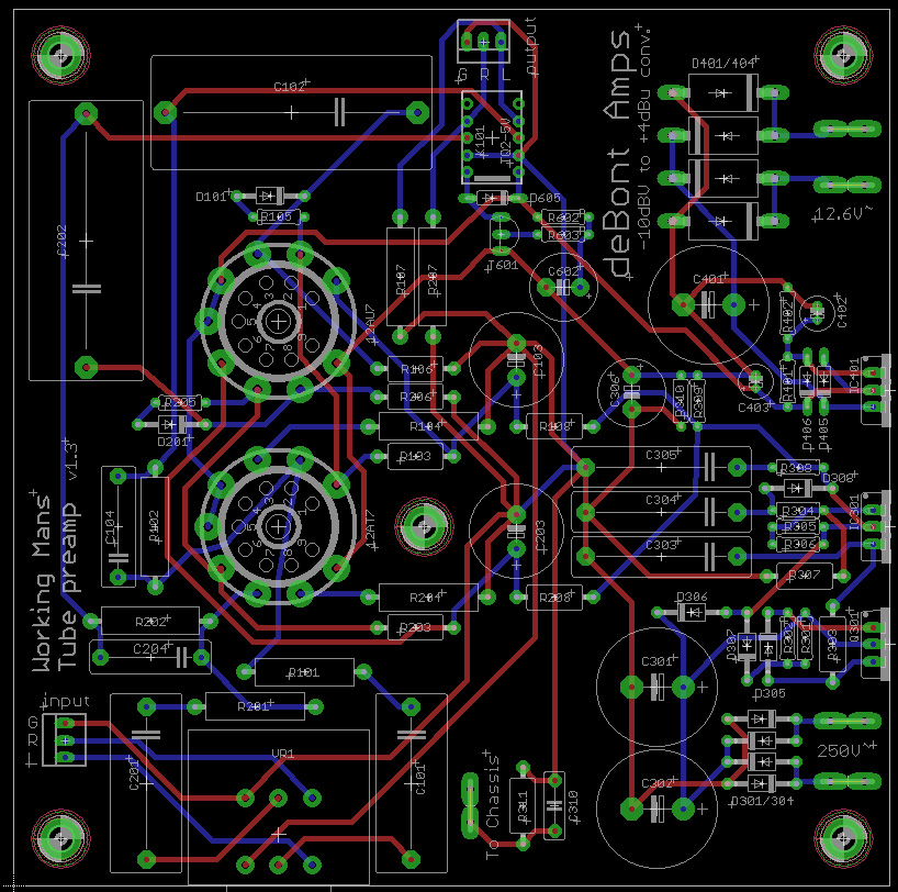

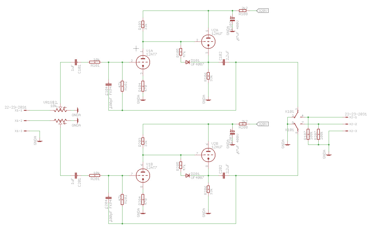

As requested, the scheme. The PSU is a Maida type, with regulated DC heater supply.
Why use two valves for one channel, inviting HF cross-talk? Use one valve per channel. That will avoid any cross-talk, what you could possibly get with about 3pF between the Anodes below 10MHZ I don't know. R101 and R201 should be, as grid stoppers, physically on the grids not before R102, 202! There is no advantage with DC heaters. Not enough gain to worry about if you have a faulty valve with Heater Cathode leaks.

Good stuff, thanks! The 12at7 into 12au7 just came to be. No specific reason, just experimenting. I'll keep the advice in mind. Concerning R101/102, R101 is also used to isolate the feedback path from the input, not (just) as a gripstopper, but good idea to add an additional grid stopper.Why use two valves for one channel, inviting HF cross-talk? Use one valve per channel. That will avoid any cross-talk, what you could possibly get with about 3pF between the Anodes below 10MHZ I don't know. R101 and R201 should be, as grid stoppers, physically on the grids not before R102, 202! There is no advantage with DC heaters. Not enough gain to worry about if you have a faulty valve with Heater Cathode leaks.

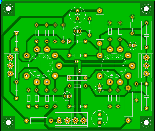

I fail to see how a ground plane will reduce crosstalk. I tend to steer away from groundplains, since they make it very difficult to control where currents flowIt seems that your pcb does not have any common ground layer. I think that is the main reason for cross talk.
Anyhow, the problem is caused by the layout reasons, not by ciruit it self.
Below is an example of how the ground layer should be implemented.
I'll have a read, thanks!The cross talk between the two triodes in a twin-triode valve is quite significant. There was an interesting thread about that here:
http://www.diyaudio.com/forums/tubes-valves/260477-crosstalk-between-triodes-dual-triode-tubes.html
...I fail to see how a ground plane will reduce crosstalk. I tend to steer away from groundplains, since they make it very difficult to control where currents flow...
A tube amplifier built on the pcb is not critical for ground loops like it is when typical point-to-point is used.
Therefore one side of the pcb can be fully (or almost) used as a ground plane without any hum or such problems.
But the pcb should be connected to metal chassis at one point only.
The attaching screws or posts of the pcb should be isolated from the ground plane of the pcb.
