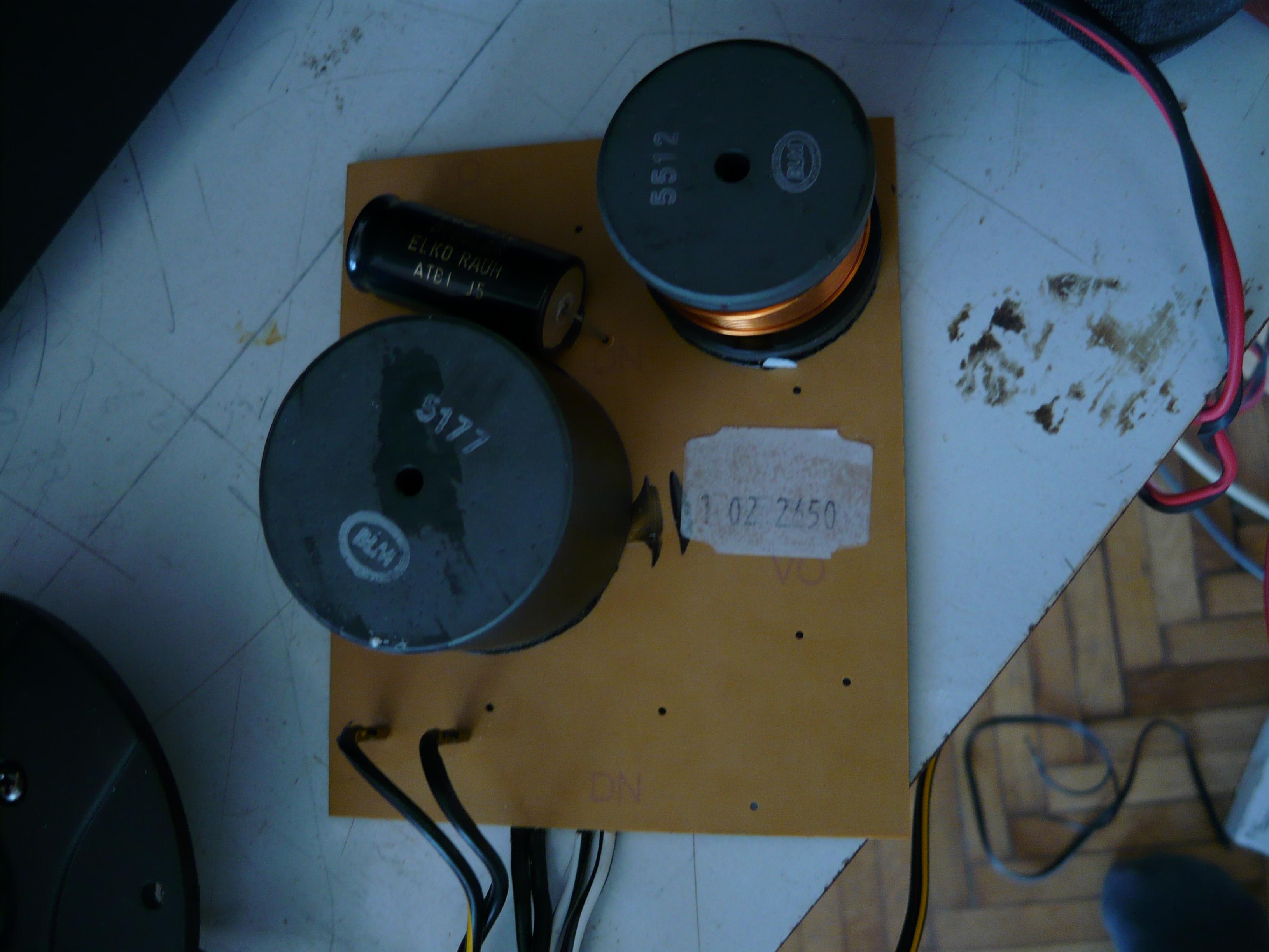

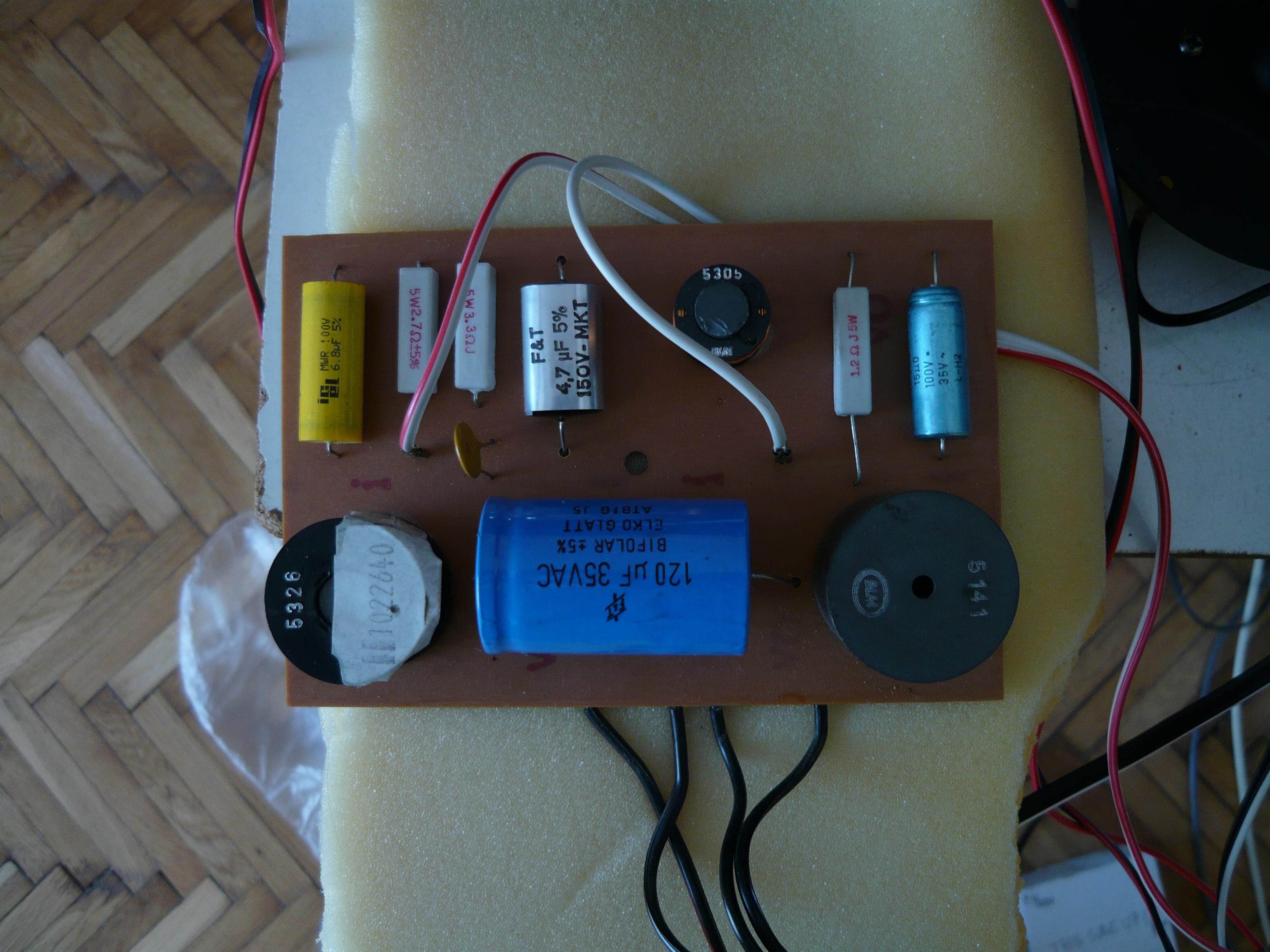

I am having a pair of Heco Ascada 770 loudspeaker crossovers that I want to have wired to the following as state components: 2 basses, 2 mids, 2 tweeters. The crossovers are 4 ohm and each driver is 8 ohm! How can I have the drivers wired to the crossovers?
Here are the pics of them! first are the bandpass and highpass and seccond are the lowpass! Thank you!

Hard to say what is going on there without analysing it, but that looks like a simple enough bass filter with two coils and one capacitor.
The midpass will be the complicated bit with the big componets. The high pass tweeter filter will be simple enough. Phase is going to be hard to guess, since it depends on the filter and the depth of the drivers. Also hard to guess whether that is a 4 or 8 ohm crossover.

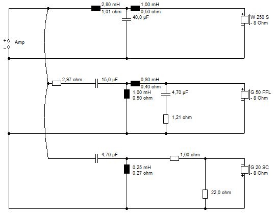

HW 3/130 NG - 8 Ohm
oszkar, if you can't figure all this out yourself, you shouldn't be doing it. I've already suggested some simpler two-way circuits that might work. If your bass circuit crosses over at 150Hz it's gonna fry the little cone midrange quickly.
But you haven't listened to a thing the forum has been telling you. You can't just throw random bits together like this. :eek:
