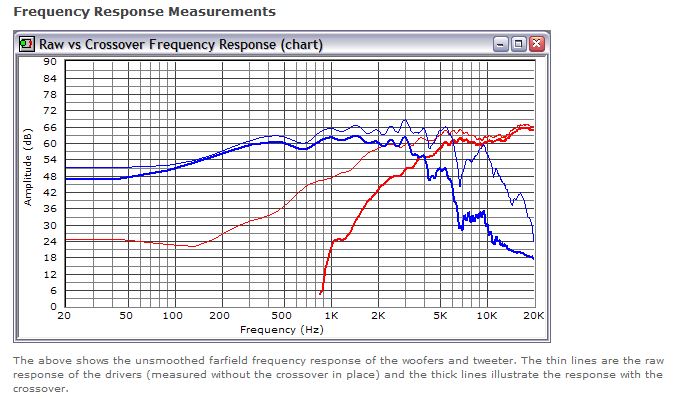

The RTL TDL2 and TDL3 are good classic aperiodic designs that was well executed. The second order crossover should work well. The only thing that I can think off is to re-cap with good quality film capacitors. It is not necessary nor advisable to touch the other components.
The TDL3 has 2 woofers wired in parallel so that its low pass section is different from that of the TDL2. The tweeter padding resistors will be different too.
Since the Wilmslow Audio TL3 kit has the MTM configuration of the TDL3, it is not directly applicable to TDL2. And the driver parameters are different too.
There is an old post that should be helpful to you: http://www.diyaudio.com/forums/multi-way/107268-tdl-rtl2-upgrades.html

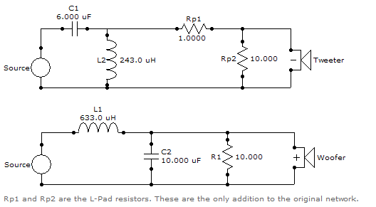

The reason the TDL crossover designs get hot is they have a shunt resistor across the 6" paper woofers:
TDL RTL Rebuild - Crossover and Measurements
As ever, without tracing a schematic you are wasting your time on "upgrades". Just piddling about with different quality components. 😀
Below is the MTM TDL RTL 3. The similar woofers are paralleled, so component values change by a factor of 2. Ropey old design, IMO. I wouldn't do it that way. All sorts of problems there. A 6kHz LCR bass notch would work much better, and even just some shunt resistance in series with the bass capacitor would work better than that hot resistor.

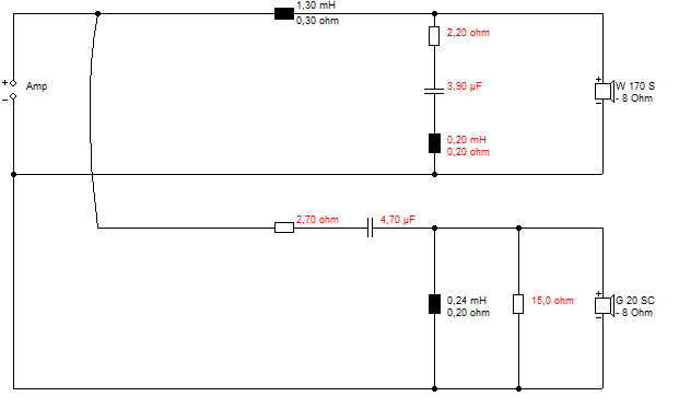

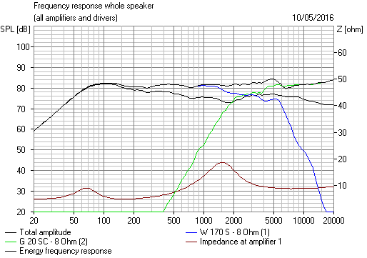

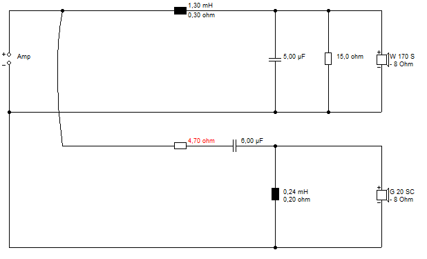

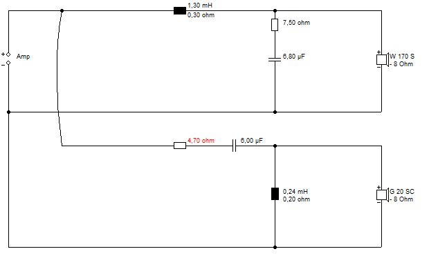

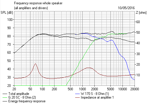

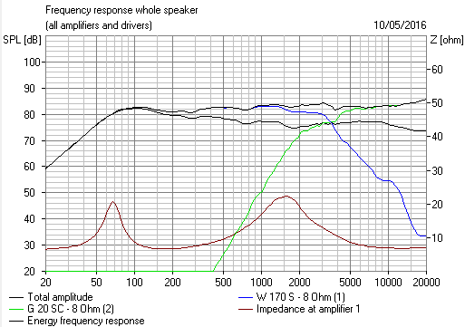

I made a guess as to what the TDL RTL2 crossover looks like.
I then redid it without the heat problems.
Lastly I redesigned the bass filter for the 6kHz notch on the 6" paper bass bass cone resonance, which cures a lot of problems. The tweeter filter can be fiddled with, but I went for a better amplifier load. The red resistor is select on test really. I don't know much about yours beyond it being a 94mm type like SEAS or Morel or Vifa.
One of my circuits last, to show how it is done. It's not hard. You get a better speaker. 😎

Buying appropriate capacitors is somewhat beneficial, but if you don't like what you hear, look elsewhere. Cabinet damping is more important, as is your configuration of drivers, the acoustic design of the speakers and the room, the crossover circuit itself and others.Already had a look at some cap and resistor upgrades - nearly died of shock looking at Audio Note copper foil signal caps!! Im going to defo dampen the cabs too so
Equating capacitor price with sound quality is a fraught excercise. Resistors are even less of an issue.
AllenB is dead right. Don't fret on component quality too much. I use 250V polypropylene caps and ferrite cores above 1mH. Neither is very expensive.
They work. You do want an aircore for the 0.2mH LCR, if you go that way. Resonant circuits amplify any non-linearities in my estimation.
AllenB is the great proponent of tuning by ear. It's not hard to adjust the input resistor to a tweeter circuit for level. 1 ohm is 1dB usually. 3dB is half power.
I'm pretty confident about that 6kHz notch. The resonance is at 5kHz. 😎
I use Boxsim for sims:
Downloads
The Visaton W170S 8 ohm ought to be close to what you have, but I'd measure the DC resistance (around 6 ohms) to be sure.
This Alto II would be a good start imported into Projekte folder. Then adjust it, and change the 4 ohm woofer.
