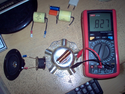

This is a 1mH ferrite. The value is reduced by a nearby metal plate, here an ashtray, and the inductance test tone at 1kHz from my meter feeds back to the tweeter for an audible whistle:
Thin metal doesn't seem to affect things much, and caps and resistors have no interaction at all. But I do point to point wiring and 90 degree placement just in case.
