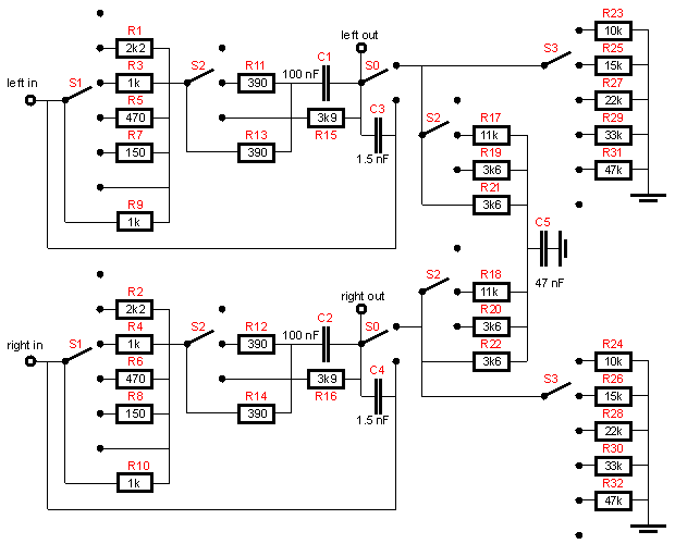

Dr Meier did that original post on Headwize way back when (the excerpts in your second link in post #2). Since then it looks like he formed Meier audio, a commerical company, if I have the history right. Here is his crossfeed page:
Meier Audio

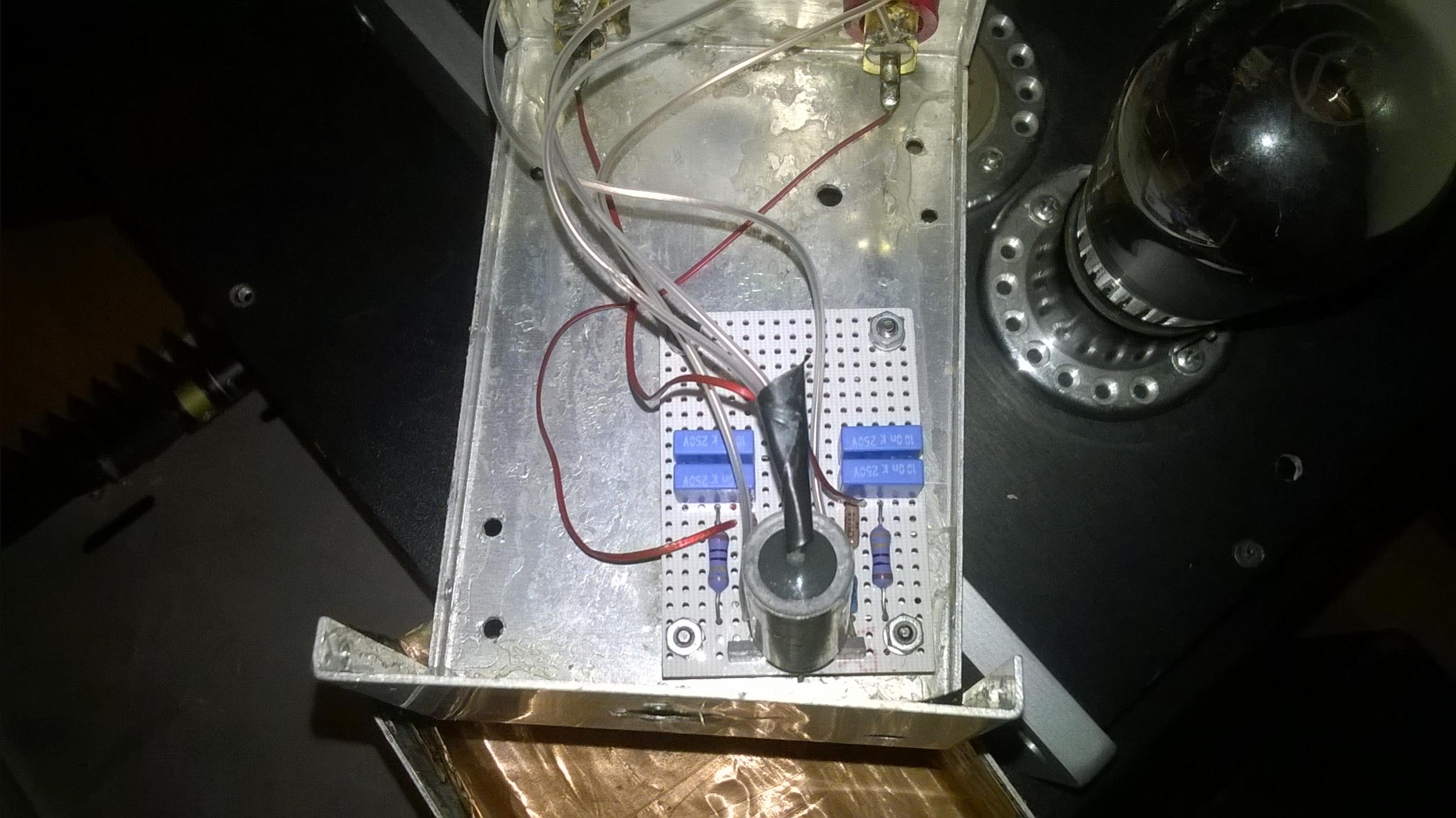

Started with this attached schematic.
I'm hearing better the headphones, the sound is more centered allowing to listen now more details before not listened for the stereo image.
I guess the schematic used is for medium crossfeed, time to experiment with more crossfed schematics.
