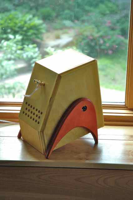

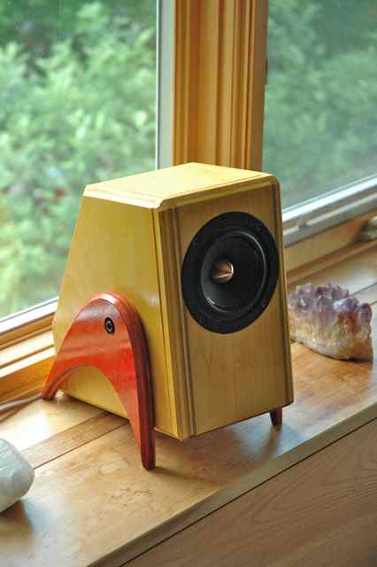

CSS FR125: I like it; needs careful design...
Hi -- I've used the FR125 in a number of applications. Upshot is that it's one of the driver's I'd recommend to someone looking to explore full-range. When they're in the right cab and set-up right, the full-range magic is definately there. Enough bass to not neccessarily require a sub, great midrange, and to many ears doesn't require a tweeter. Downside in my experience is that it's difficult to extract the full bass potential of the driver -- without sufficient damping it can hit it's excursion limits in ways that aren't pretty. Because of the bass potential of the driver it's tempting to push it to the limits... but in my experience I've found that aiming for best driver "control" yields the best results. In short, go for controlled, as opposed to lowest, bass. I've had best results with some sort of resistive loading, such as a foam-stuffed vent. Dave Dlugos et al/Planet 10's onken designs are good; here's my take on one of Planet 10's designs using a resistive vent; in next generation I would put the resistive vent in the base of the cab, which would facilitate optimizing the vent damping/tuning:
Best, John
Best, John

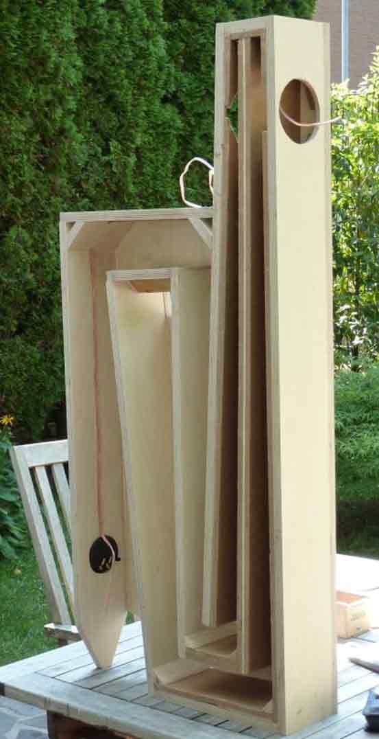

I don't really know, they are on planet10's site if you want to have a look at the plans and plots. They are called the Calhoun.Cal, what frequency have you tuned your boxs to?
I didn't seem to find that I had to be back from them but as always you have to place the speakers in the right part of the room and then sit in the right part to achieve the bass if there was no helper woofer. I am wondering if you were sitting in just the right spot to catch all the bass reflections gathered at one spot. That was kind of spooky when you are hearing that much bass from such small drivers.Hey Cal, how far back from those things do you sit?
Oh God...that's just too cute. Perfect for a computer setup in a cubicle!
PS: Cal's calhouns were a real revelation... the other end of the spectrum size wise but i'd recommend them too. When i heard them we were 3-4 m away. The side firing driver gave a whole array of room interaction possibilities and led the way to a huge range of single & double driver designs.
Yeah, I bounced mine off the back plate more than a few times on certain passages even at modest apartment levels in RS 40-1354 MLTLs, so while they didn't seem damaged, into the closet they went.
Another thread got me thinking about a tall skinny cab to maybe provide enough acoustic loading, so 'stretched' a sim of the MLTL to 58" and except for an unavoidable deep notch in the lower mids it looks viable. Only one way to know for sure though.

Digereedo, amazing litte cabs you have produced there.
very impressed.
