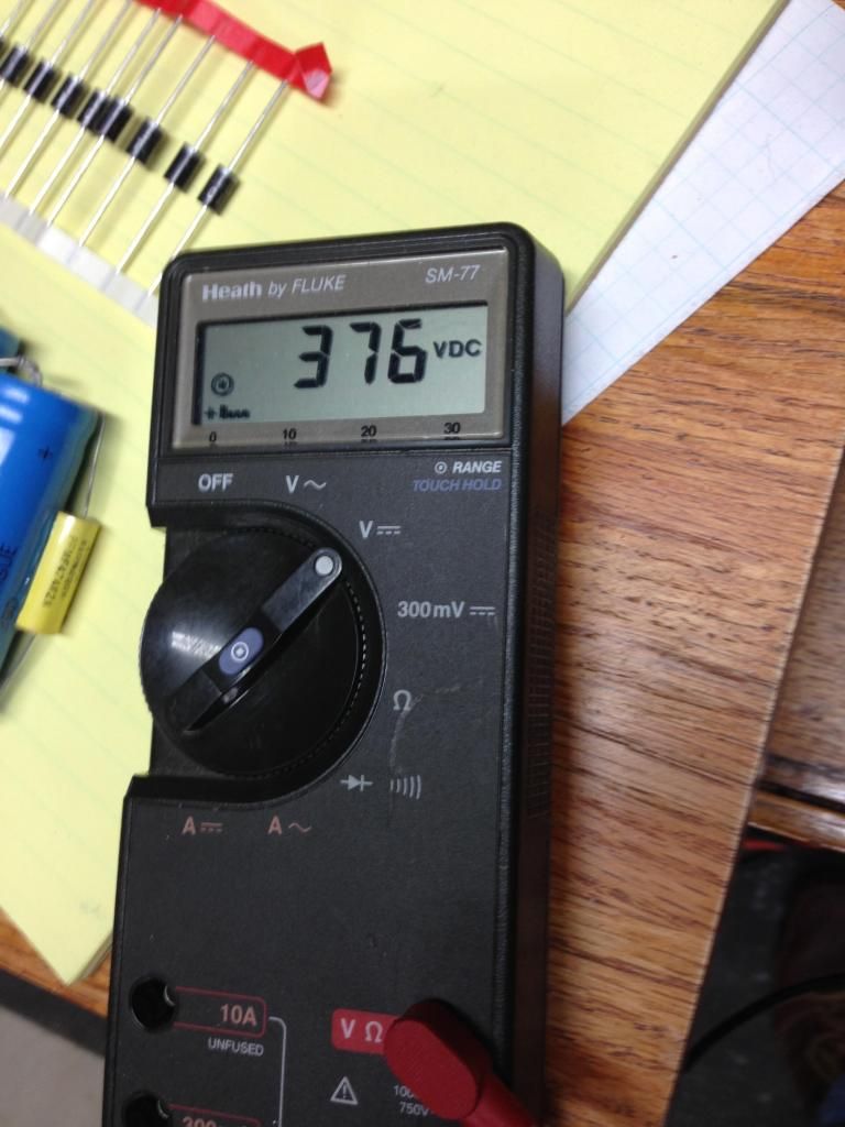

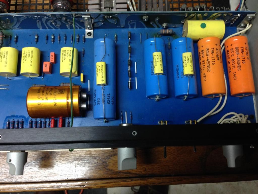

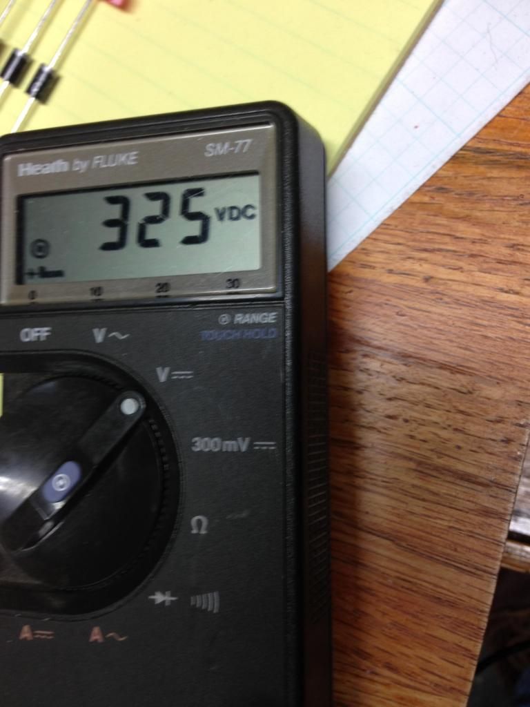

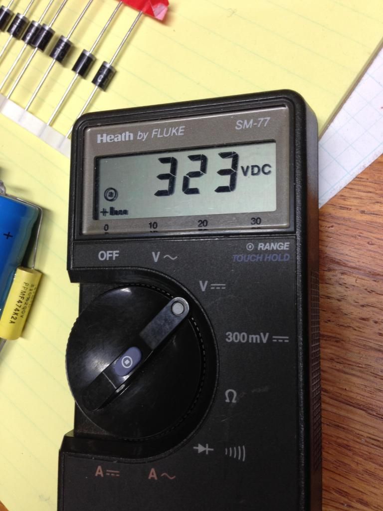

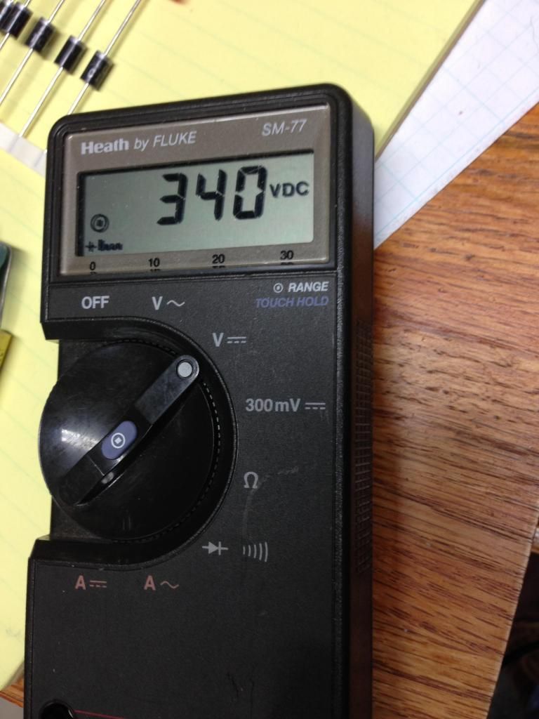

Now I can start my planned parts upgrade. Took some voltage measurements and was a little surprised by the numbers. What little schema I can find indicates I should see 428v at the first Cap , seeing over 490volts there, on a rated 450volt part. Wow! second cap was over voltage as well.

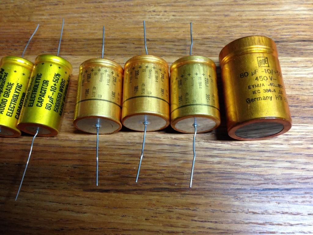

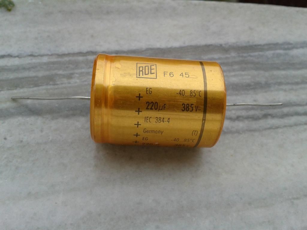

So the plan is to start with the supply caps, and diodes. I have two 80uf 500v Jensen caps, and 220uf 385v ROE gold bullet caps with the 300uf Sprague being replaced by a 220uf 385v ROE and and 100uf 450v ROE. Upgrades to the Diodes will replace with UF rated 5408 and 4007s. Plate resistors and being replaced by 5w Kiwames. Next on the list is ceramic gold plated tube bases. Last and most important are improved input and output jacks.

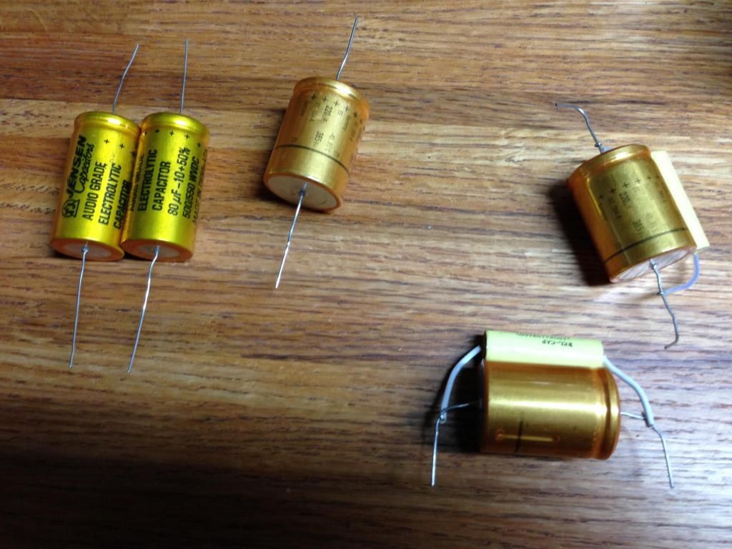

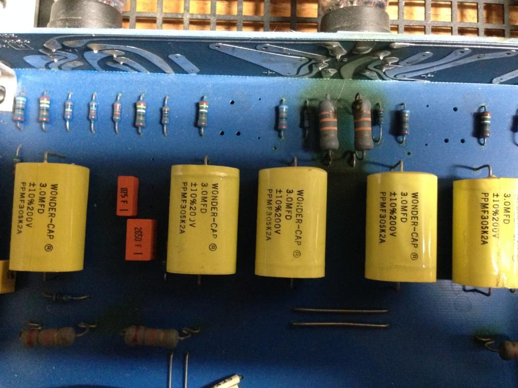

Need to also replace the 1N5400 diodes tonight as well. One of the diodes looks like it has deteriorated , and worries me. The first 80uf orange Sprague also shows some
corosion as well. All of the voltages measured last evening were either at or above the parts ratings. No wonder these have a reputation for unreliability. All of the replacement parts are rated at higher working voltages than the current parts.

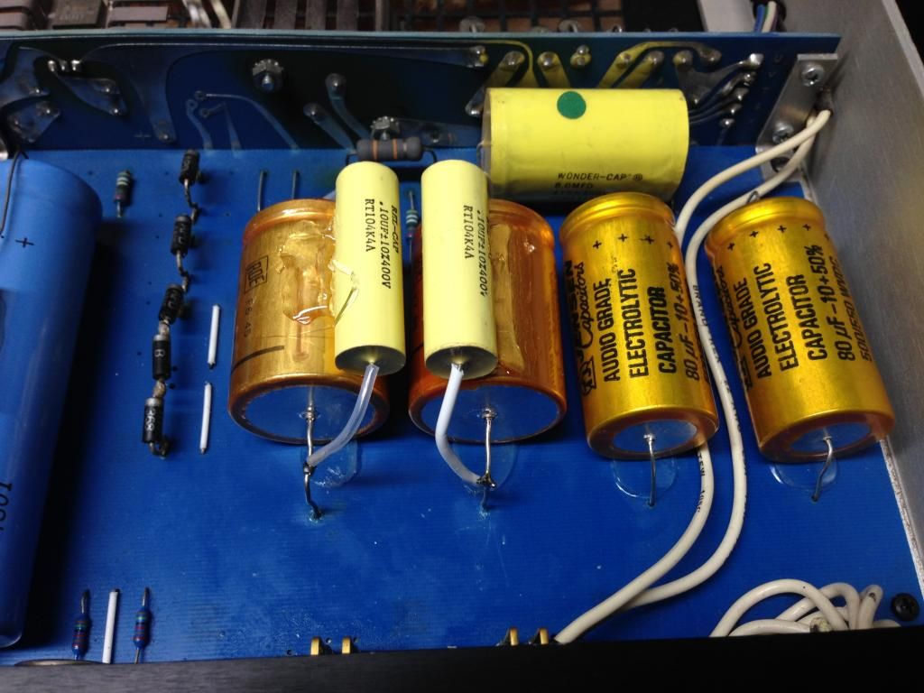

Tonight, I changed out the Sprague 300uF cap, Installed two ROE caps one the 220uF 385v and one the 80uF 450v. Finished the install and fired up the Preamp/system. Sounds better, but it seems obvious that there will be a long breakin period. Listening to Diana Krall's vocals it sounded a little honkie , So I decided to remove the rel-caps, and listen without any bypass caps. Much better! I can hear the sweetness of the tubes with much improved bass even through the tiny near field speakers I'm testing through.

Waiting for the Diodes and My replacement order from Michael Percy (with the Kiwames). Tomorrow, installing new ceramic tube bases, then on to Rhodium input and output jacks.
Got some resistors from M Percy yesterday, installed the 13k plate resistors for the line stage tube. Also while I was at it, installed the ceramic tube socket for the line stage tube. The amp sounds better each hour it plays. Voltages seem to be more stable, there seems to be less heat being generated.
