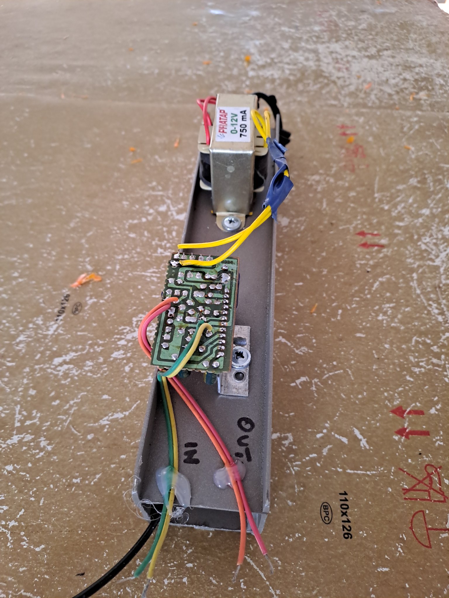

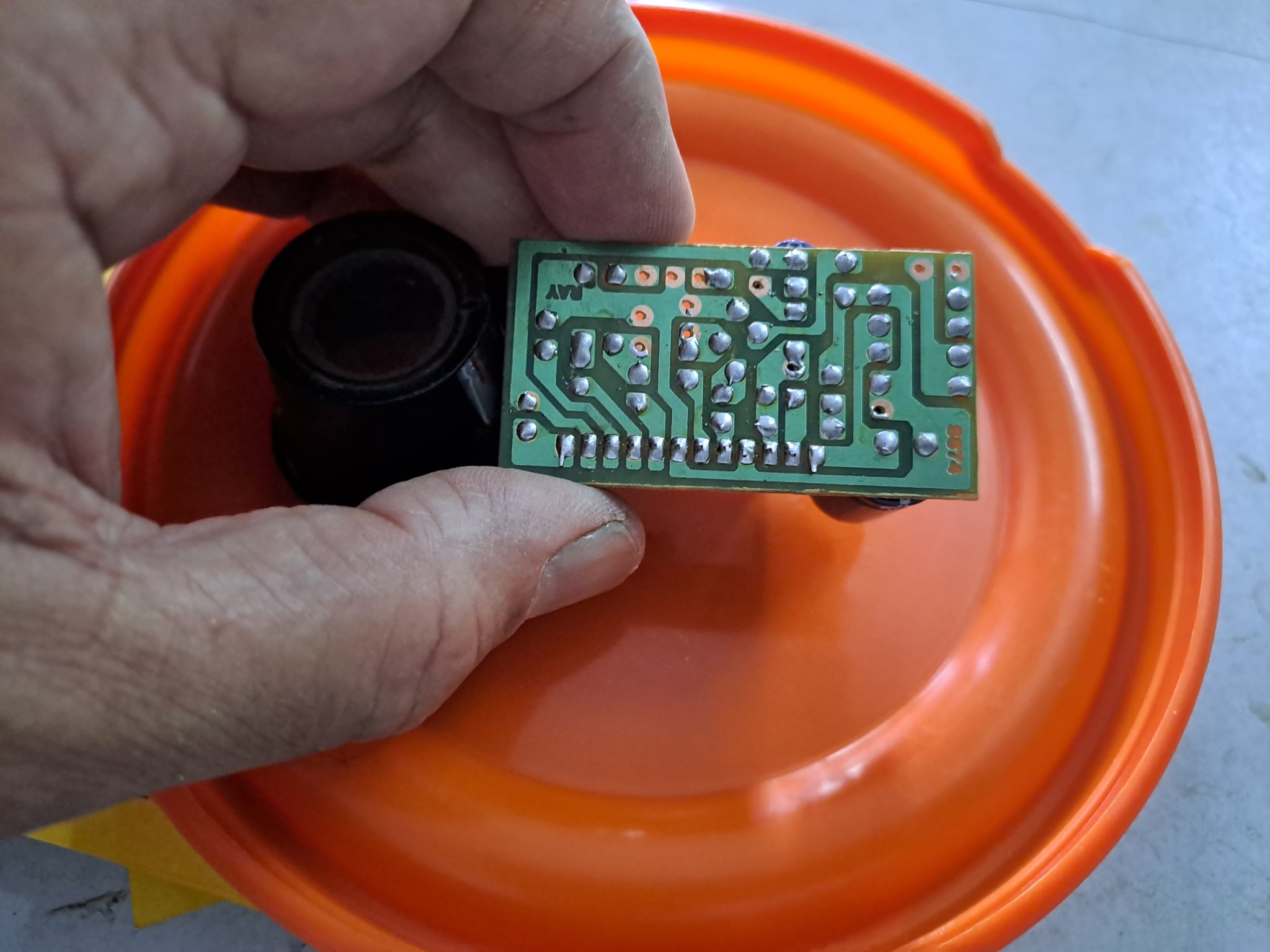

I assembled it on a piece of aluminum section
Too loud for use as a TV monitor, driving a single 4 inch speaker near the sofa.
Like above, I think it is about 2W per channel at 12V.
Very common in FM radios here, they use only one channel, as most have only one speaker.
Now I am going to add RCA inputs, a volume control, power indicator, and wire it for stereo.
A populated board with a single 2030 class chip is about $1.25 here, and the most expensive ones are about $ 60 here, as posted earlier in Post #11.
