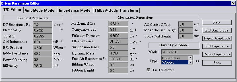

I'd check the modeling in the demo version of Basta! using Zaph's parameters :
Note that they will sound pretty thin without some form of BSC.
